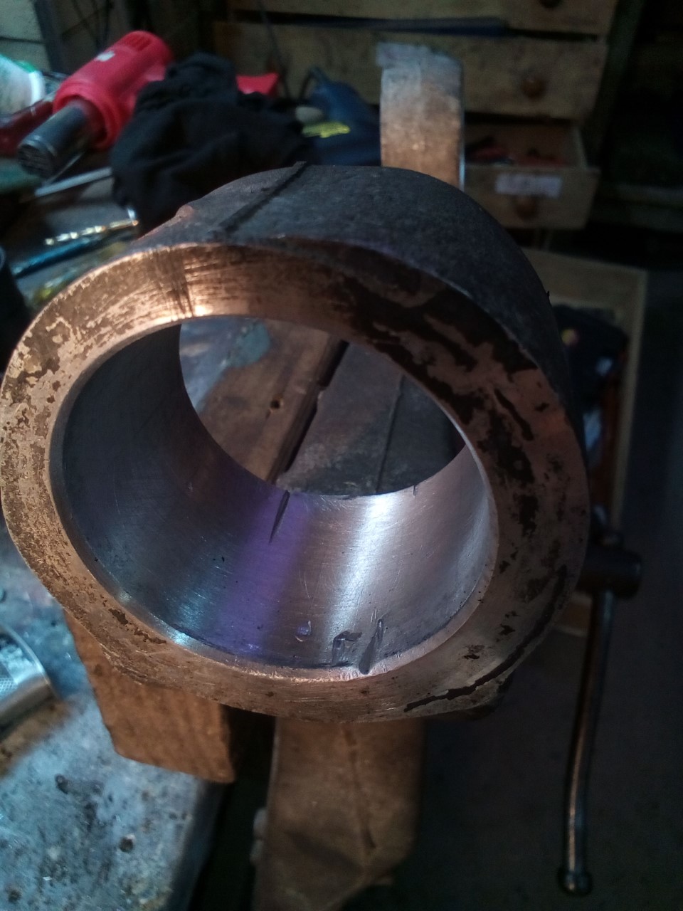

Lower Control Arm bushes replacement.
First of all dont try to use a vice as a press
Vice destroyed by LCA

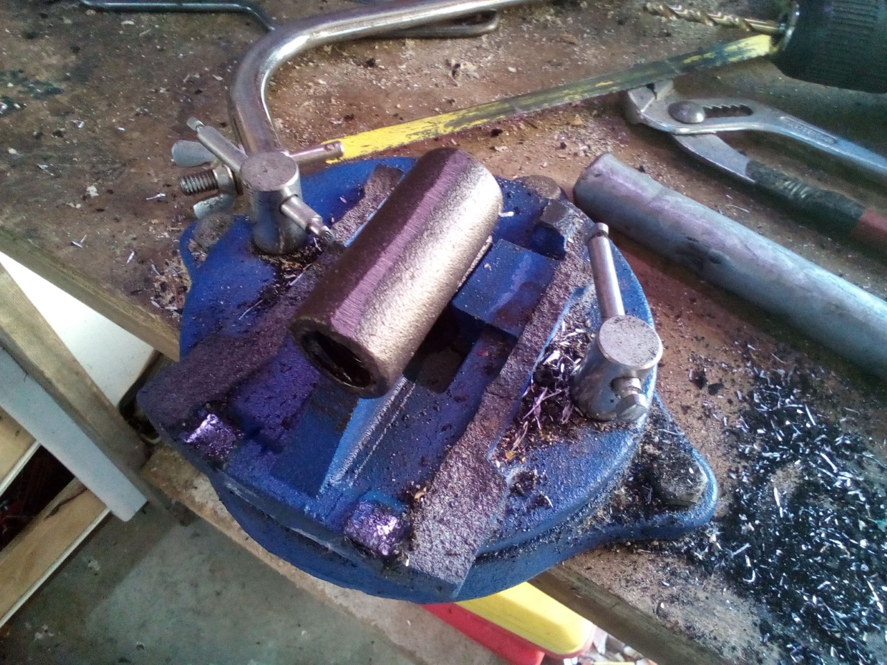

Both bushes are best cut for removal.
cut out old bushing
cut out old bushing

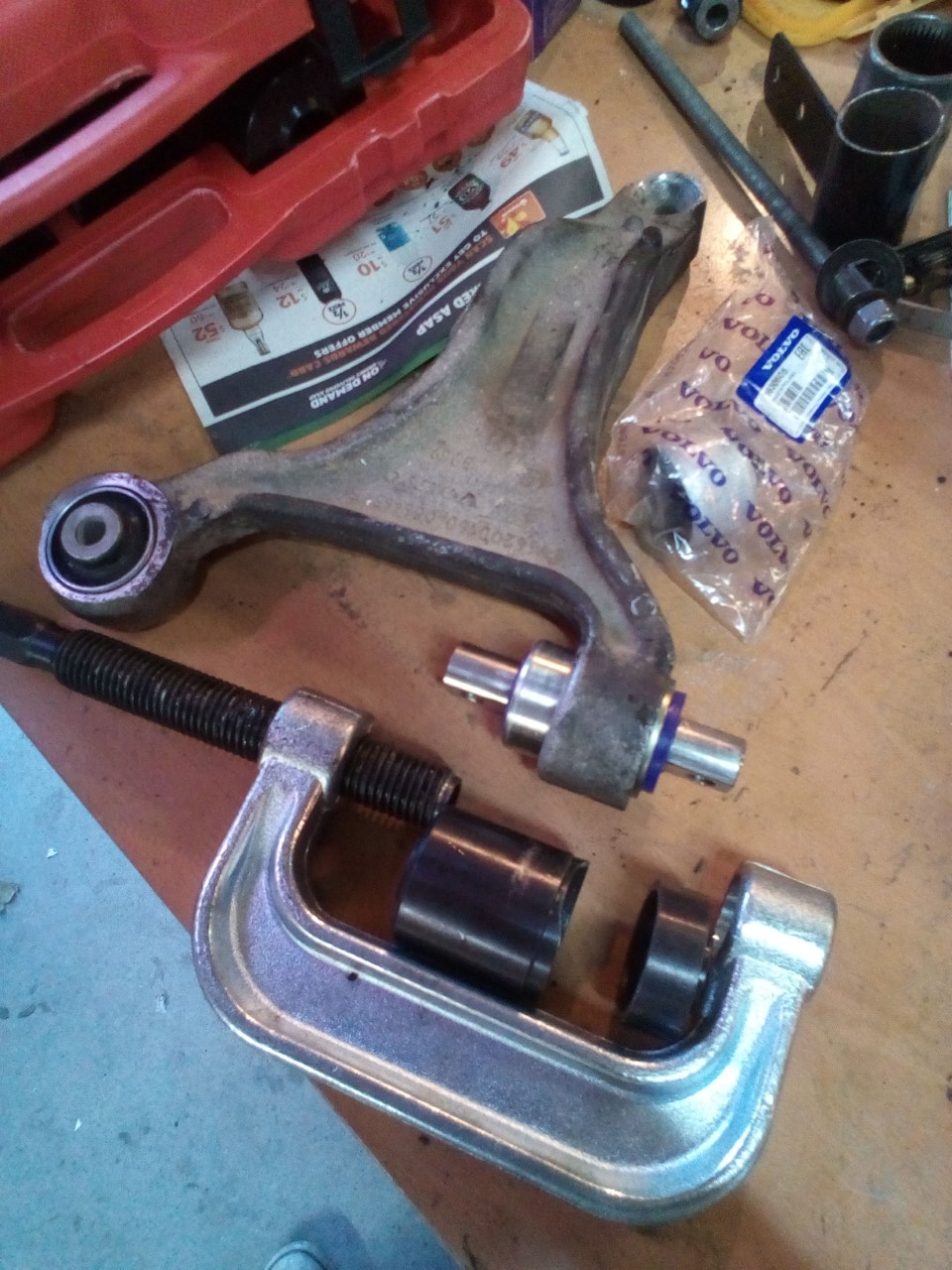

Buy a decent clamping tool with the correct sized cups, i tried two metal shops and non had the correct size pipe for the job.
clamping tool
clamping tool

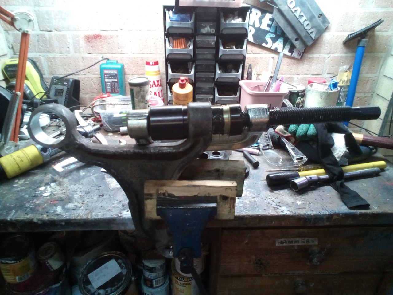

I also used a 5Tonne gear puller because it has a longer reach (long legs), it felt like it was at it limit, would suggest a 10Tonne
The large rear bush is easily done, the smaller front bush is a problem only due to its length. Lub it up and slowly press it in. I tried putting the bushing in the freezer and heating up the LCA with a heat gun but it didnt seem effective
lca press 2
lca press 2

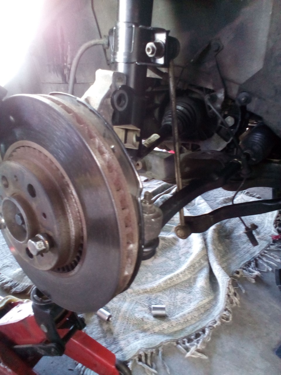

Installing the LCA by removing strut bolts and jacking up hub.

Congrats! One interesting detail is you have the XC70 arms - you notice behind the front bushing the surface is flat so pretty easy to place the adapter. On the S60/V70/S80 this same surface makes an angle, pretty annoying. I think one of the key to success is to render the CA hole as smooth as possible, this reduces the friction coefficient when pressing the busing in.

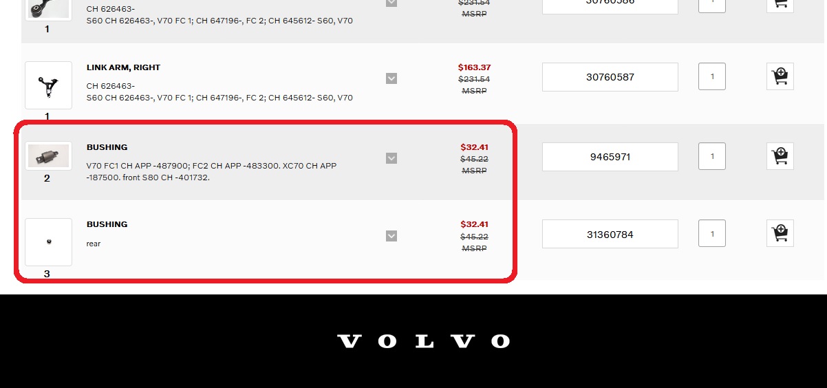

Also -> Amazon link

Post by oragex »
If one can press - or have the bushings pressed - definitely go with genuine bushings from Volvo. The bushings run for $70 for each side - so under $150 for both arms and you know you have genuine, no more worries. I've been there trying control arms (and struts) and ended with genuine bushings. As vtl says, I'm loosing trust in some Lemforder parts - such as their individually sold bushings, I even put their bushing for XC90 and it lasted 1 year.
If you want genuine, these are the parts for my S60 as example - each side runs for $60 USD - see the two very last items at the bottom of the list
https://www.volvopartswebstore.com/show ... evel=24659

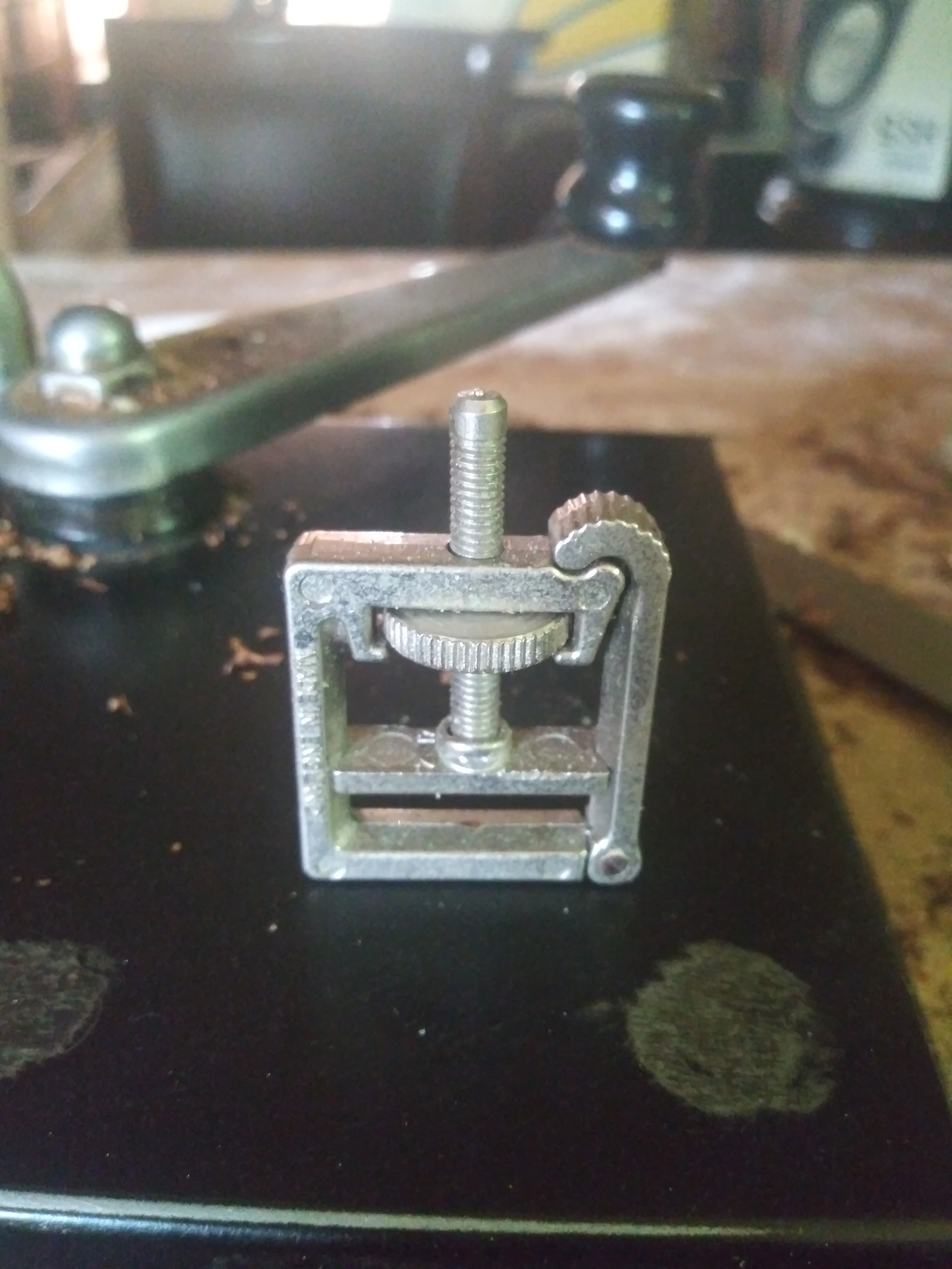

home ovens don't get hot enough for that press fit.
when they fit steel tires to cast iron steam loco wheels they get them very hot with direct flame, they're a shrink fit.
At the high temps needed, I wonder if the rubber inserts can sustain the heat.
Maybe go halfway with heat and dry ice for the insert.
One day I'll get a real press.
I have a small one, good for pressing blueberries maybe.
