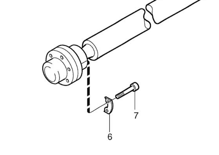

Sorry for not being clear yes prop-shaft bolts internal hex heads number 7
I need the washers - number 6 as well

Added above photo and looks like I need washer # 6 as well.

If you don't still have the washers then yes you will need them too. They do not have locking tabs so not sure what the purpose is but perhaps the flanges needed re-inforcing?

In case someone else has the same question.
These are the part number I was looking for and FCP confirmed that they will fit my car. Thanks all
#6 DRIVE SHAFT WASHER PART NUMBER: 1385088
#7 DRIVE SHAFT BOLT PART NUMBER: 988143
