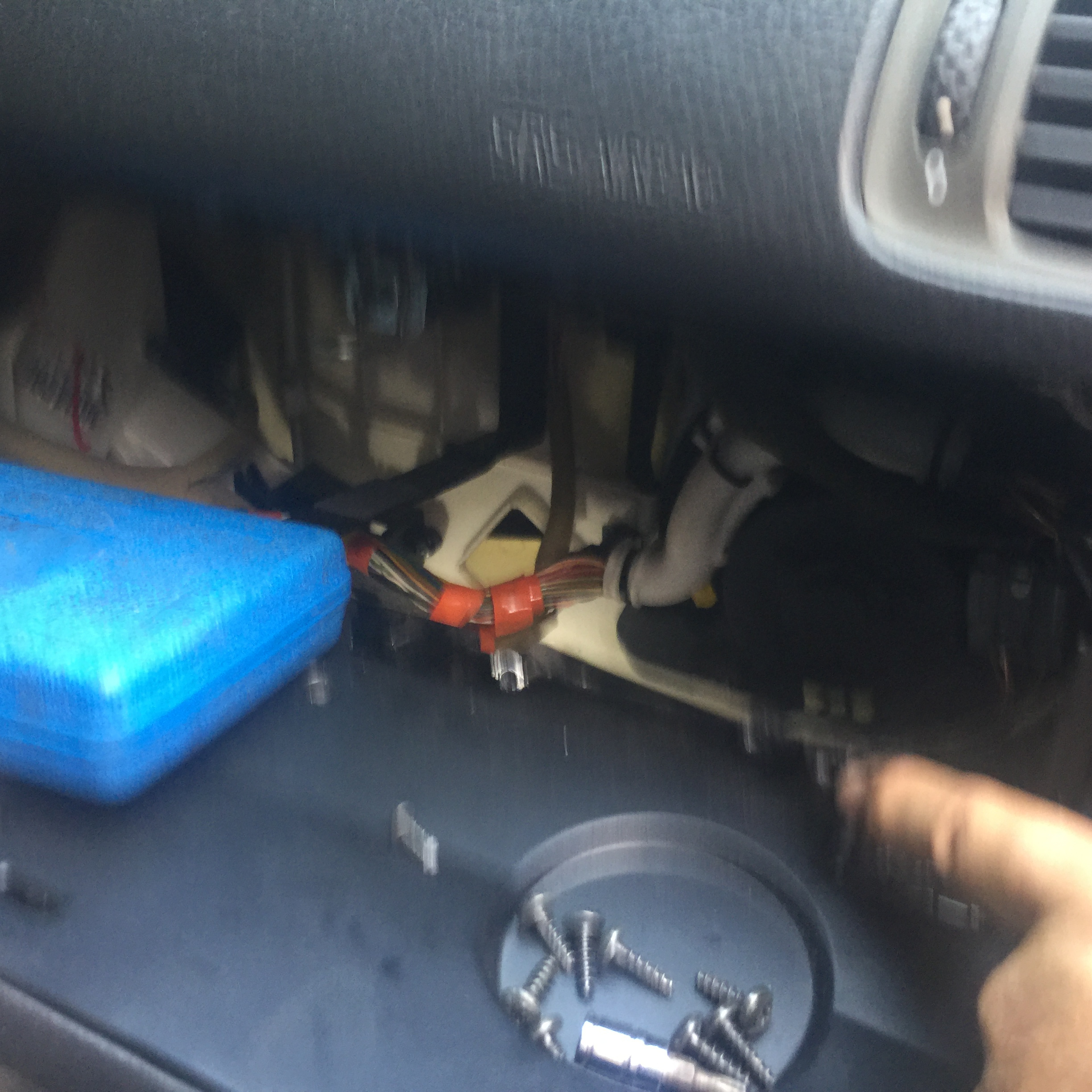

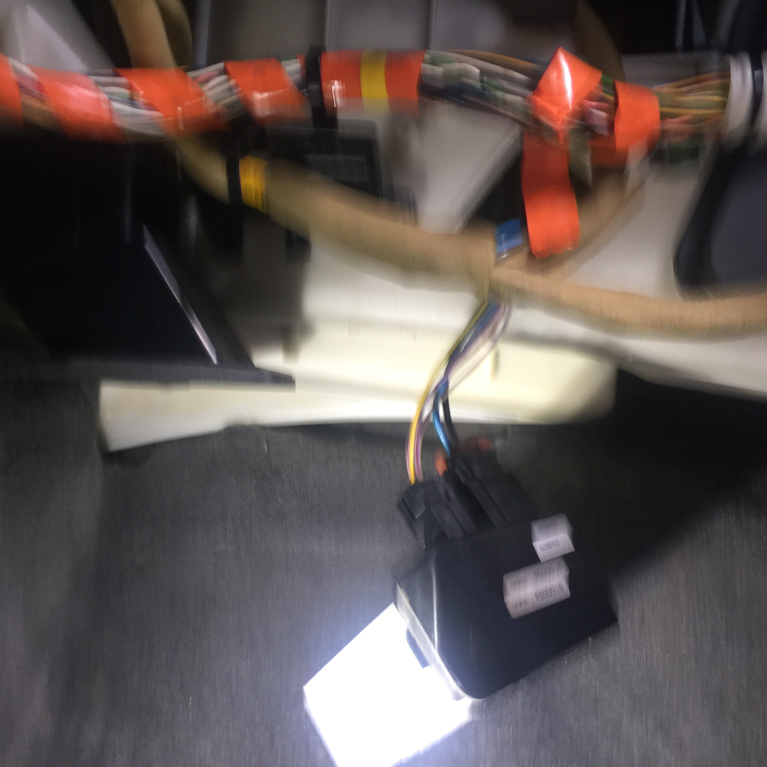

Get a borescope or mirror and have a look at the evaporator through the cabin air filter. You can also remove the power transistor pack and look in that hole

what is the power transistor hole? i will probably go through cabin filter hole. vacuum the system for 24hr? what all new parts would i need for an ac overhaul job? part numbers for those parts? i already found ac compressor. found replacement orifice tube.abscate wrote: 24 Jul 2020, 04:35 Get a borescope or mirror and have a look at the evaporator through the cabin air filter. You can also remove the power transistor pack and look in that hole

Under the passenger side of the dash, if you remove the glove box liner and the lower dash cover, just to the left of the heater fan there is a rectangular electric unit about 3" x 2" in the air pipe from the blower motor to the evaporator. Removing the resistor pack allows you to get a camera in there. Other option is to remove the blower motor and access from there.
- Posts: 36145
Sorry , I don’t know why I wrote that you cam borescope the evap from the air filter. That’s not right.
Here’s how.
Remove glove box liner and lower passenger kick plate.
Remove power transistor
Here’s how.

hahahahhahahahahahahahahahahaha! rare passenger foot vent XD just stick it down there wont have to worry about a foot vent no more XD jkjk thank you for the info.abscate wrote: 24 Jul 2020, 14:30 Sorry , I don’t know why I wrote that you cam borescope the evap from the air filter. That’s not right.
