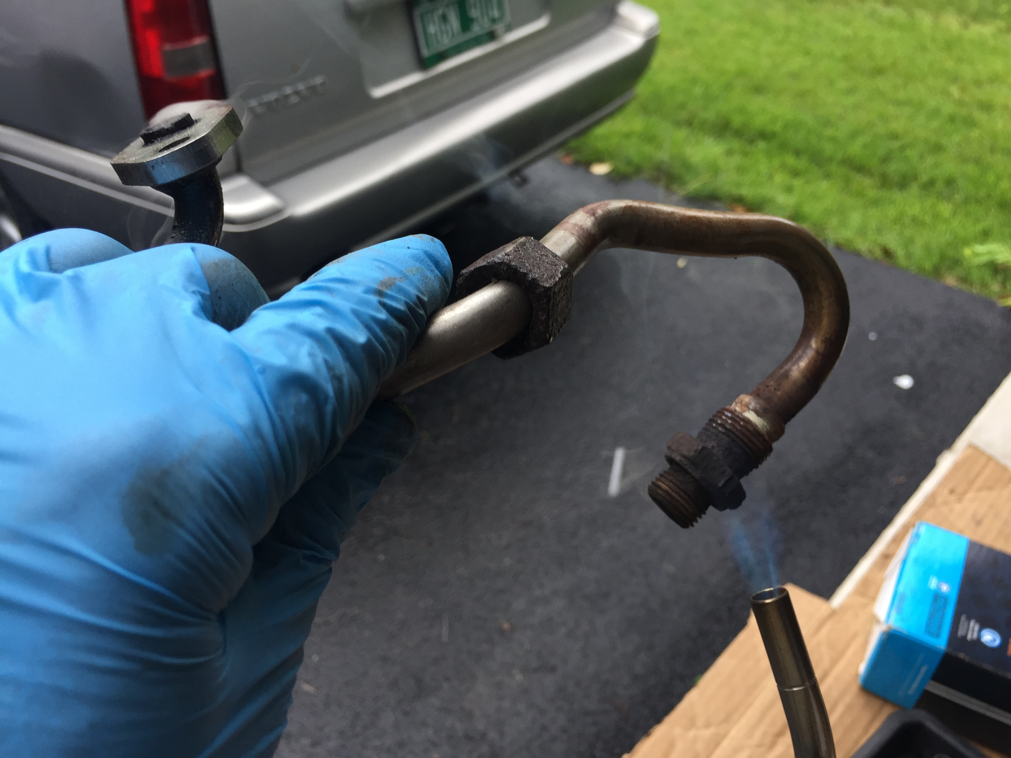

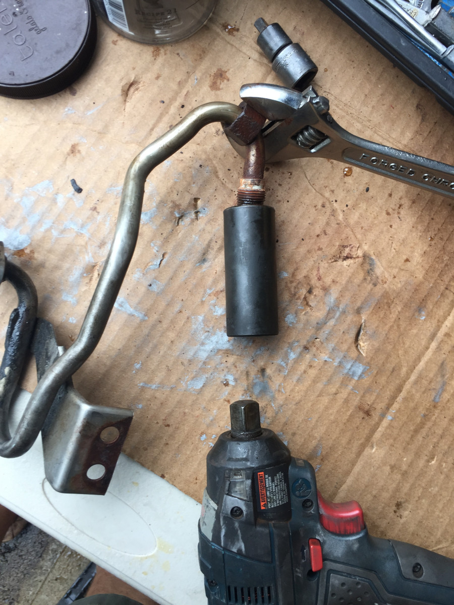

I got this puppy apart with an overnight soak in gas and motor oil, 1:1, then a 21mm impact and crescent
That coupler piece is not going to be easy to find
It’s M16 on one end, M19 on the other , and the m19 end has a tapered inside to take the swage on the SAS air pipe.
Be nice to that unicorn part..it says it is available at Volvo web store but .....

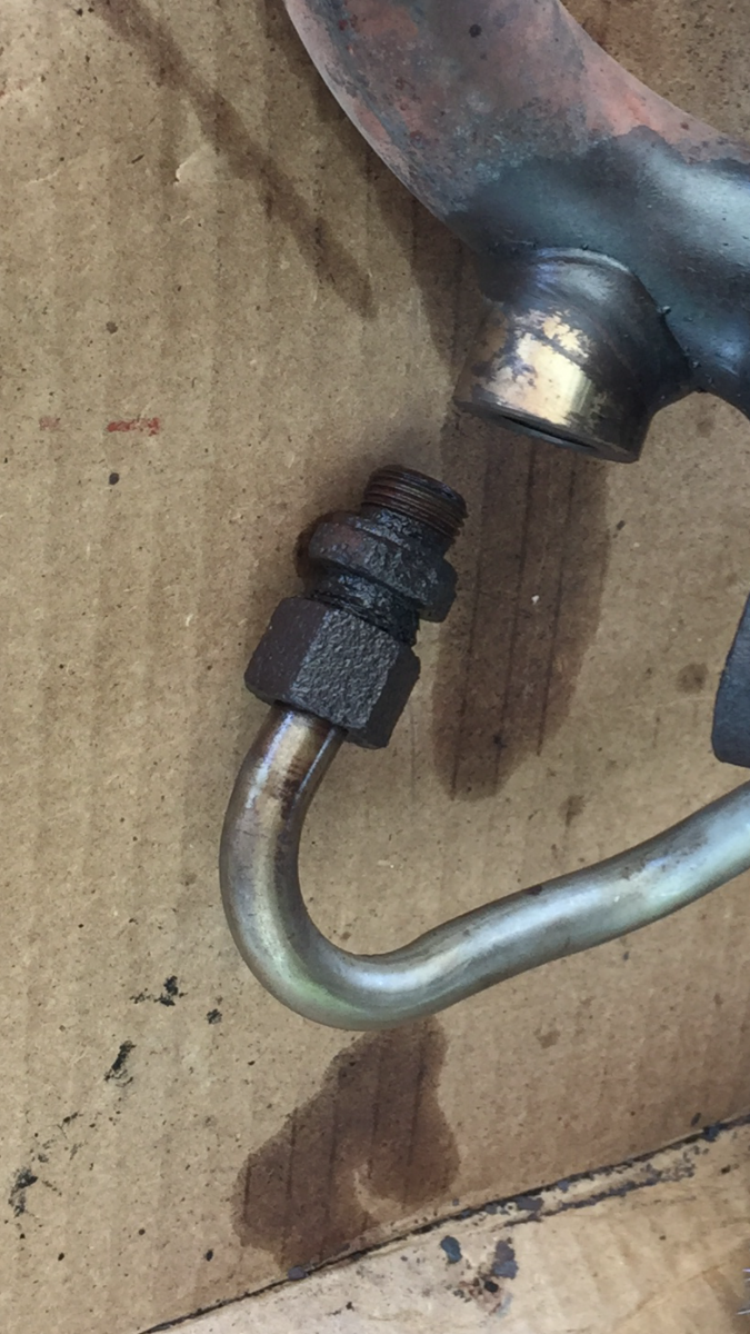

Is that a metal shaving in the threads of the fitting?
- Posts: 35280
- Has thanked: 1500 times
- Been thanked: 3812 times
Nice gorp of antiseize

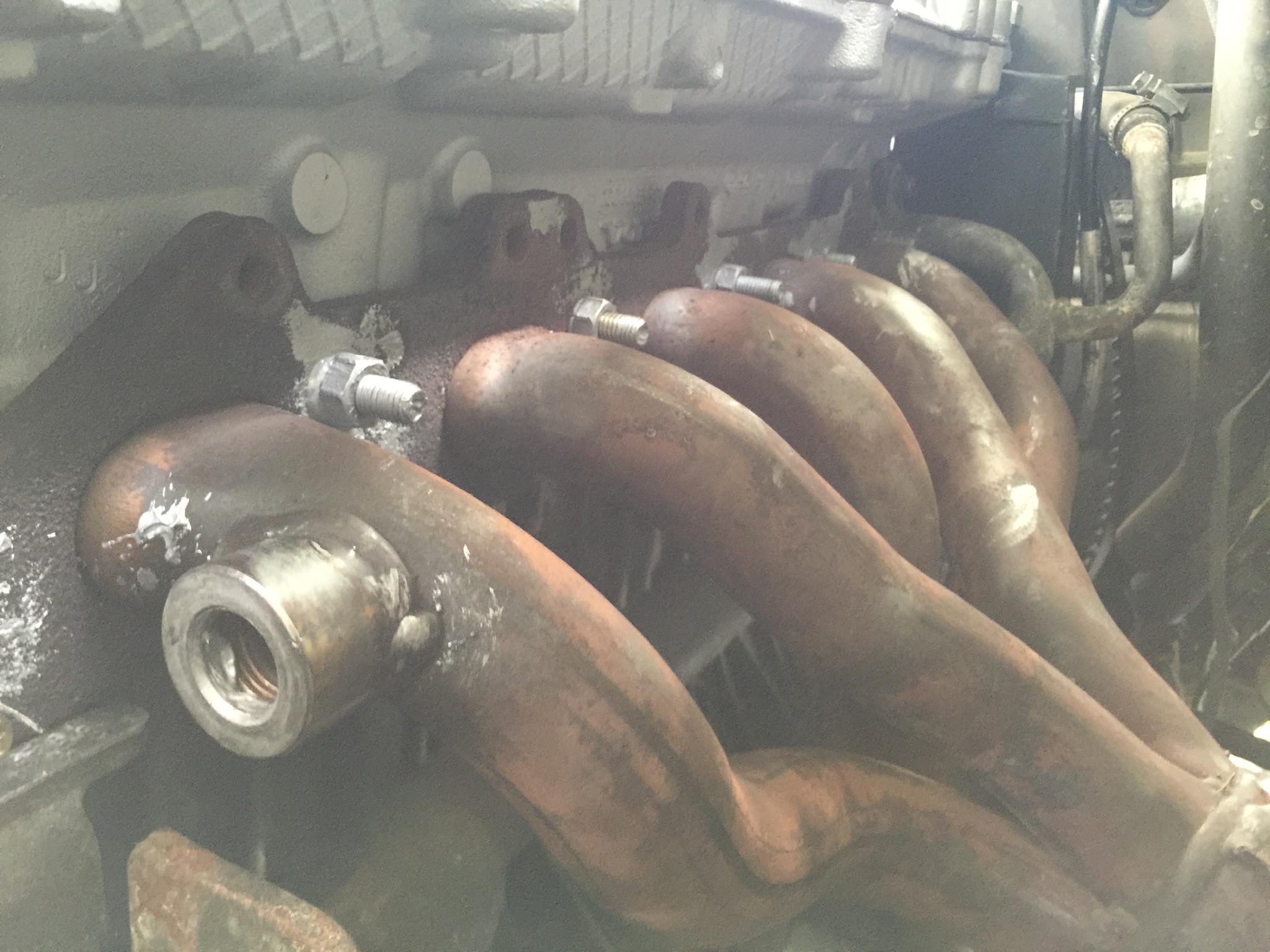

M16 thread into the exhaust manifold ‘
M19 thread with an internal taper for swage on the other end

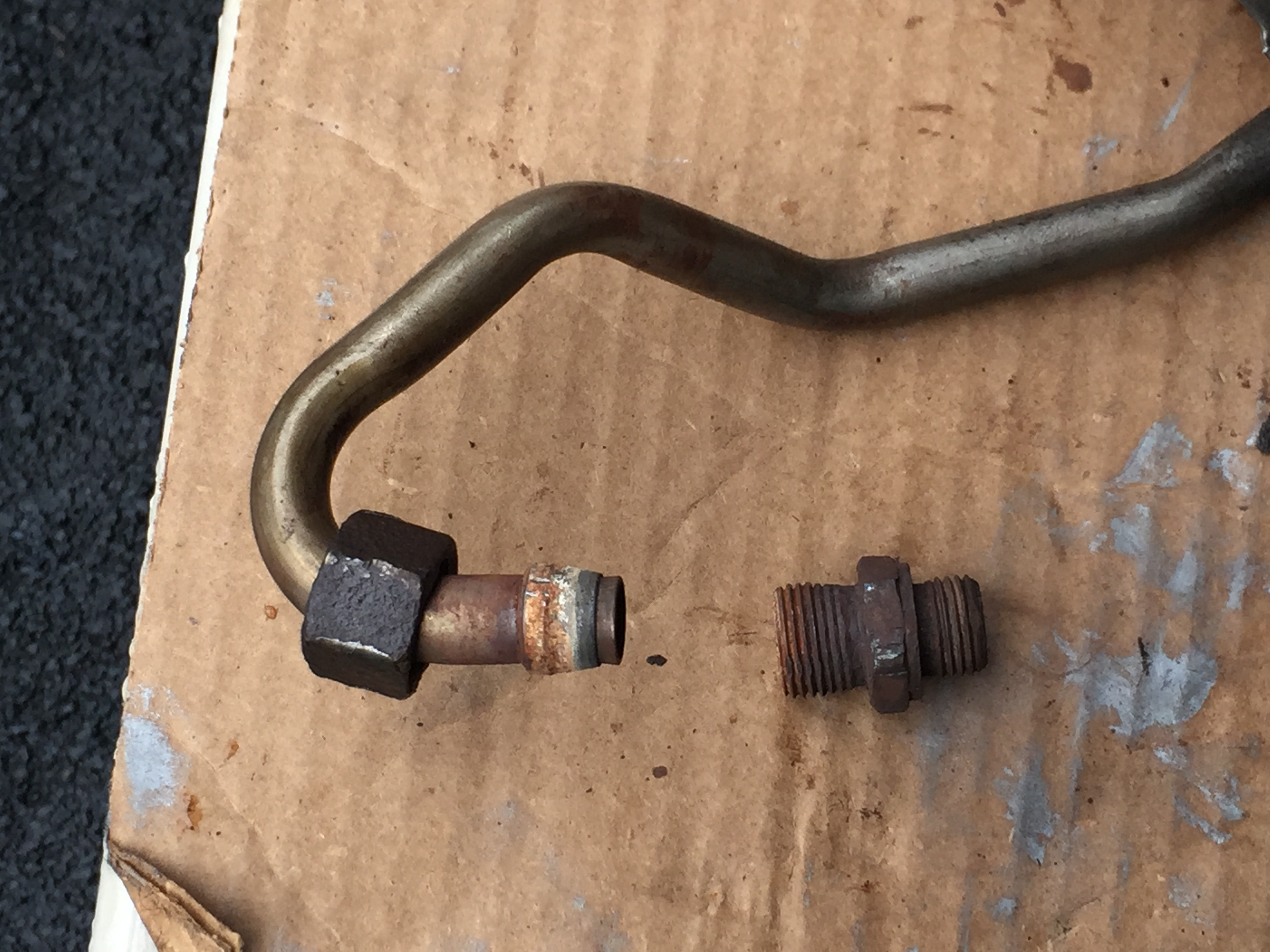

I’ll shoot an internal picture this morning.
It took me just as long to free the taper from the swage as it took to crack the male M16. To male M19 coupler off the union nut on the air pipe.
