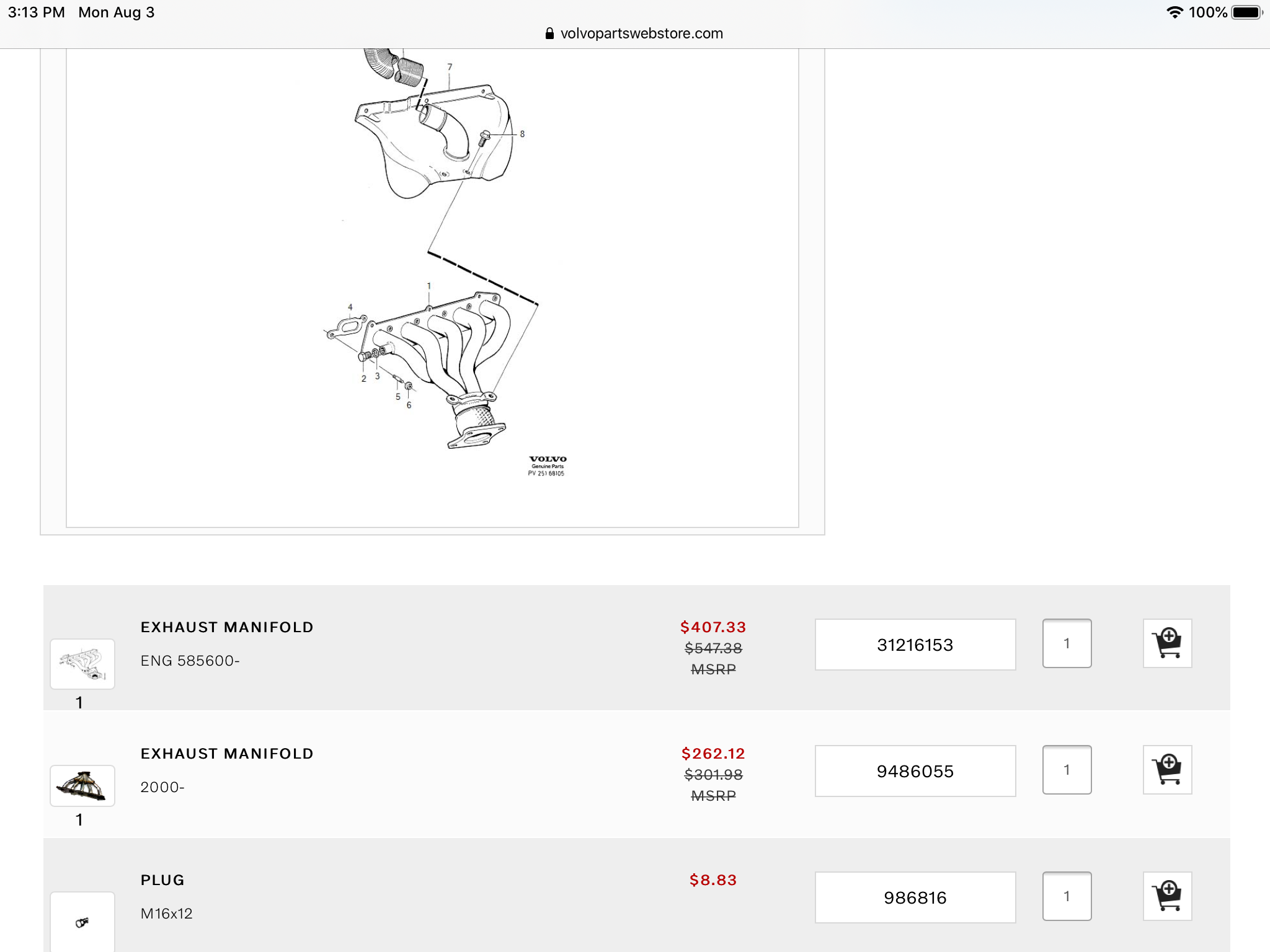

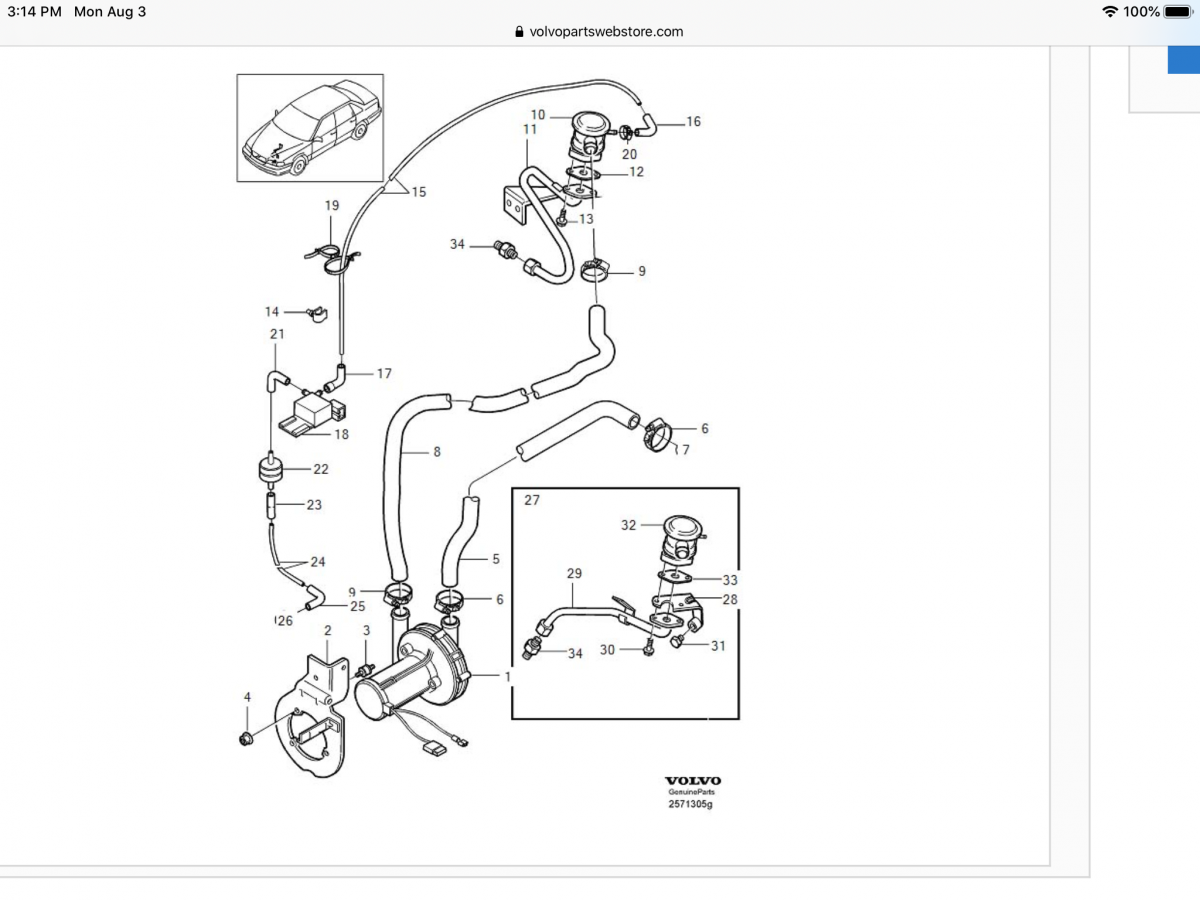

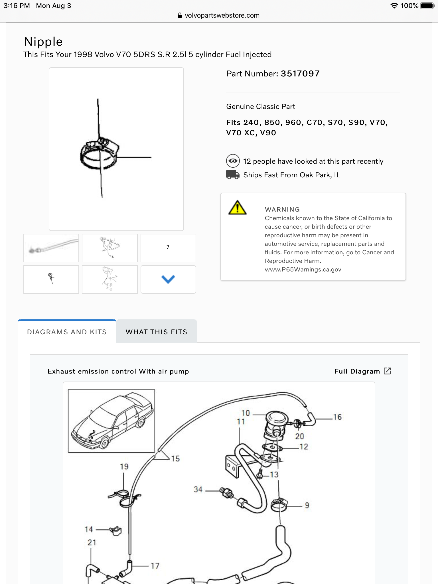

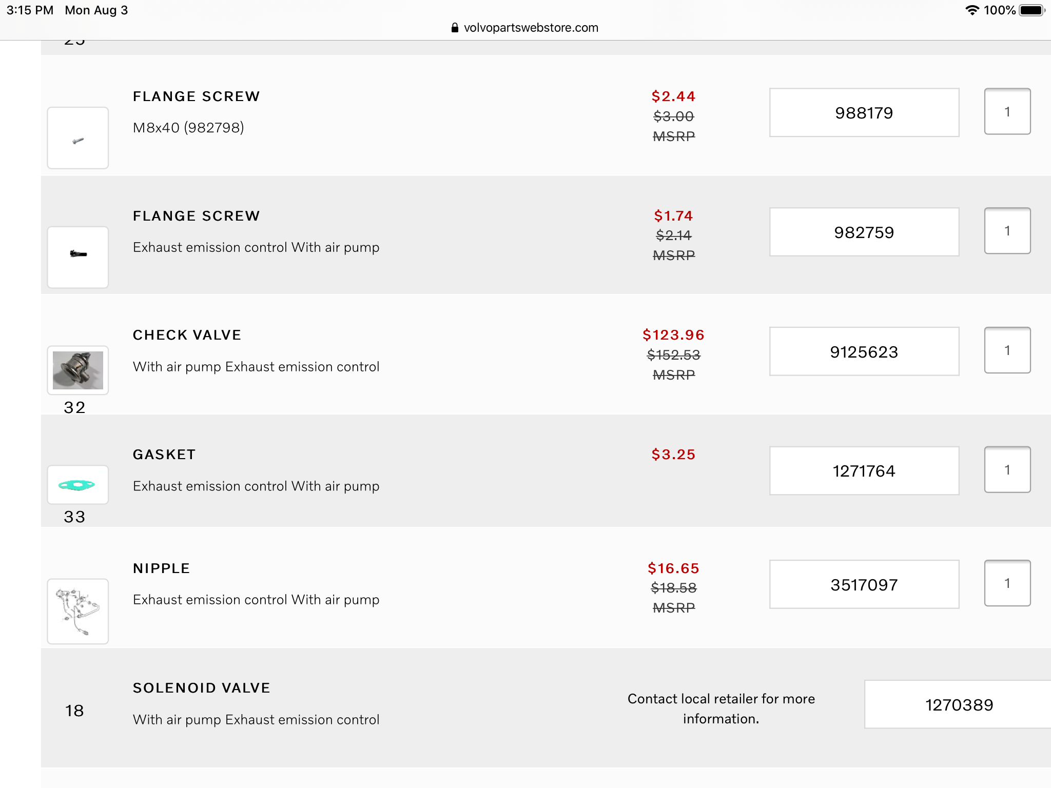

Some pictures and part numbers of the exhaustvconnectio to the SAS system
