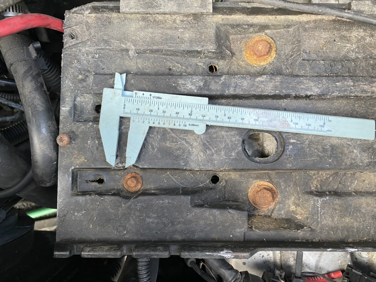

No, sir, that bolt is one of the two bolts the secure the battery tray. The bolt Im trying to find is smaller (definitely smaller than M12, but cant tell if M10 or M8 as my bolts head has rusted away), and is the only other bolt in the battery tray. It sits further to the US passenger side of the engine bay on the tray, in the central groove. I'll grab a picture when British summer stops living up to its name.

It’s probably an m6 , 6 mm shank, 10 mm hex head but I’ll take a look at mine this am

If this is it is an 8 mm hex head which will make it an M4 1 mm pitch bolt

That's the beggar, many thanks! One down, one to go.
