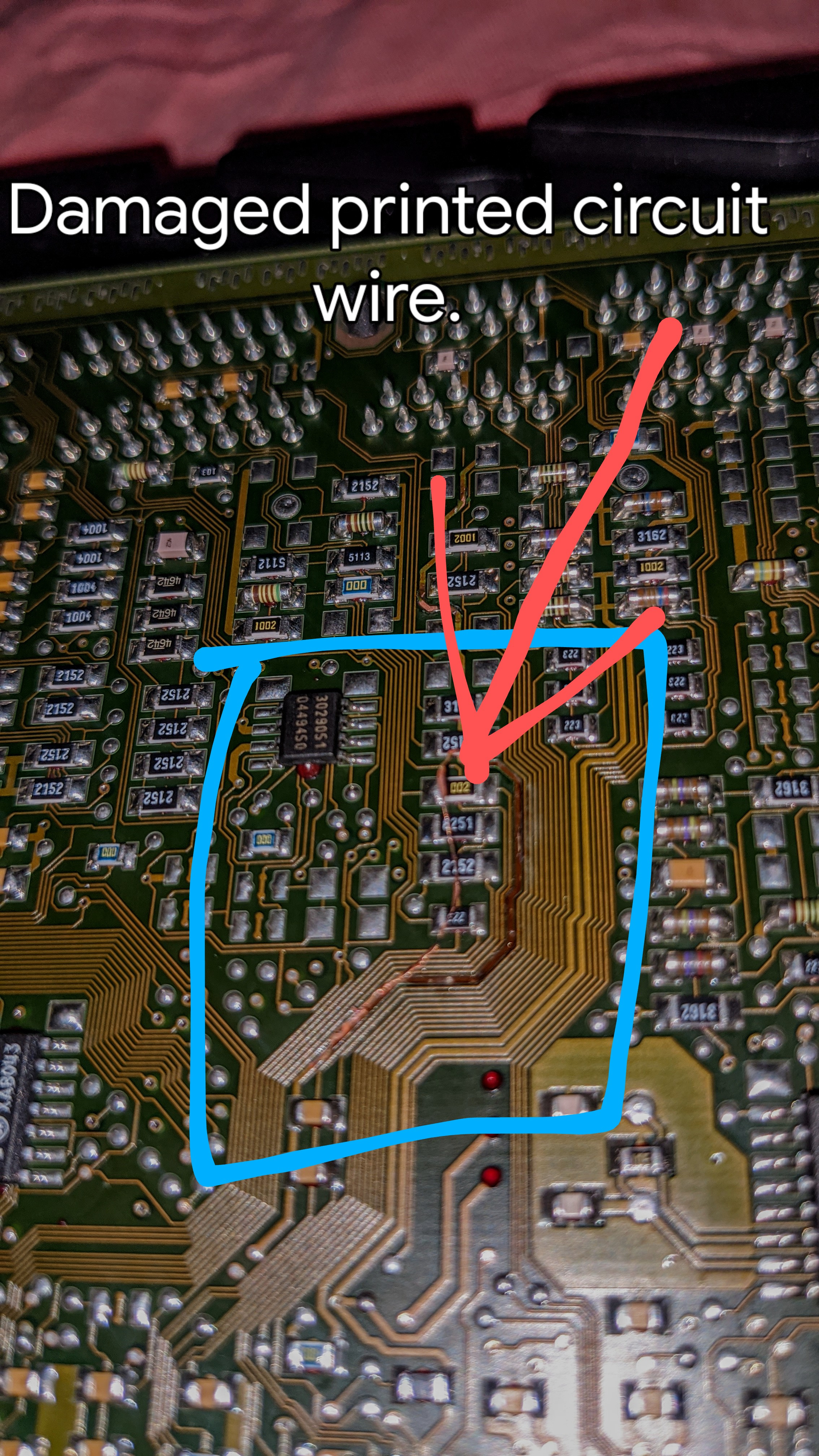

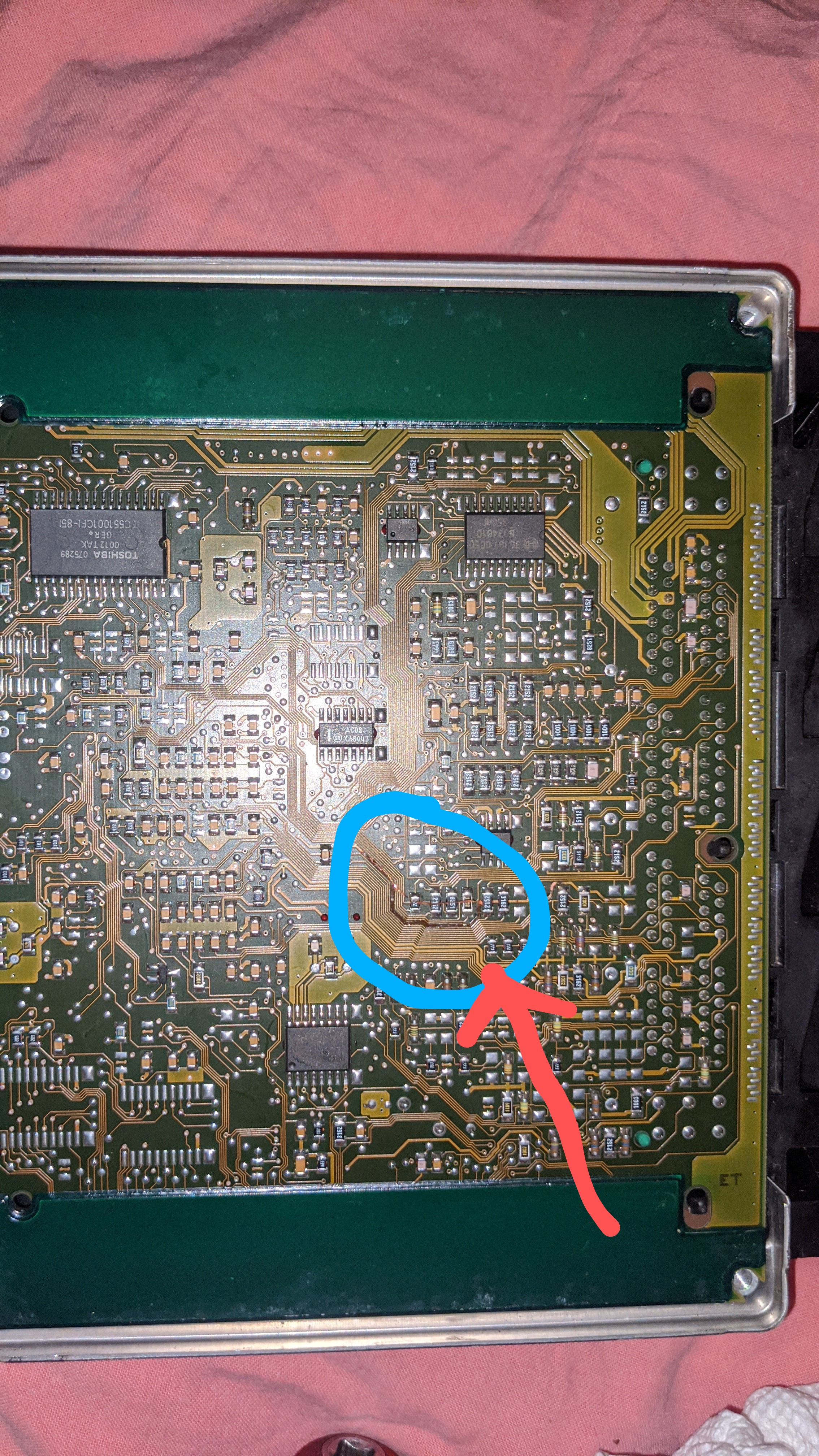

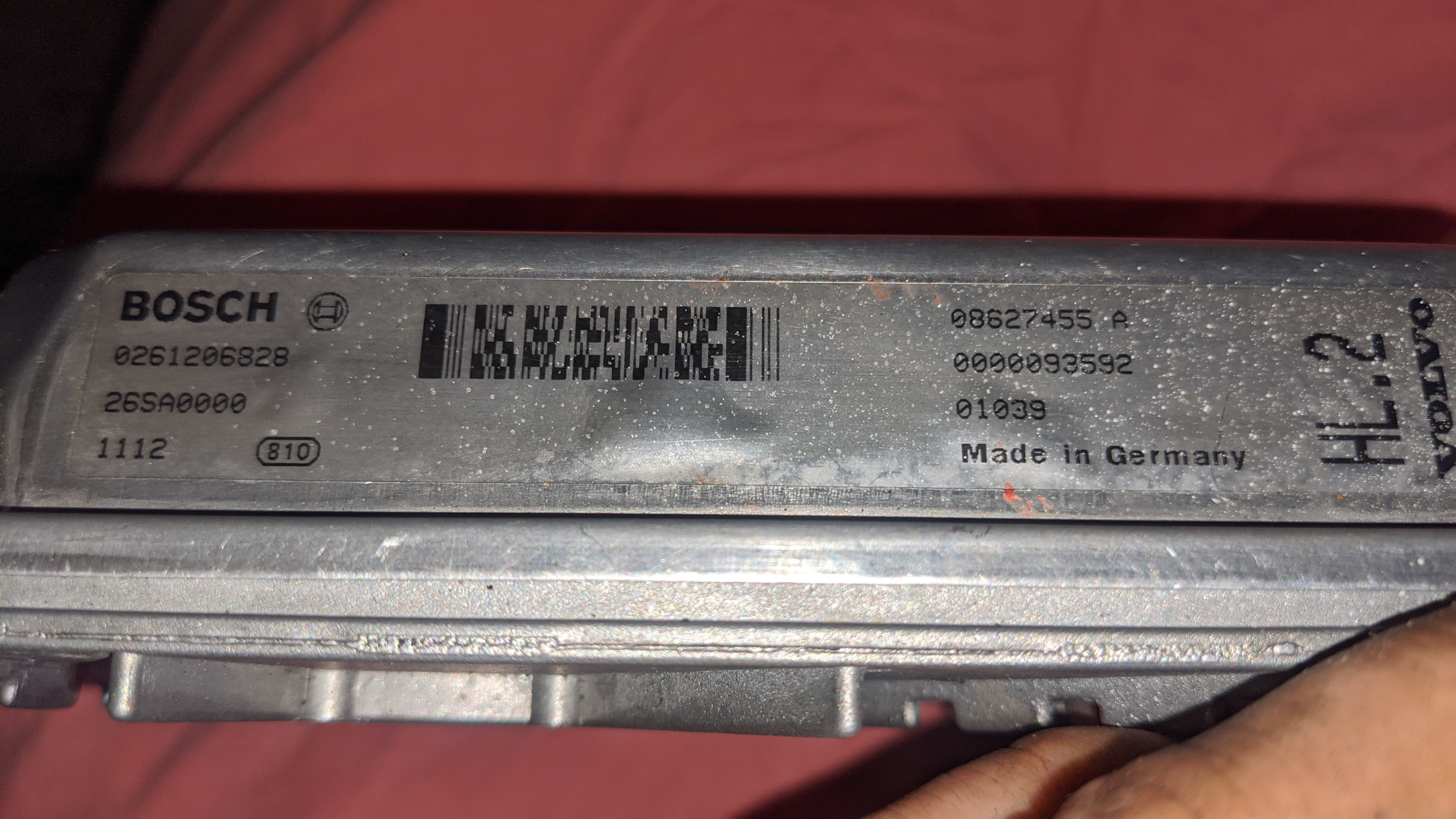

Photos of the damaged ECM:

Worst case to try...it might be possible for someone with the right tools to lift the software from your ECM physically by removing the chip and soldering it into anew one.
