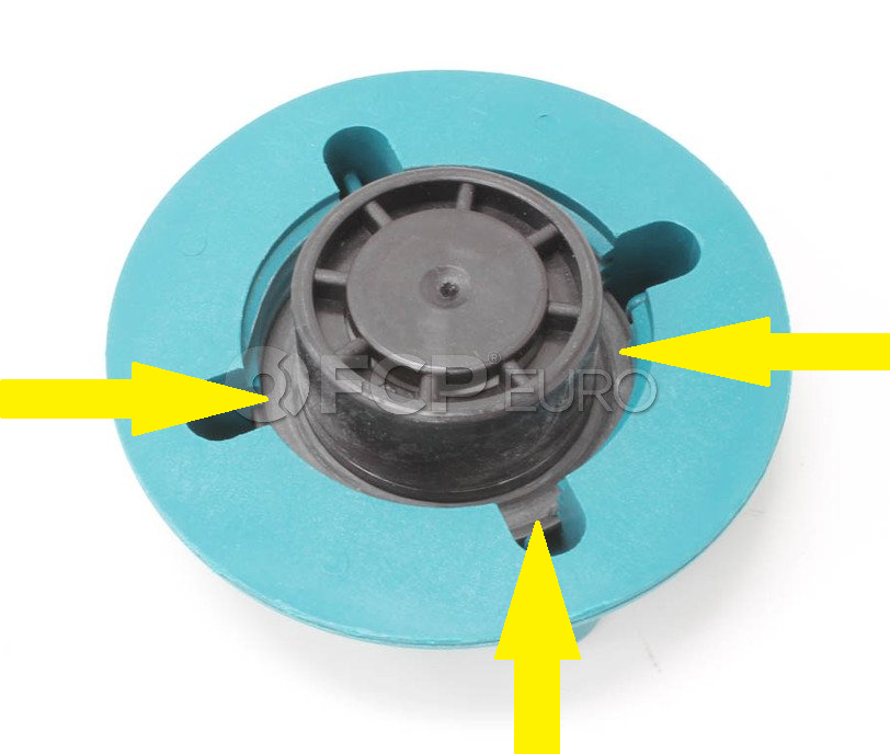

subzerocarfanatic wrote: 19 Aug 2020, 07:18
MoVolvos wrote: 19 Aug 2020, 00:17 *
The photo for the Rein part is even larger.
https://www.fcpeuro.com/products/volvo- ... 65-9445462
...and they clearly have no gasket.
The black ring is the gasket.

abscate wrote: 18 Aug 2020, 19:14 URO things are fine unless they touch:
Air, water, windshield washer fluid, coolant, power steering fluid, engine oil , ATF. Gear oil, differential oil, brake fluid, Haldex fluid, blinker fluid, grease, compressed air.
I left off vacuum.
"Blinker fluid" AKA free electrons covers my recent wrestling match with a URO turn signal/corner lamp for my '97 850. A good 45 minutes with a drawer full of tools, and my rusty Model Railroading-level skillset later and it finally went in place and worked.
Back on point, not sure what to make of the OPs comment about the cap seal; every one I've seen has that gasket, as depicted in the pic in the link. How else would this pressurised coolant system work?

What you guys are calling a gasket is just the center plastic part of the cap, am i missing something? Ahhh, now i see it at the base, yellow arrows, i will look.
