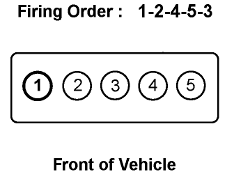

Open the hood, stand there and look at the engine. From the right (driver side) the cylinders are numbered 1,2,3,4,5 from the driver side to passenger side. Correct ???
Before when its said misfire on #3 I counted that way and the spare ignition coil normalized it worked out great, back in bidness immediately..

#1 is closest to the timing belt.

Rocket99 wrote: 21 Aug 2020, 14:37 From the right (driver side) the cylinders are numbered 1,2,3,4,5 from the driver side to passenger side. Correct ???
Correct for a Right Hand Drive car.
Not correct for a Left Hand Drive car.

I assumed which direction the cylinder numbering went, incorrectly. My brain is a little scrambled from Covid isolation (in a 50,000 acre park) and wildfire evacuation that became a possibility (a very dry forested park) , thick smoke day n night, that was hairy.
I actually went hunting for verification which way the numbering goes never did find it in Haynes or the Volvo owners manual, you guys helped out so thanks for that.
In the end that made for a quick fix, new coil and spark plug and injector, now I have more spares and it was back to normal. Thanks for that guys.
