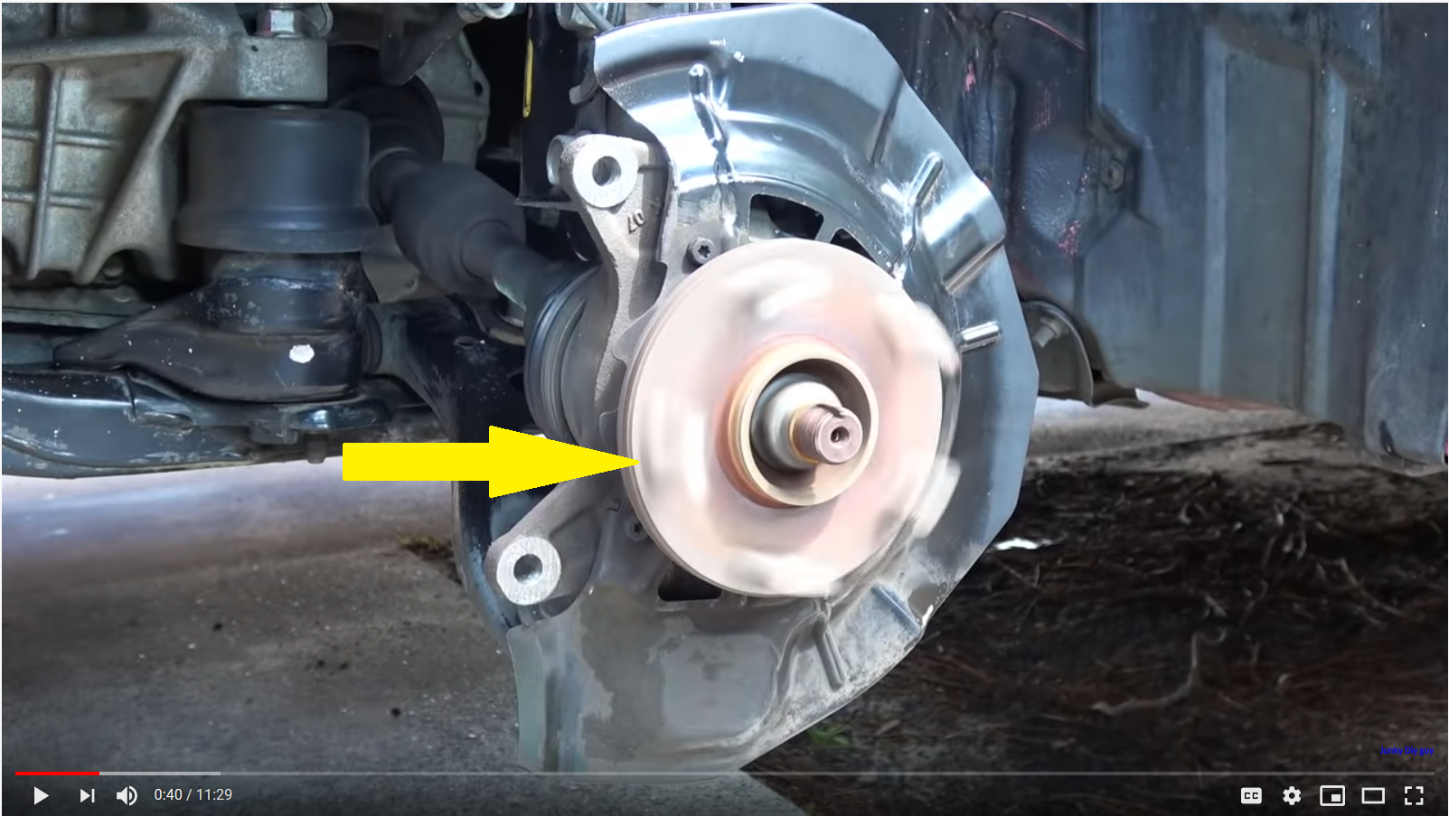

Remove all the parts and spin the axle / hub as in the video @ 0:40. Carefully set stationary or hold pointer of some kind near the outer edge careful not to hit the stud and see if it is round.

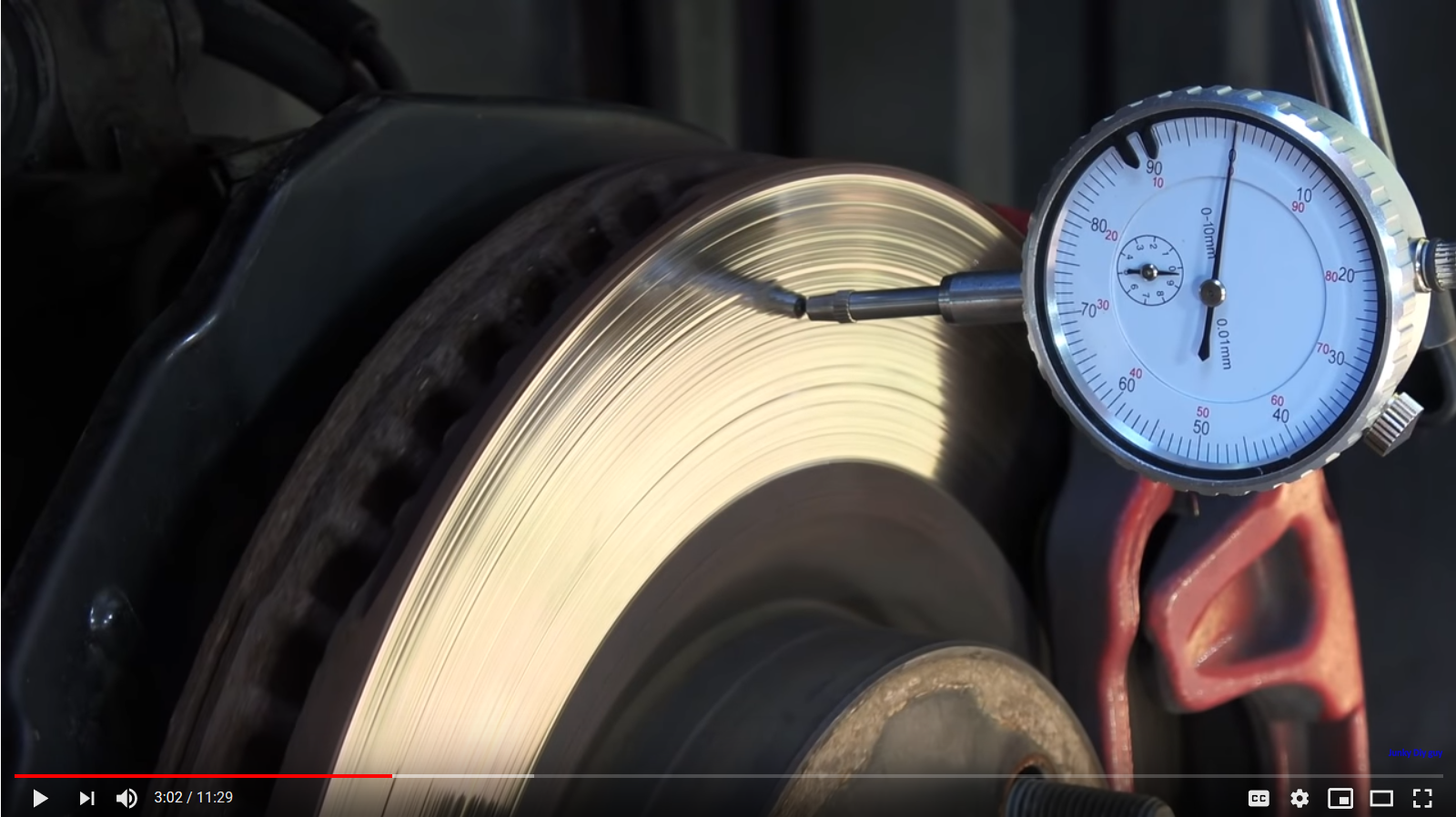

It's best to have a tool to check for Run Out except without the rotor @ 3:00 in the video.
