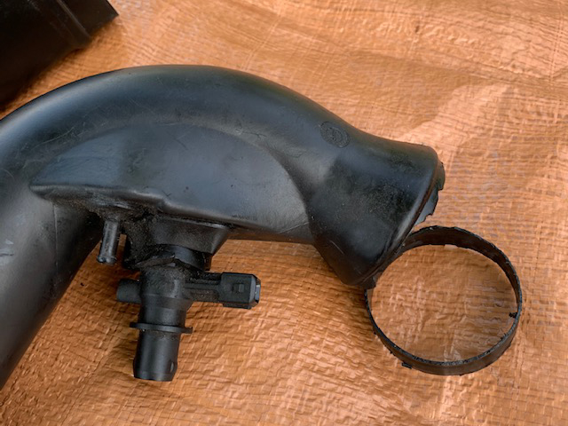

HELPFULL! Intake pipe connection at turbo is separated; broke off from the clamped end..abscate wrote: ↑08 Sep 2020, 10:29 Ive found there is time saved removing each hose, covering each hole to prevent tool loss, the examining each piece of induction hose out of the car under strong light for holes, soft spots, splits, and other distress.

The parts from FCP arrived FEDEX Next Day. It is put back together -- a shade tree family mechanic event. Next, a test drive then to O'Reilly's for code check for road worthiness.

Replaced the ambient air hose to the air box, MAF, intake hose between MAF and turbo, and the TCV. Checked the hoses and pipes for routing. It starts and runs like a champ. Acceleration is stable, but taking foot off the gas pedal has light jerk - NOT when taking pressure off the gas pedal.
It burps coming down from 1000rpm to idle, but settles to around 720rpm. Is this a new normal? O'Reilly guy said to drive away, but check the Compressor Bypass Valve function, your thoughts?

Let the adaptives relearn for a week of driving.
