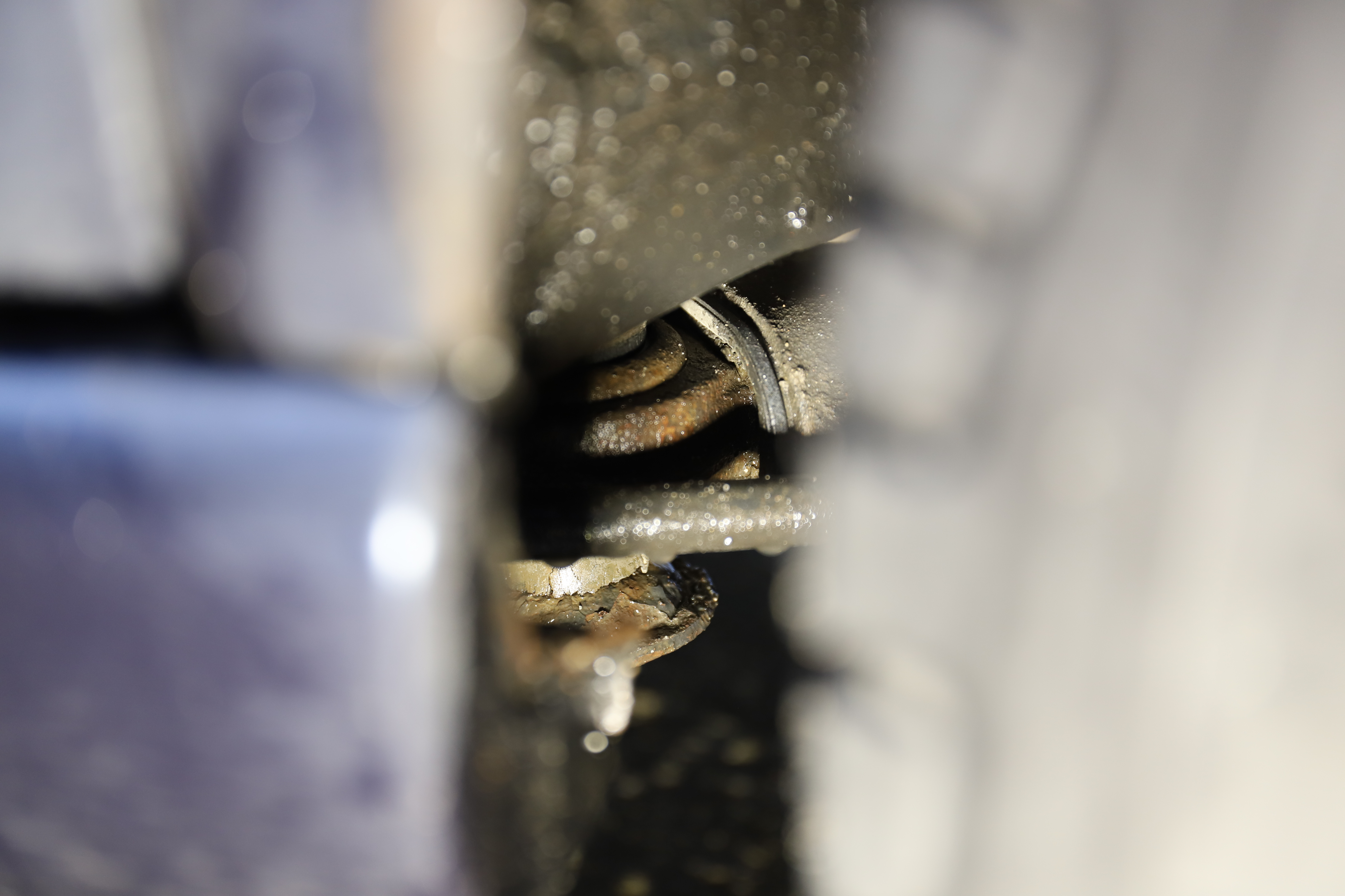

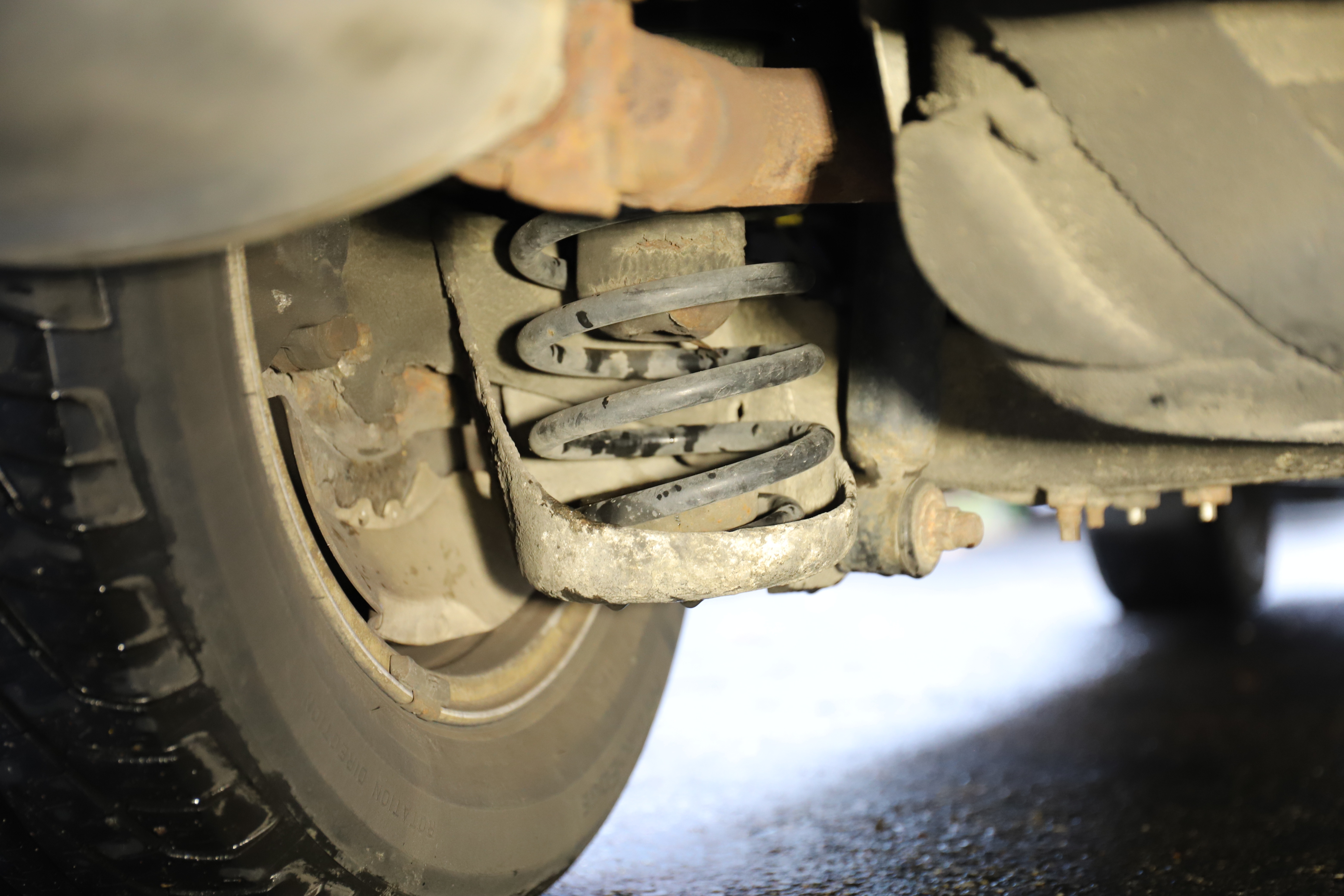

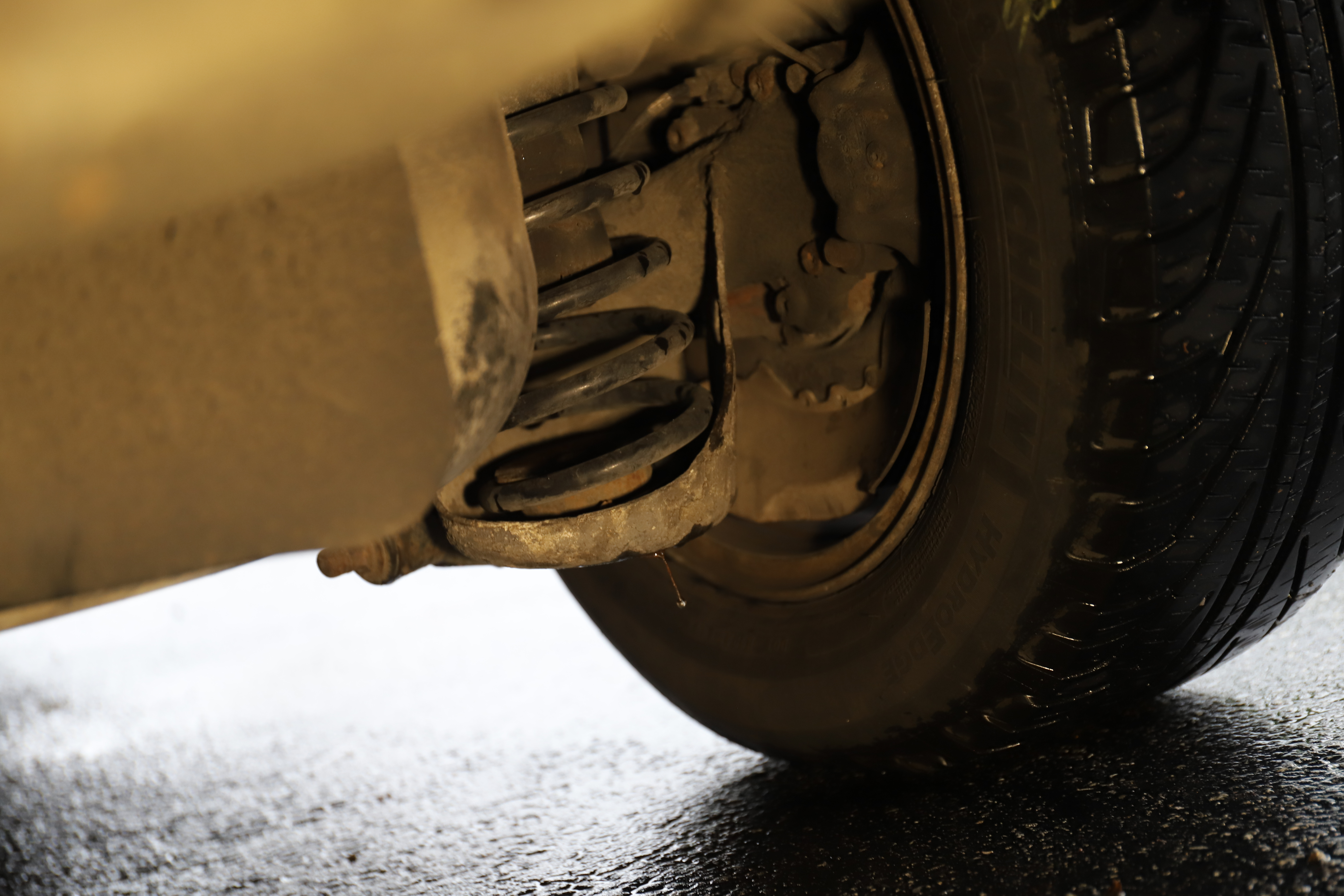

Checked both delta links and they seem fine, i added some pictures to illustrate the lack of "excessive rust"
The delta link bushing on the side that makes sound
The side that does not make sound:
The side that makes sound
