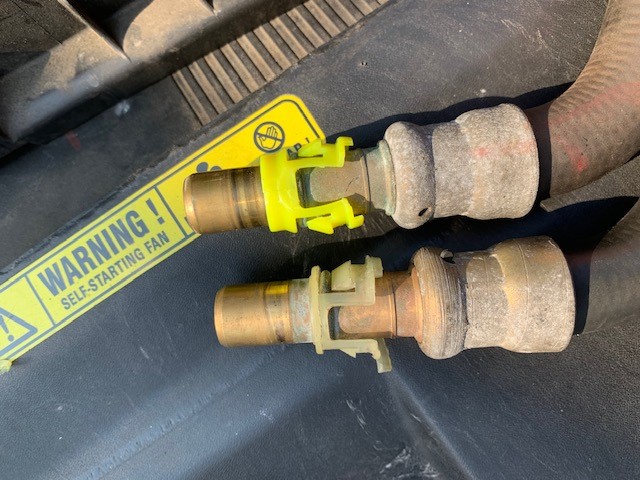

Had some issues with the block to firewall inlet hoses. I know they sell these clip sets now with the taller yellow clips and the o-ring/yellow washer/o-ring three-piece stack. However, the hoses pulled from my car had lower-profile whiteish clips and no discernable o-ring stack. In fact, when I got the clips loose, I did not even see a single o-ring in either port. It feels like it goes straight to the metal tubes that connect to the core. I even picked around in there with a dental pick and nothing came out of either port. Abscate mentioned the o-rings may be seated somewhere in the metal firewall housing, but I couldn't see anything, and I don't think I felt anything.
Long story short, I couldn't make the newer, taller yellow clips work at all, let alone add any of the o-rings. I was able to salvage one of the original white ones and it fits fine with the new hoses and seated with a satisfying click. I trimmed one of the yellow clips down and then sanded it until it was the size of the white ones, about 3/16" shorter than they come from FCP. That one also fit perfectly with the new hose and resulted in a firm click.

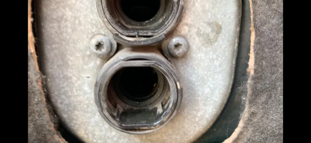

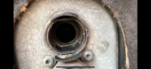

See photos. This car is a 1996 base 850 auto. It seems no work has been done to this system since new, but I'm wondering if I'm missing something. Does it look like there is an o-ring in the ports? To me it looks and feels like metal. Once the brass part of the hose is about 5/8" in the tube the plastic clips seats and locks it in.
I don't really feel totally comfortable knowing I'm using one 25 y.o. original and one modified clip to hold these important hoses in with. But, they seem to be fine. They weren't leaking before, I am just replacing them on interval principle as I replaced the other four main coolant hoses earlier this summer. Is it possible this setup is ok without an o-ring? are the taller yellow clips and stacked o-rings for an updated firewall inlet? The tubes from firewall to heater core in mine seemed like unfinished aluminum.

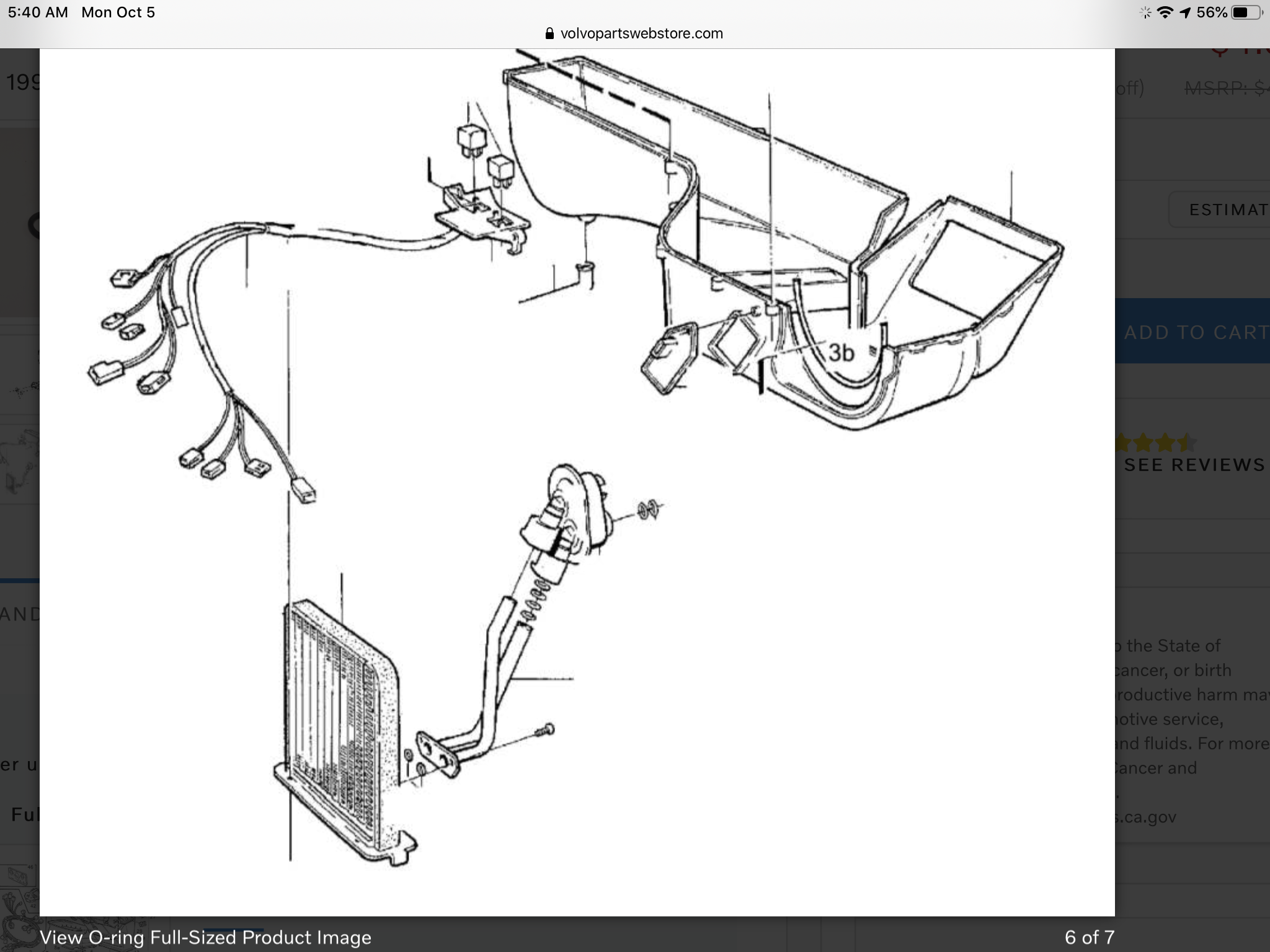

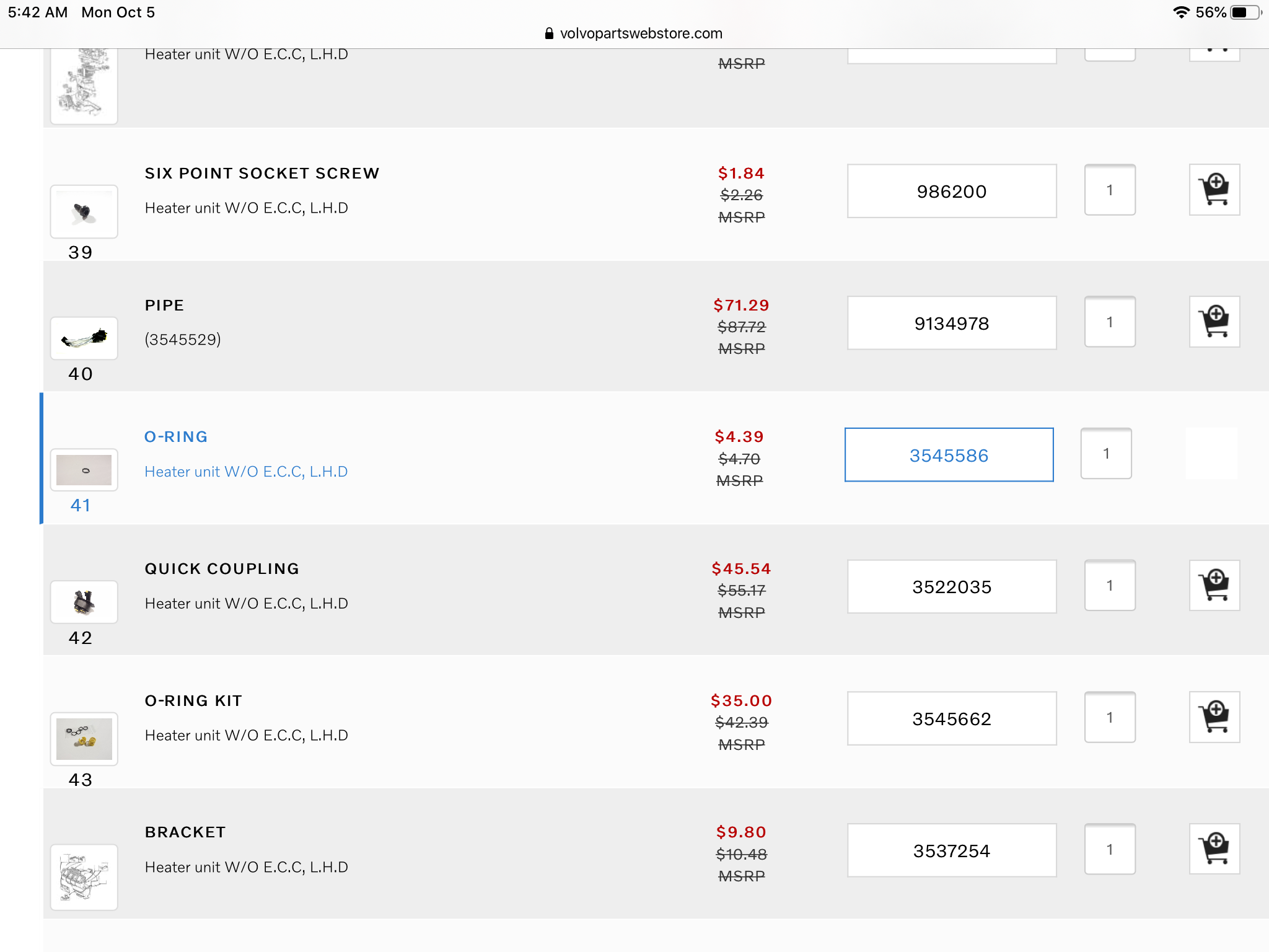

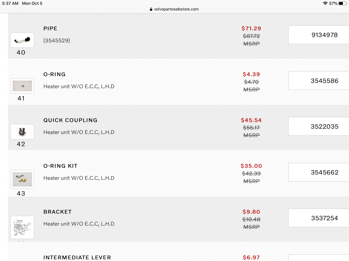

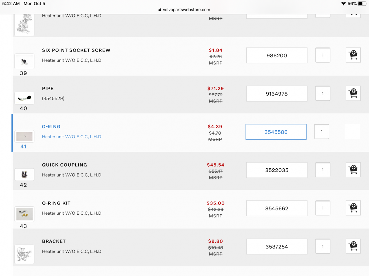

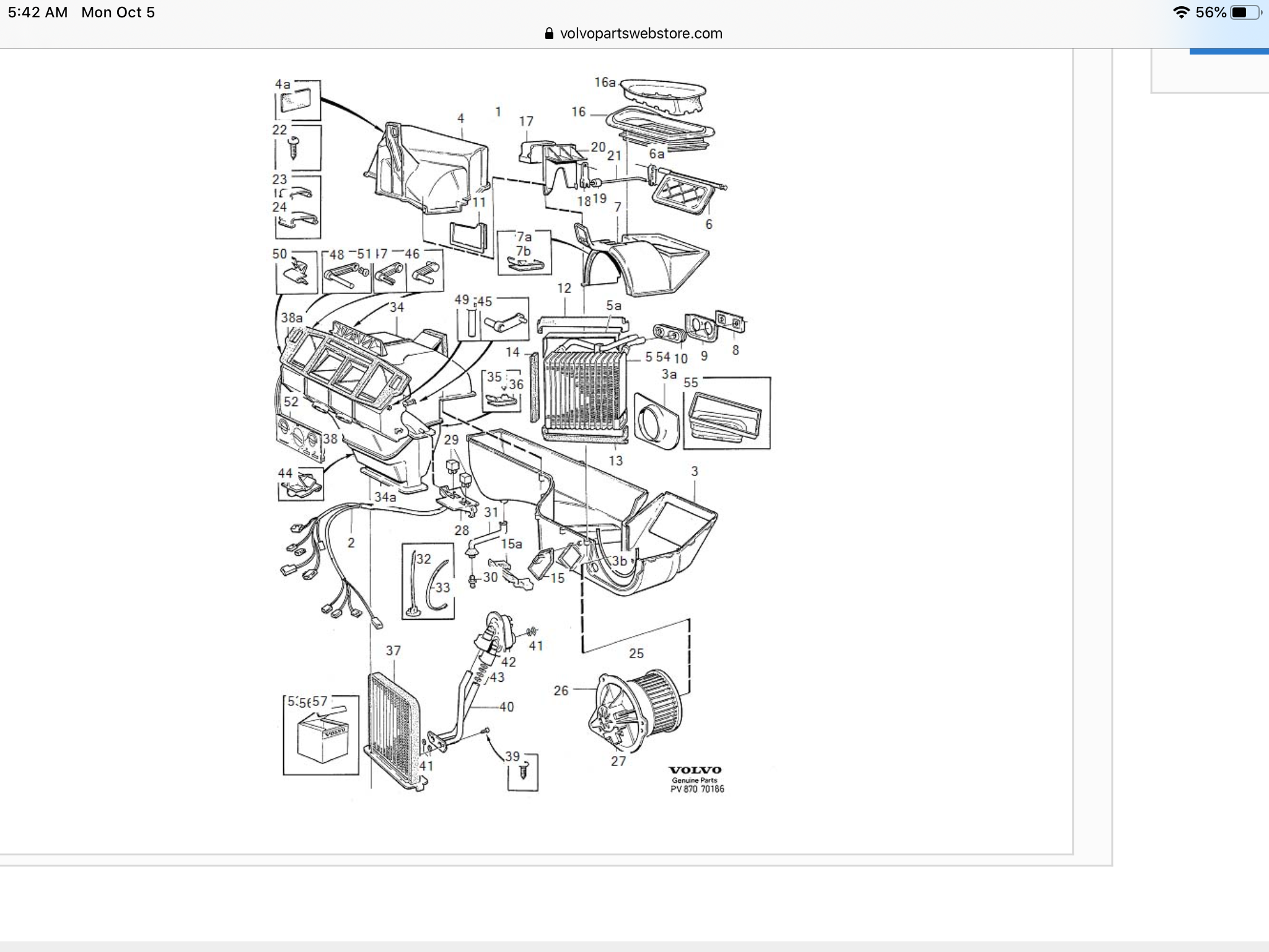

They show the same part number for the internal o rings on the heater core and the firewall bulkhead on volvowebstore.

TL/DR but you didn't get out the spacers and o-rings. There is no metal inside there, it is plastic and o-rings. Hopefully they last.

This.
I had this same "issue" when I was putting my car back together.
Dig in there more, you'll pull out the old stuff.

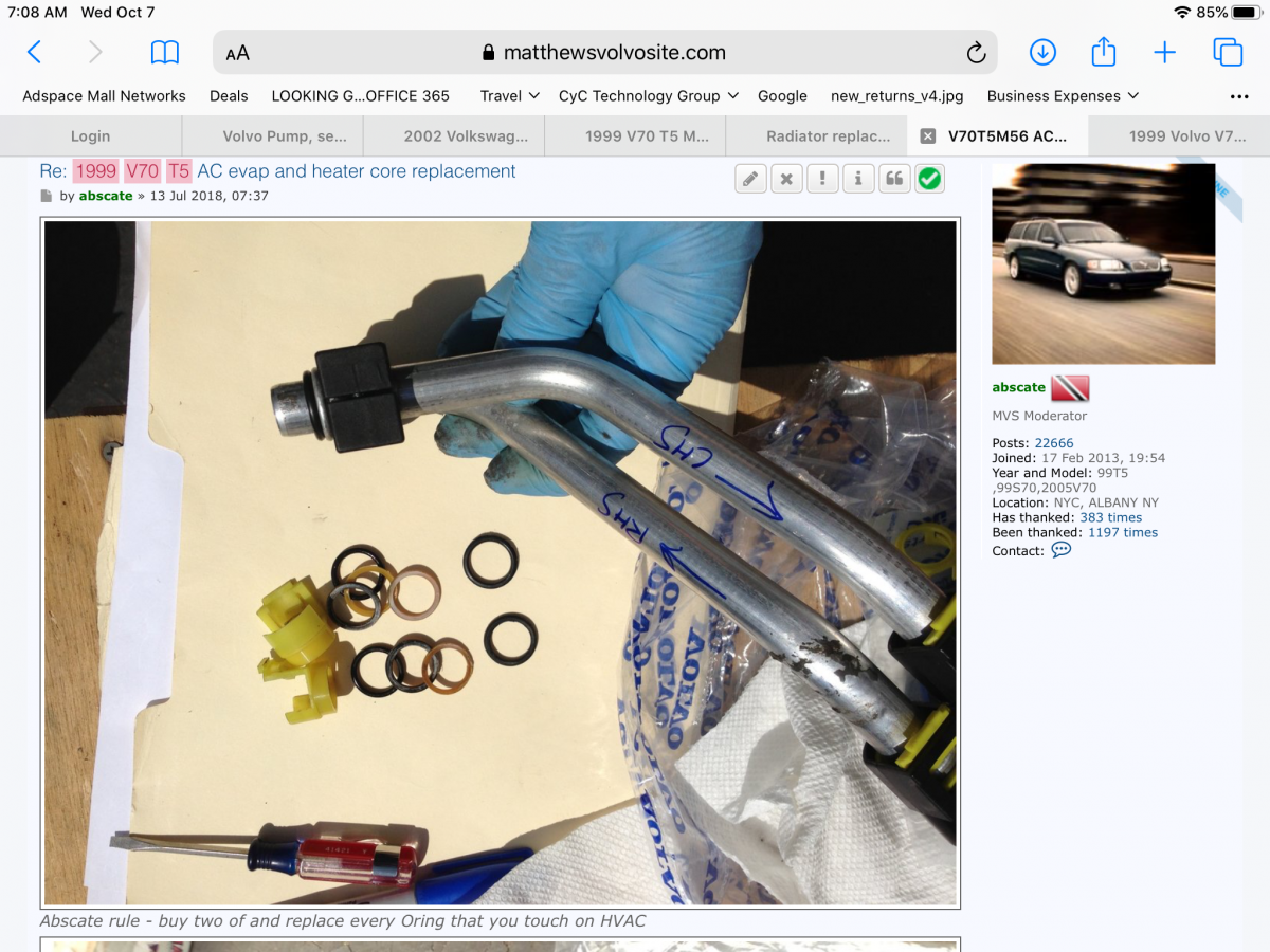

When I did my first radiator in 2013 I had the same issue with the clips, the supplied ones did not latch. I’m still using the 1999 ones in my T5.

Here’s the picture from that thread
