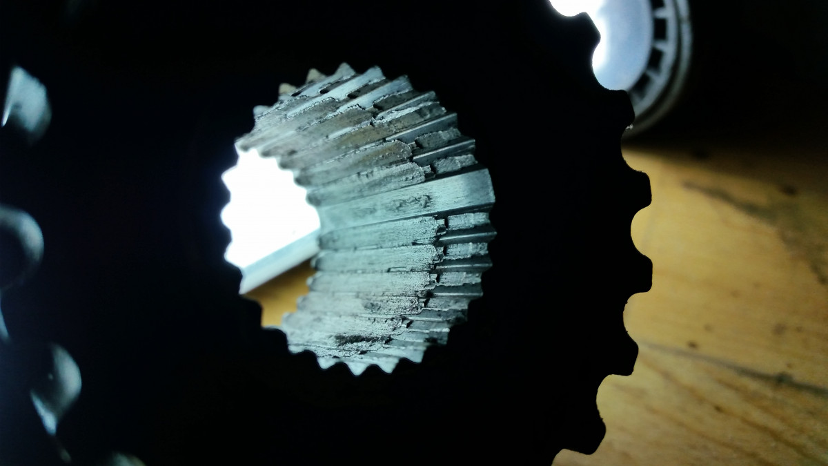

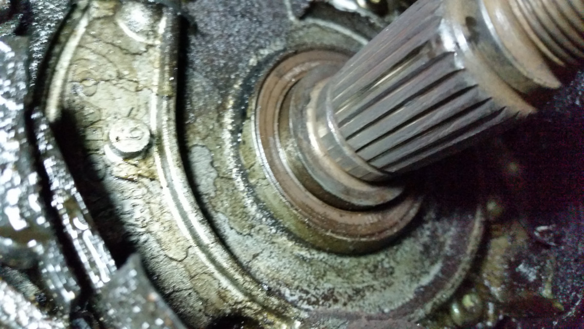

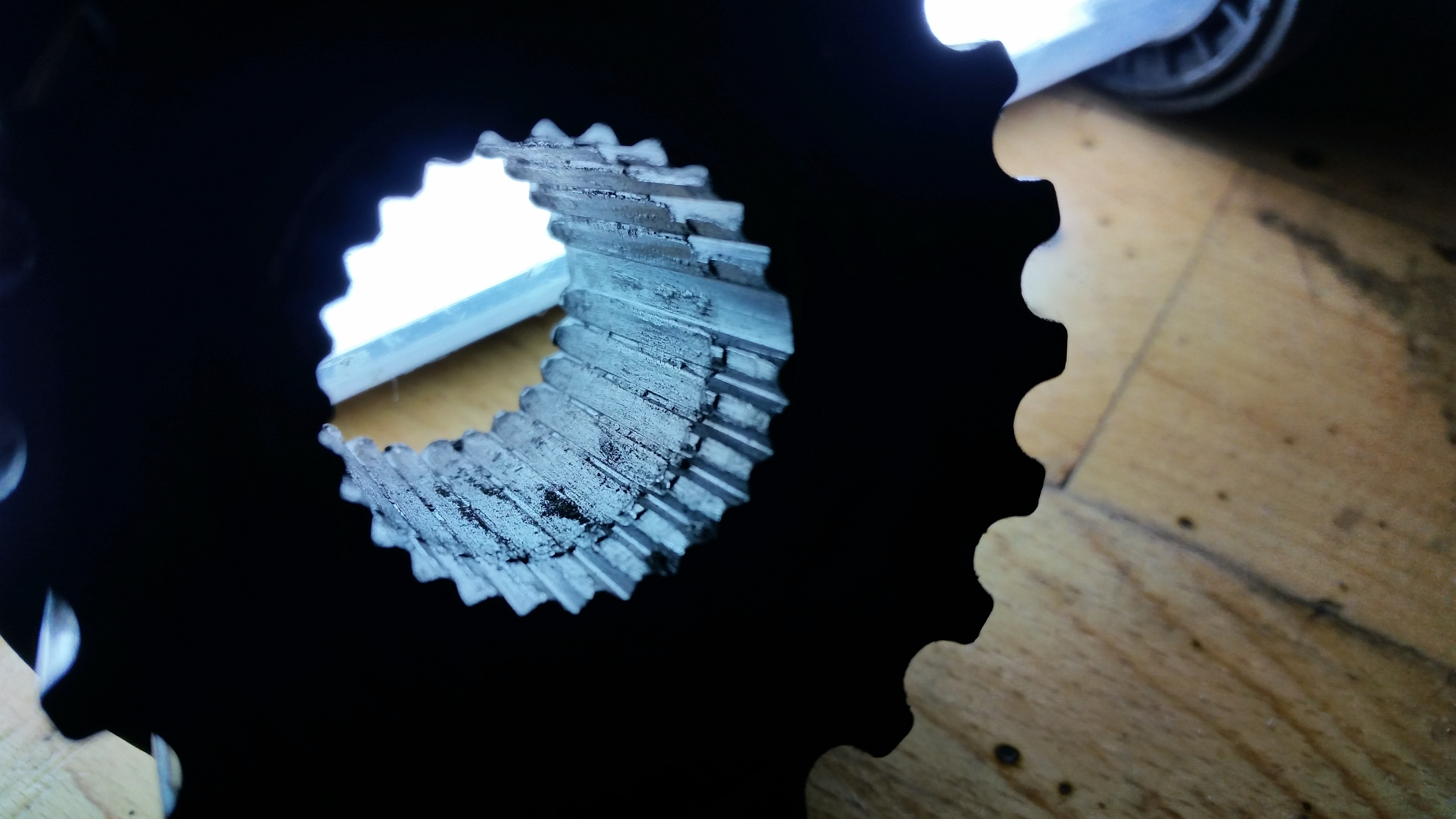

Have you carefully checked the crankshaft timing belt pulley inside splines? They can become stripped out and allow the pulley to rotate some on the crank. Timing marks on pulley may look correct but the crank it not in the correct position if the pulley has rotated some. The splines can look okay just viewing them while the pulley is on the crank but look at the photos and you'll see the splines are stripped internally back from the end of the timing belt pulley. You have to pull it off to get a good at the condition of the splines. A crank locking tool may help confirm this type of problem although I've never used one.FREEBUSINESSES wrote: 27 Sep 2020, 09:56 Simply amazing so many people have had the same issue, yet none post what the solution was, other than one good thread where he gave up and swapped out engine. LOL How sad, all these years, all these same problems, all these forums, and no solutions.

I had the problem but didn't run the engine, it was out of phase during a belt and cam seal job.FREEBUSINESSES wrote: 27 Sep 2020, 09:56 Simply amazing so many people have had the same issue, yet none post what the solution was, other than one good thread where he gave up and swapped out engine. LOL How sad, all these years, all these same problems, all these forums, and no solutions.
more recently the crank pulley retaining nut vanished and allowed the pulley to wobble freely on the crankshaft.
new pulley and nut fixed that near disaster.
I would say yours is completely out of phase and agree you ought to check the crank pulley.
Remove pulley and inspect crankshaft splines. I always seem to have to dig deeper to reach the sunlight.

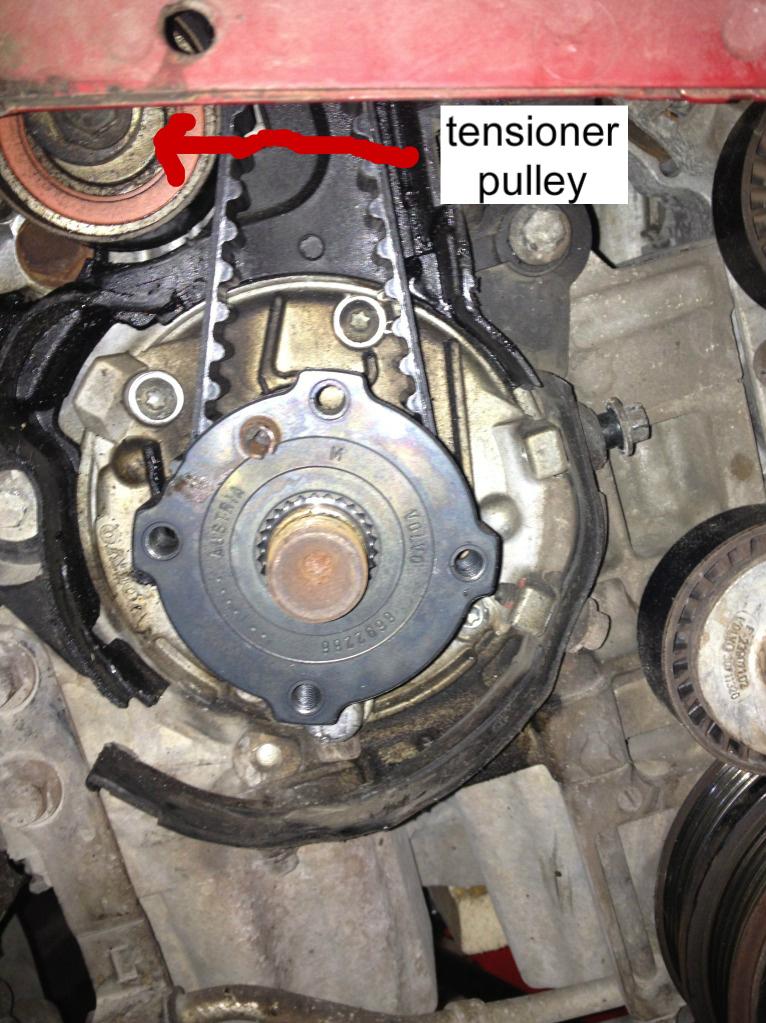

Any pictures of crank pulley when set to proper timing mark, this would show relationship of the four bolts in relation to crank pulley rather than pulling of crank pulley. Eyeballed it, looks fine outside, but looking at that crank pulley in picture, amazing, would not believe it if I didn't see it, but that happened due to missing bolt as it sounds like what happened.

The notch on the crank pulley goes on the nub on the block. Very simple.
The cam lock tool ensures the cams are in the correct phase. Given you starting with an engine that has been messed with , you need to start at the basic cam alignment with the cam tool
