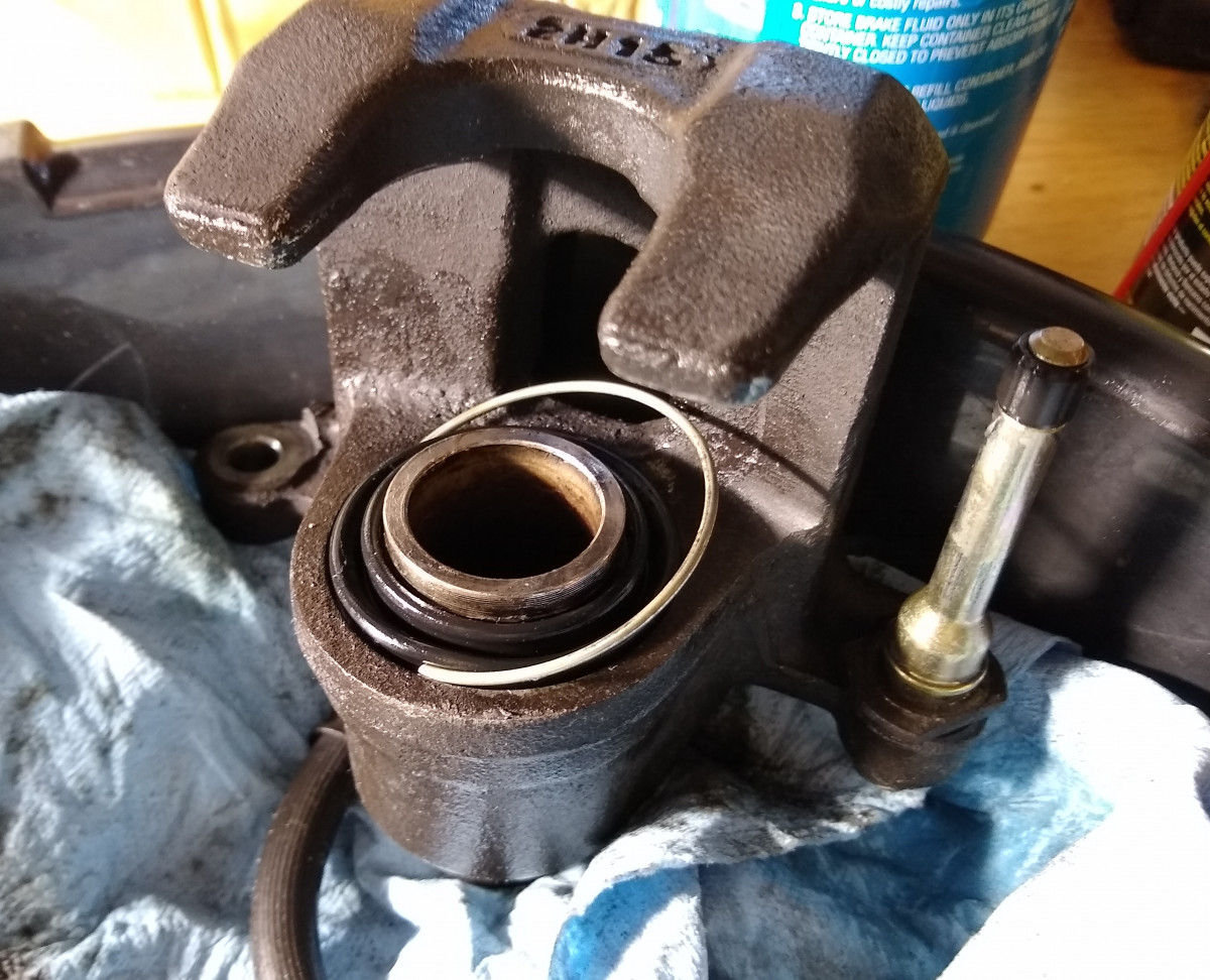

Well, the P2 was PO'd as the O3 Odyssey sat for 3 months or was that 4 in my folks garage so I couldn't get its control arms bushings started. Yes, still haven't clear enough room in my garage to do any short term work since moving in 5 years ago. Last hurtle was to inspect and potentially rebuild the calipers. Who does "parking" brake shoes anymore, that's another part of this saga. Wait, spoke too soon, I think the S80... If anyone decides to rebuild calipers they are not all created equal.
First, the good. The Odyssey pistons were still highly polished so no sanding of the caliper bore nor replacement kit needed. Was able to pull it out of the dust cover but the bad was being unable to get it back in through the small opening. Second, and getting worse, thought the dust boots were somehow pressed into the caliper. Looked seamless, spent hours trying all sorts of methods, crafting tools to return the piston into the small opening till... I really did cleaned and examined everything and didn't see the split, besides it was seated in there like it was part of the caliper. These high tolerance Japanese engineers. The ring is really smaller than it looks in the picture
. Thanks for letting me digress.
Will resume the control arms bushings rebuild programing soon.
