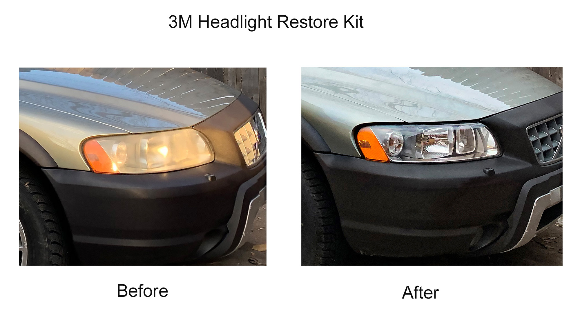

Today was headlight day. There's a Volvo recycler only an hour away, so I went shopping. Purchased a used headlight and restored it, along with the good one. You can see the passenger side in the attached pic, what a difference! I am going to purchase Magic Eraser's, can use them on other parts of the car.

Those turned out exceptional, good as new. Looks better than the Odyssey that I did. Hope my C30 headlights will turn out that good. My son will be happy to see your results. We intend to do those during the holidays coming up. Thanks for putting up the photo.photoguy wrote: 18 Nov 2020, 21:40MoVolvos wrote: 17 Nov 2020, 18:44

I'm very pleased, really having good luck with the 3M kit, coming up on three years since I did the Rover lights and still look great. I'd say they came out looking 90% new. Here's a "before & after". I took my time, spent about an hour on each light.MoVolvos wrote: 19 Nov 2020, 11:55Those turned out exceptional, good as new. Looks better than the Odyssey that I did. Hope my C30 headlights will turn out that good. My son will be happy to see your results. We intend to do those during the holidays coming up. Thanks for putting up the photo.photoguy wrote: 18 Nov 2020, 21:40MoVolvos wrote: 17 Nov 2020, 18:44

Brand New! Which Kit?photoguy wrote: 20 Nov 2020, 09:03I'm very pleased, really having good luck with the 3M kit, coming up on three years since I did the Rover lights and still look great. I'd say they came out looking 90% new. Here's a "before & after". I took my time, spent about an hour on each light.MoVolvos wrote: 19 Nov 2020, 11:55Those turned out exceptional, good as new. Looks better than the Odyssey that I did. Hope my C30 headlights will turn out that good. My son will be happy to see your results. We intend to do those during the holidays coming up. Thanks for putting up the photo.photoguy wrote: 18 Nov 2020, 21:40

Here's the Amazon link. I stupidly paid more locally, didn't realize Amazon was much cheaper. This is the only kit I have experience with, I'm sure there's comparable ones.
