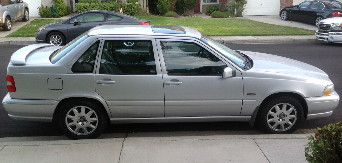

Had a set of 15" Bridgestone Potenza's on my 98 S70 T5 in 2012. I believe they were around $200 for the 01 V70 rims and tires which had 1K miles on it. Met owner at Costco and he had them balanced before handing them over. They were very comfortable in the beginning but after two years they were wearing very quickly. I estimated them to be 25K and at best 30K tires. My experience with Bridgestones is that they wear out much earlier than the tire Rating. Donated the car before the tires wore out.
Just purchased a set of 225/60/16 Defender T + H for the 03 Odyssey today. Costco's $150 off expired end of day Nov 30th. I called Discount Tire yesterday and they matched the price but I opted to pay an additional $80 for their Non-Prorated free replacement Road Hazard Warranty. Out the door was around $595.00. I purchased their Road Hazard for both the 19 Atlas Conti ($100) and 03 S80 T6 Goodyear ($80) even though neither sets were purchased from them. As long as they are in newer condition and they balance out they will sell you the Warranty.
A word of caution. When I arrived 3 of the 4 Defender T + H tires had a DOT Date of (15/19 or Manufactured on the 15th week of 2019) and 1 with (40/20). I asked for the Date when they called and the sale associate said they should all be 2020 tires. Long story short, I was going to leave and just wait for another sale but he had the Manager called their supplier to get another 3 (40/20) tires. At no time did they hard sell me or complained but was for sure not going to have me walk out without a sale. Excellent customer service.
This replaced a set of Michelins I purchased back in 2015 from America Tires. Got 49K out of the rated 60K and could probably go another 5K but winter is here. Tires almost never reach the rated mileage regardless. I keep all my tires at 42 PSI (44 PSI Max Cold) and align as needed. The old set had super even wear. The new Defender T + H made the van look really good (really?) and of course drives very nicely.
Lastly, we have a set of newer Goodyear Assurance Fuel Max P225/50R17 94V on our 03 S80 T6. It came with the car and is a decent tire. Good stability, especially on the freeway but is not as quiet nor corner as well as the Michelins. The C30 T5 has the Michelin PILOT SPORT A/S 3+ 215/45ZR18 from Costco. Little stiff but son likes the quiet ride and performance.

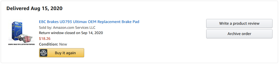

By the way Paul, put on another set of EBC rear brakes (pads), this time on the 03 Odyssey and there is a noticeable difference in stopping power. Bias towards the rear so less dive during stop. Good providence again as the last set was $18 and it went up to $70 for the new stock. The front set (rotor and pads) still working great on the C30.
