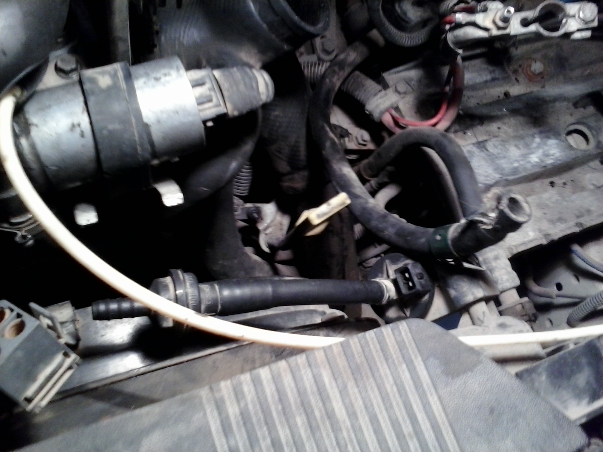

This shows a larger-diameter hose coming up just behind the radiator, from below the air intake housing, and it appears to run back under the car. I assume it somehow connects to one of the two valves shown in the picture, but the hose doesn't seem to bend in a way that would fit.

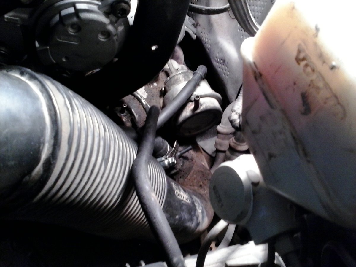

This shows one nipple on the intake manifold below the vacuum tree. It also shows two hoses connected, but I am not sure they are placed properly. The diagram shows that one hose should lead from this point to the check valve, which I think is in the bottom right hand corner of the picture, but the nipples are of different diameters.

That larger loose hose in the middle picture looks like the brake booster hose that travels under the air box. It connects to the brass elbow on the front of the intake under the IAC.

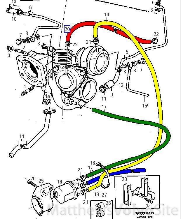

I think I can help with picture # 1
# 1 I believe is for the boost gauge in the instrument cluster
# 2 Is hose 19 in this picture and runs to the TCV
TCV to Turbo.jpg (137.98 KiB) Viewed 5372 times
# 3 Is part of the PCV system. You should have a hose run from # 3 all the way to the passenger side of the intake manifold. The arrow is pointing to where that hose should connect to.

Nice, where does that BLUE line go?
On the #3 in the pic, that hose is actually lying across the #2 valve. It comes TO LONG in the PCV kit, also, the end is usually to large to fit on the PTC fitting. I usually pull the end off, trim about 1 inch off of the hard plastic tube, then put a silicone tube on the end of it to connect it to the PTC nipple.

Blue hose should run up to the fresh air pipe that goes from the air box down to the turbo.

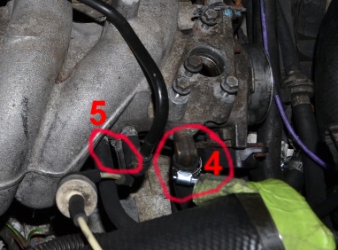

rspi: Please remember I'm a novice: What does IAC stand for? I found the brass coupling where the hose you labeled #4 should connect, but it pretty much disintegrated in my hand while trying to connect it. Meanwhile, is there a hose that is supposed to go between #5 and the intake manifold? I might be missing that.
Polskamafia: Thanks for the diagram. You state that the blue hose runs to the fresh air pipe. I am not finding a nipple to connect it to on that pipe. Can you tell me where it should be and/or provide a photo? Same for the red hose; where does it connect? I don't see any likely connectors back there. And where does the bracket #23 in the diagram go?
