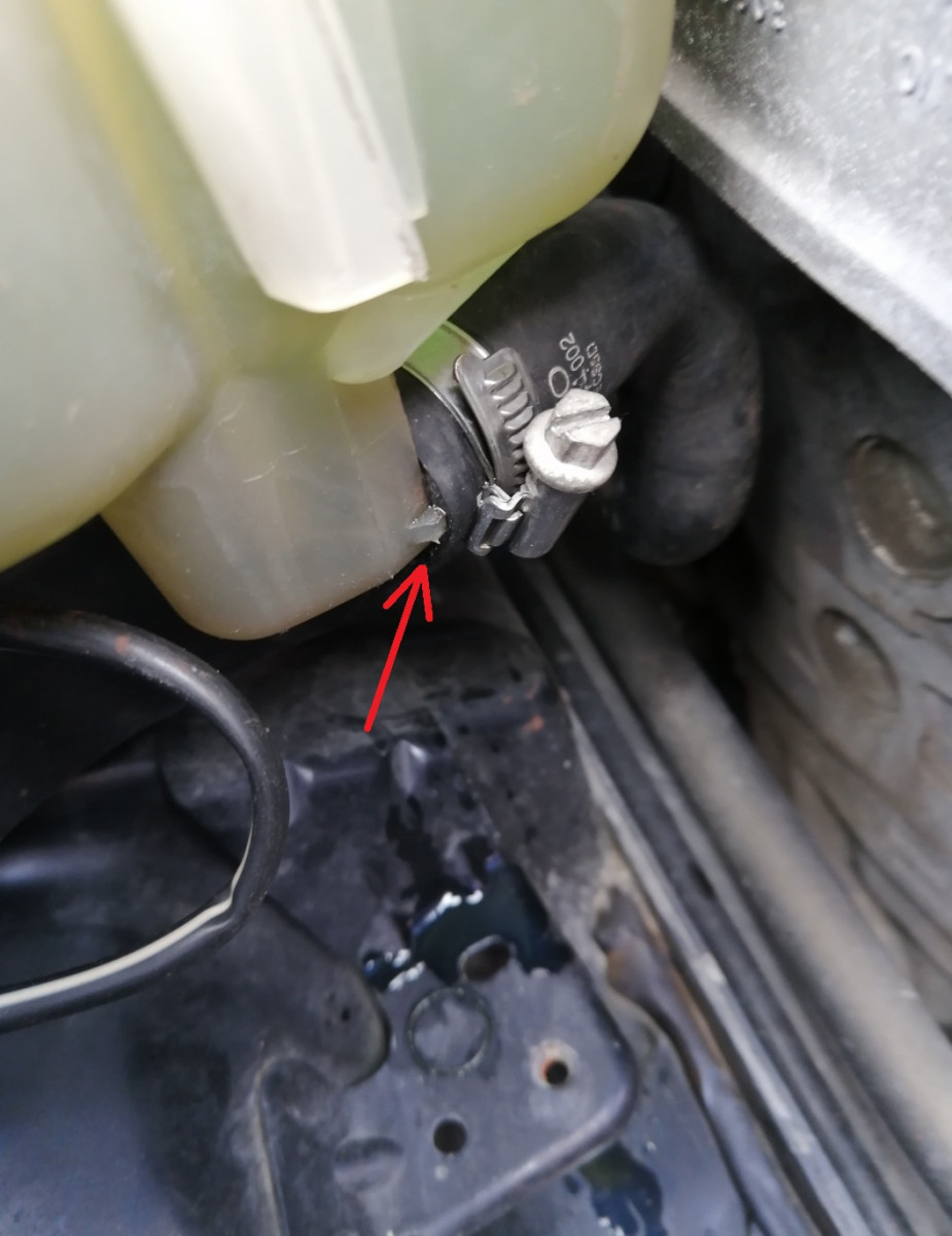

Hi Guys,
I need to replace my Coolant Reservoir (XC90 3.2) :cry:
I was checking the Dorman Coolant Recovery Tank (OE Solutions) 603-667.
Do any of you has use this part before? What's your experience.
PLEASE dont reply buy the original Volvo.
https://www.ebay.com/itm/Coolant-Recove ... 3182153588
This thing is leaking from here. I have tightened that clamp but it is still dripping water. I assume the plastic is cracked.
Thx & Rgds
2008 VOLVO XC90 3.2L AWD

It may also be a crack in the hose, if you, just chop 1in off it
I seem to remember an owner having had trouble with a new dorman reservoir, then he went genuine. Why not trying a used genuine off Ebay or junkyard
