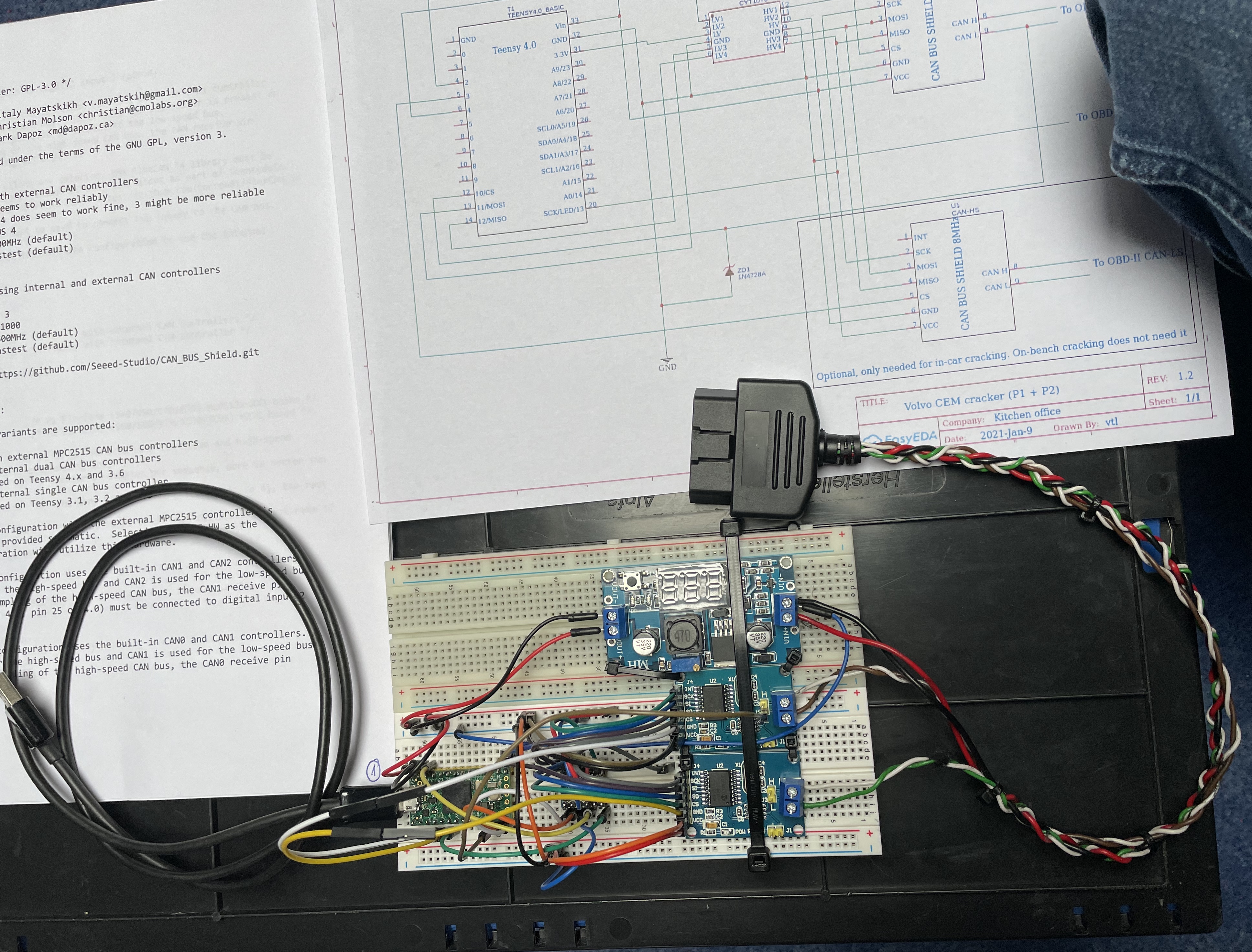

So I put power back to that terminal and it started talking again although doing the same thing as before. I even added the LS-CAN connections to see if that made any difference. I also have it powering on with the CEM from a single switched supply.
Should I be running the teensy at any specific frequency via the CPU speed option on the Arduino IDE?
Going to keep chipping away at it, I feel like I'm close.
