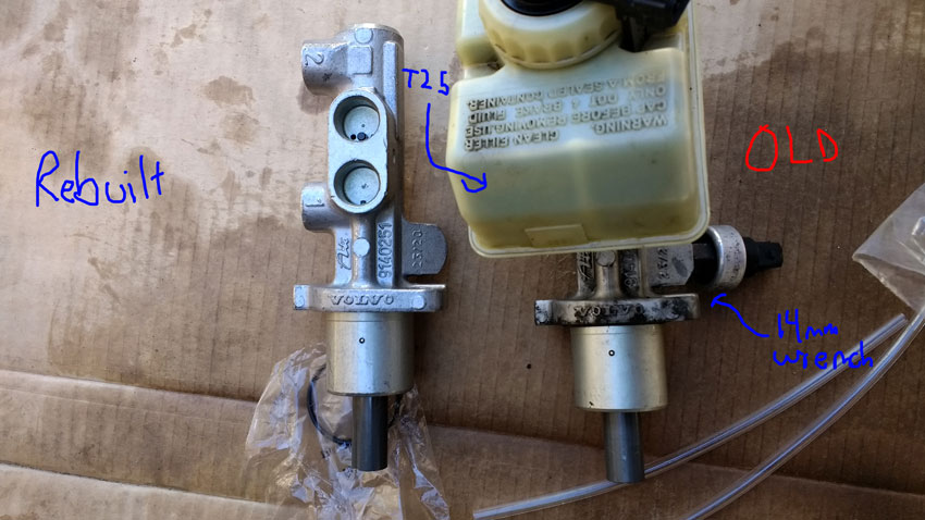

1. Identify the correct master cylinder.... Not as easy as it should be. Look at the nuts that screw into your master cylinder. If they are both the same size (11mm) then you need to order the master cylinder for cars without TRACS. If you have an 11mm nut (facing the front of the car) and another one that's larger towards the firewall, than you need to order the TRACS model master cylinder.
There are two master cylinders available from our usual parts suppliers. One is for cars with TRACS and one is for cars without TRACS.

I have had four of these in hand (including my busted one) so I spent some time looking at these two variations. Here is the only difference between the two...
I had mistakenly thought that this was a remanufacturing error. But it wasn't... It was a listing error. And information error!

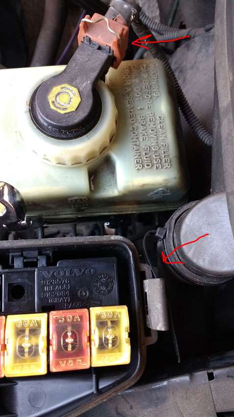

2. Disconnect the brake pressure sensor electric connector, disconnect the (brake fluid sensor?) wire on top of the master cylinder. And move the relay box away. The extra room will be welcomed!

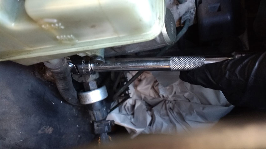

5. Crack the brake lines with a flare nut wrench. I used these great little Gearwrench Metric flex flare nut wrenches. The 11mm worked great. It flexed just enough to allow me to crack the nut without banging against the reservoir. Here's a picture of when I installed the new (wrong) master cylinder. I wouldn't remove the lines entirely until the bolts are removed so you can try to quickly remove it and quickly get the new master cylinder in there.

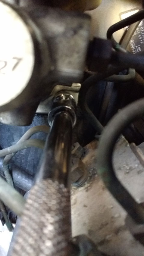

6. 13mm flex sockets will be your friend. Along with a six-inch extension, and a flex head 3/8 ratchet it's pretty easy to crack the bolts that secure the master cylinder to the brake booster. There are two bolts securing the master cylinder to the brake booster. I'm sure you could do this with short sockets and wobble sockets, but ever since I started using flex sockets stuff has just been so much easier. (I recommend a set of Metric Gearwrench Flex sockets.) NOTE: the napkins here are NOT ENOUGH.
7. OK, wiggle the old master cylinder out. It'll come out pretty easily. Try not to put to much stress on the brake lines. Once you have the old master cylinder out, swap some stuff over: take off the sensor with a 14mm combination wrench and disconnect the brake fluid reservoir by removing the T25 bolt that secures it. There are two gaskets that press into the master cylinder. They looked fine so I left them. I don't have any leaks right now so things should be alright...
8. Bolt the rebuilt master cylinder into the brake booster, but only hand thread it. Connect the brake line fitting closest to the firewall first. You'll have to move around the master cylinder in order to get the threads going. Take your time. It'll go in. Once you get it in, do the other. Again, take your time. Try not to put too much stress on the reservoir. This is why the flex head metric flare nut wrenches were really good here.
