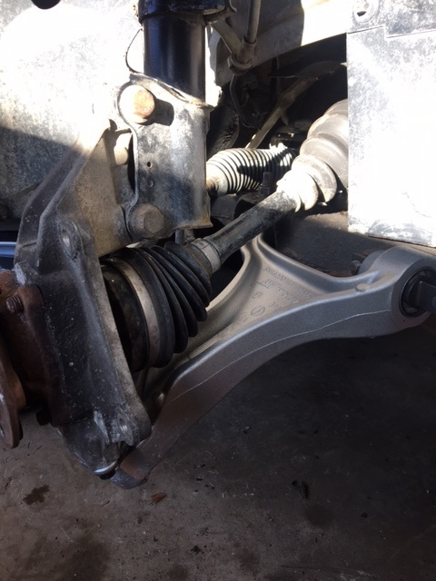

I just finished installing my Lower Control Arms and did new Ball Joints at the same time. I've read on several post of people taking several days to do this job so I thought I would provide some tips to make the job more doable and easy for those contemplating it. A little history: I replaced these parts with cheap aftermarket parts in the spring of this year and have had to do them again today because of poor quality parts so I am not dealing with rusty and difficult fasteners. I am replacing these with genuine Volvo parts. Total time for this job was 3:15 with hand tools.
- I loosened the lugs and axle 13mm bolt, then jacked front of car up and installed jack stands.
- remove wheels, rotor, backing plate, ABS wire, and caliper, wire tie the caliper to the strut spring out of the way. Loosen the tie rod end nut.
- Loosen the 21mm strut to knuckle nuts, then remove the Ball Joint nut. Then remove the strut bolts, push the axle through the knuckle, and push down on the hub/ knuckle assembly to move the strut out of the way. Remove the knuckle with the ball joint attached.
New BJ.jpg (109.8 KiB) Viewed 5400 times
- On the bench, remove the two ball joint bolts and use a brass drift and chisel to gently remove the ball joint from the knuckle. Clean the mounting area and bore with a wire brush.
- Install the new ball joint, I've done this twice and don't believe you need the special tool or a press. Just start the bolts and slowly allow them to move the ball joint into place.
- Removing and installing the control arms is pretty obvious, access to the front two bolts is possible with a box end wrench without having to lift the engine.
CA old.jpg (118.51 KiB) Viewed 5400 times
- After the control arm is in place and tight, put the knuckle and ball joint assembly in place and start the ball joint nut. Now you can use the knuckle and hub as a lever to push down on while you insert the axle and line up the strut bolts, you don't need any strapping devices or prybars when you do it this way.
- Reattach the rest of the parts in order they were removed, torquing along the way.
The first time I did this job I smashed my thumb when the pryer slipped, trying to push the control arm down to get the ball joint spindle in its hole. If you use the above method, there's no danger and you will not need to find a helper. You can change both the ball joints and control arms without removing the caliper and spindle but this method is much easier and safer.

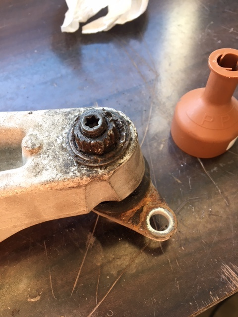

The other reason I elected to remove the spindle is because my last cheap set of balljoints has poor quality fasteners that stripped when I put them in. The nut had rounded such that the spindle and control arm couldn't be separated........yes those are pipe wrench teethmarks on the nut!
