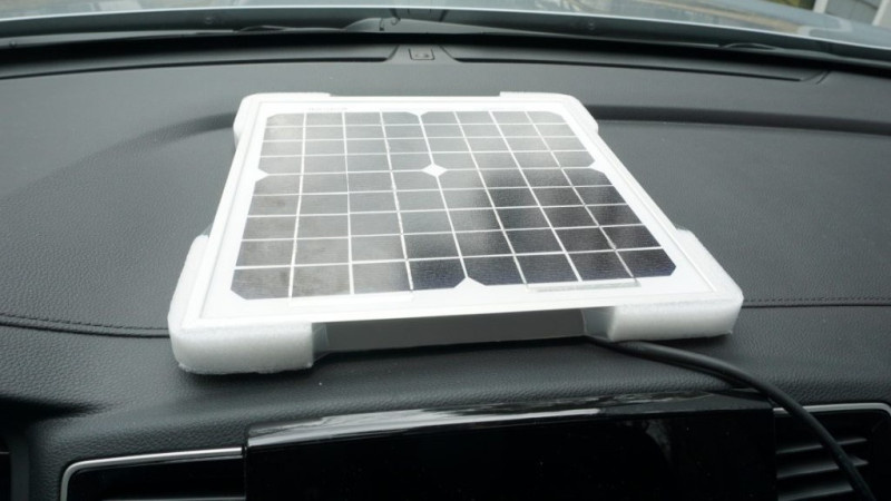

just park on a hill, or employ a team of strong men/women to help you push start the car. 11.9v is low, get a new battery.
An OBD2 trickle charger for the dash...hmm
obd2 charger
obd2 charger
obd2 charger.jpg (96.94 KiB) Viewed 1124 times

Yeah i've been looking online for one of those OB2 connectors and can't seem to find one that fits this car.. Also think i'll need to just bite it and get the new battery cause there is obviously not even enough power to keep my Garmin Nav on now. That went off on me the other day right in the middle of a trip and i had to pull over and use my phone one (Magic Earth).. Only the Garmin gives me the 'low battery' message while it is shutting off when i turn off the engine. The car dash gives me no message so far.
