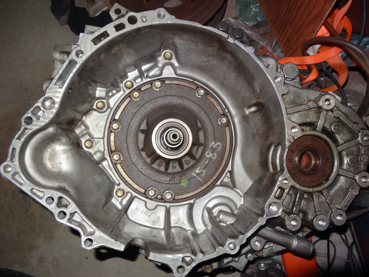

An update for all of you helpful people: I'm in the midst of round two. As money is an issue and I had some extra time, I got a used tranny with 118k on it and put it in. Took about 16 hours total, I'd say, to get the old one out and new one in. It didn't work--flaring really bad going into gear, etc. I had put a new B4 servo cover on, changed the front seal, and got some rebuilt solenoids that I put in. Don't know if somehow something I did messed it up or if it had a plugged up internal filter...
Anyways, the wrecker honored their warranty and gave me another one. I'm about to put it in the car. I didn't change the solenoids this time or the B4 servo cover, in fear those somehow messed it up. I did change the front seal. We'll hope round two is a charm! Any bits of advice on how to make sure this one works?! Ha.
And FYI, for a NA 2003 V70, the correct transmission is an AW55-51SN.

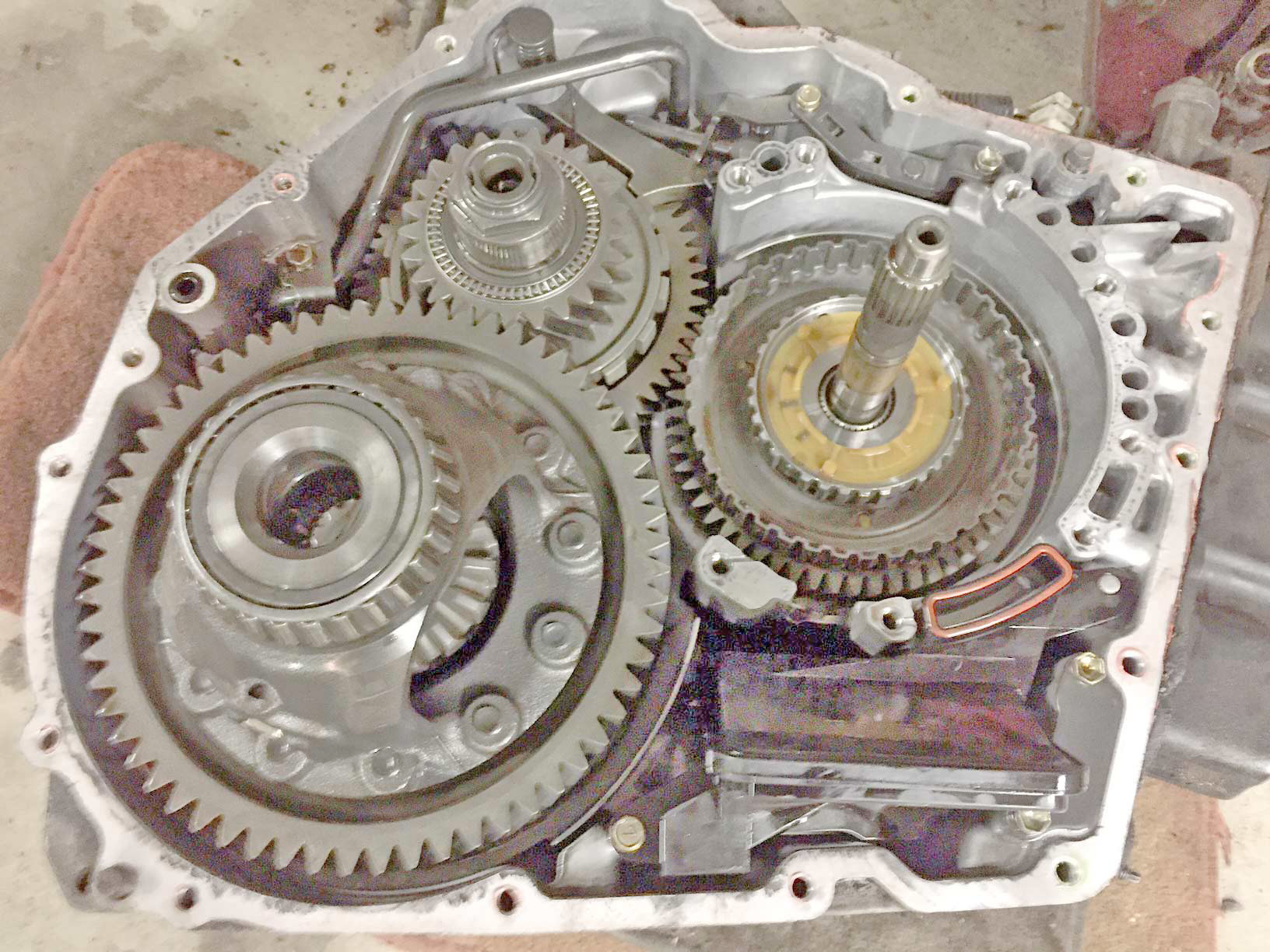

You might also consider pulling off the bellhousing side case, which is more work but gives you the opportunity to replace the filter and inspect the condition for part of the transmission. It involves removing ~15 bolts for the case, 8 bolts for the pump, tapping the case to separate, cleaning, resealing and reassembly. If you do decide to do this let me know as there are some things to make assembly easier and things to watch out for, such as not removing the pump or if removed align and engage the two clutch packs hubs prior to reinstalling pump/clutches assembly with the transmission upright.

Just to conclude here--the second used transmission is in the car and working perfectly. I spent a long time making sure the fluid was fully flushed and at exactly the correct level while the fluid was at 40 degrees C. Though I didn't take the plunge and remove the bellhousing side case, I'm confident everything is working right now. The second time went much faster than the first, for what it's worth...
