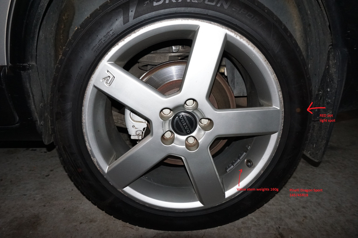

ive figured out why my rims needs so many weights around the standard rubber valve, the rims are designed for the heavier Tyre Pressure Sensors (not mandatory in Australia).
I assume P2 cars in the US have this fitted? ive read the Volvo ones warn you if the pressure gets down to 10PSI which is way too low.

That a lot of weight.
TPMS required in US since 2007... "the TREAD Act requires that all vehicles produced after September 1, 2007 be equipped with a tire pressure monitoring system."
https://www.moderntiredealer.com/articl ... st%20place.The average valve stem sensor weighs between 30 and 40 grams, or 1 to 1.5 ounces, a considerable amount from the balance perspective, especially since most tire and wheels are fairly close to "balanced" in the first place.
