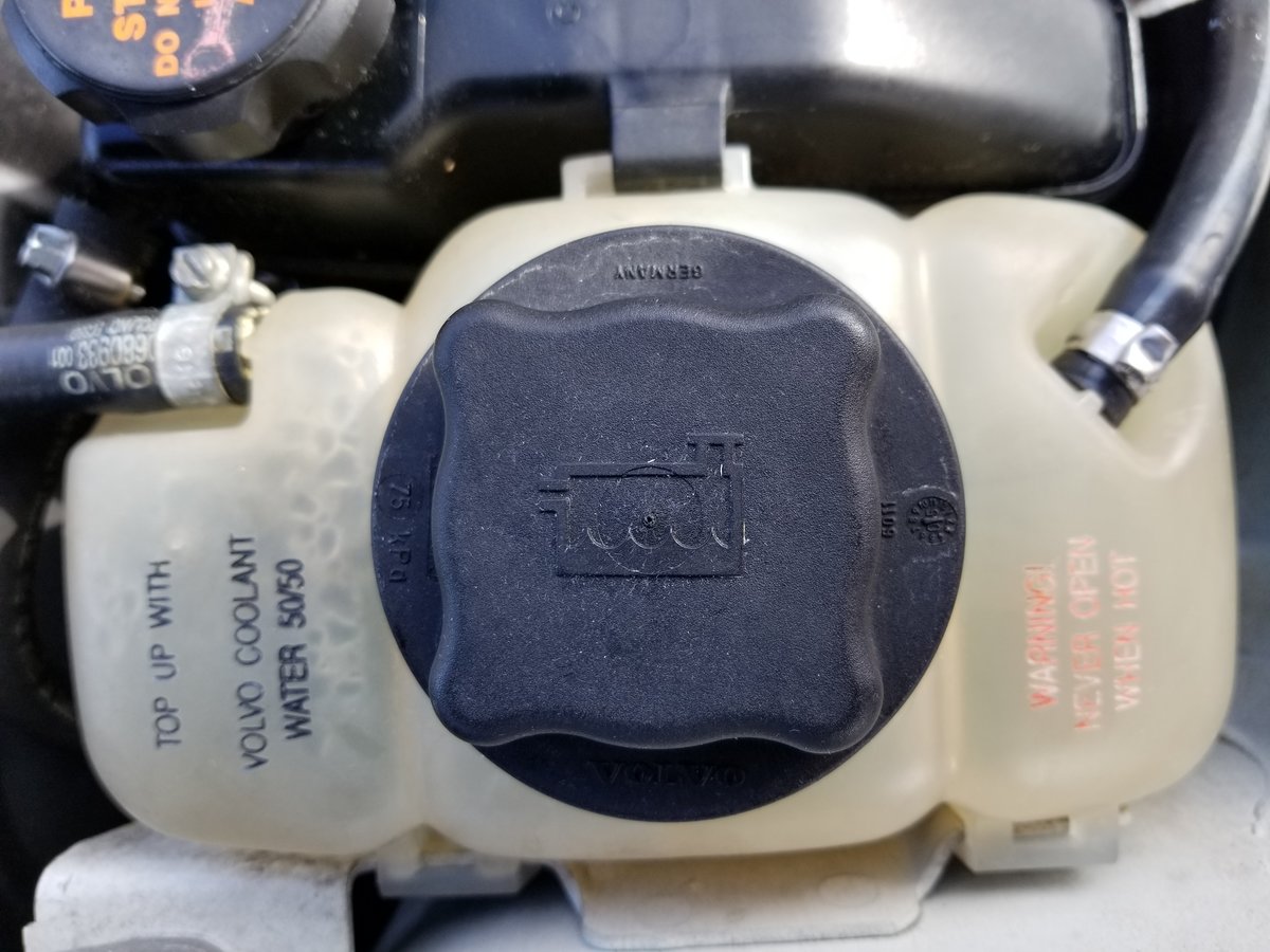

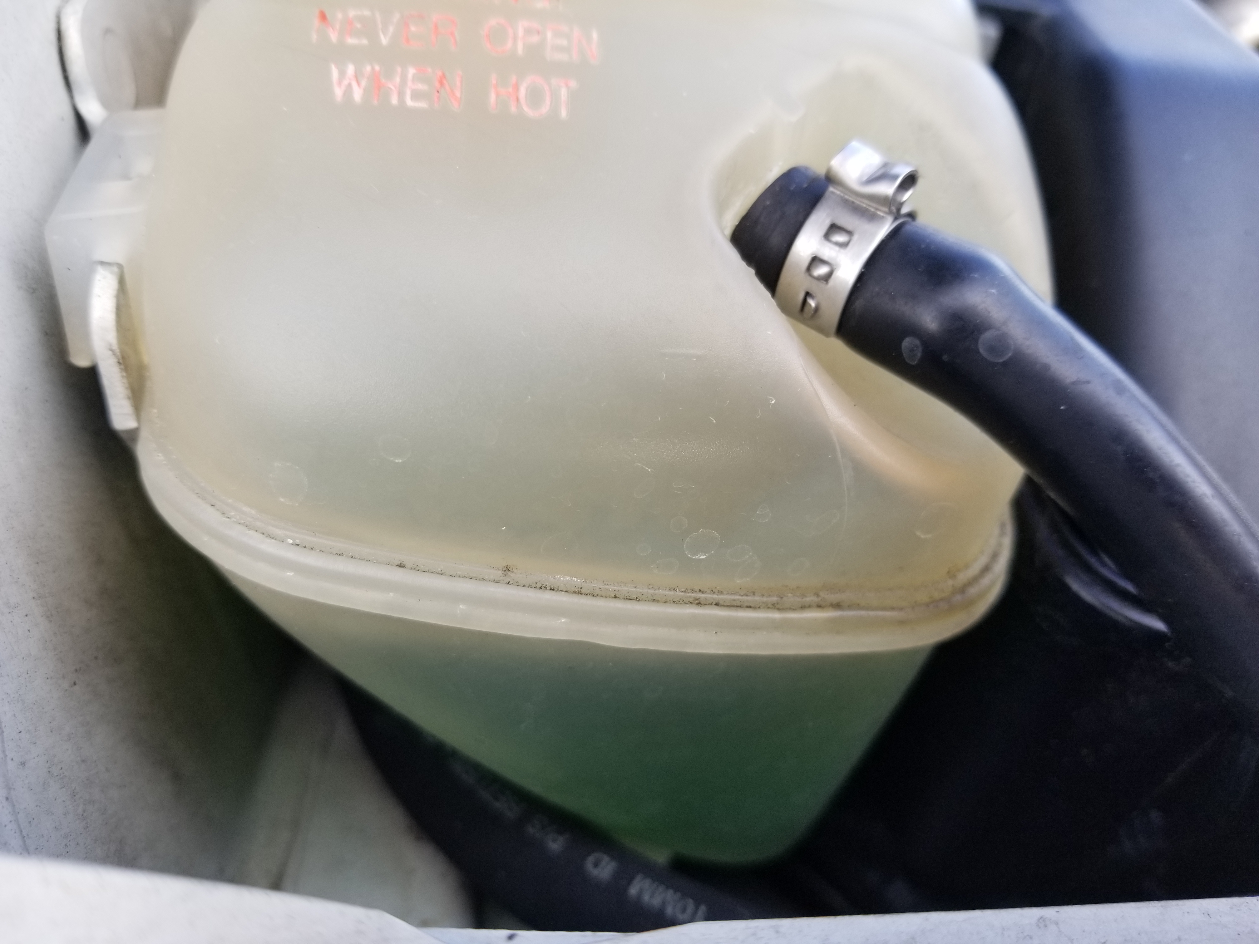

I've posted this before and keep in mind this advise came from a Volvo Master Technition who worked on mom's Volvos at the same dealer in the as far back as the 70s. My 98 V70 had endless seepage problems with the heater core. I owned the car from new until traded in fir a 2002 S80 so four years or so. After replacing the core, than the in dash piping later the coolant still was leaking enough to constantly smell through the vents. At that time he said they were having problems with the cars with the higher pressure radiator cap (green cap).
So he put the black cap on my car that went to a older model like the 240 which is half the pressure. It worked like a charm and before I drove the 2002 S80 T6 and the 2004 S80 T6 off the lot I went straight to the parts counter and bought the black 240 cap and tossed the factory green cap away. Every since I have experienced no heater core trouble or any overheating ever. I still am driving the 2004 S80 14 years later without issue. No coolant smell yet in the heater.
So I suggest replacing the cap with a black cap at the same time. One of the moderators figured the math on how much lower the boiling point with the less pressure and it was like a 20° difference still giving like a 260° rather than a 280° boiling point. Running a engine at 260° would be a catastrophe I'd predict. June
Added a couple photos of the tank which is factory still and notice clean after all these years and 151K.
