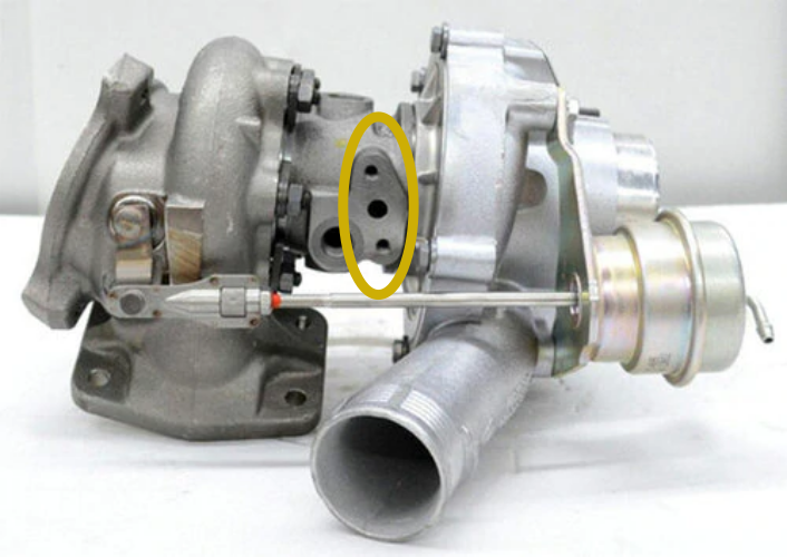

Does anyone know if there is supposed to be a gasket between the oil feed line and the turbo? (area in question circled in yellow)
If so, could someone get by using just Aerobic sealant?

Yes, its a green paper type gasket.
I broke mine installing it, got a new one from a dealership.
Don't know if sealant will work, it might not be machined to the same clearance as the head.

Ok cool thank you. I put it on without gasket and developed small leak. Looks like Imma need to locate a gasket.

I’ve got some extras. Pm me an address and I’ll pop it in US mail
That will stick it to the shipping cabal.
That’s the oil return line, by the way, and be careful with those screws, they are an oddball size, like M7 with a 6 mm hex head
