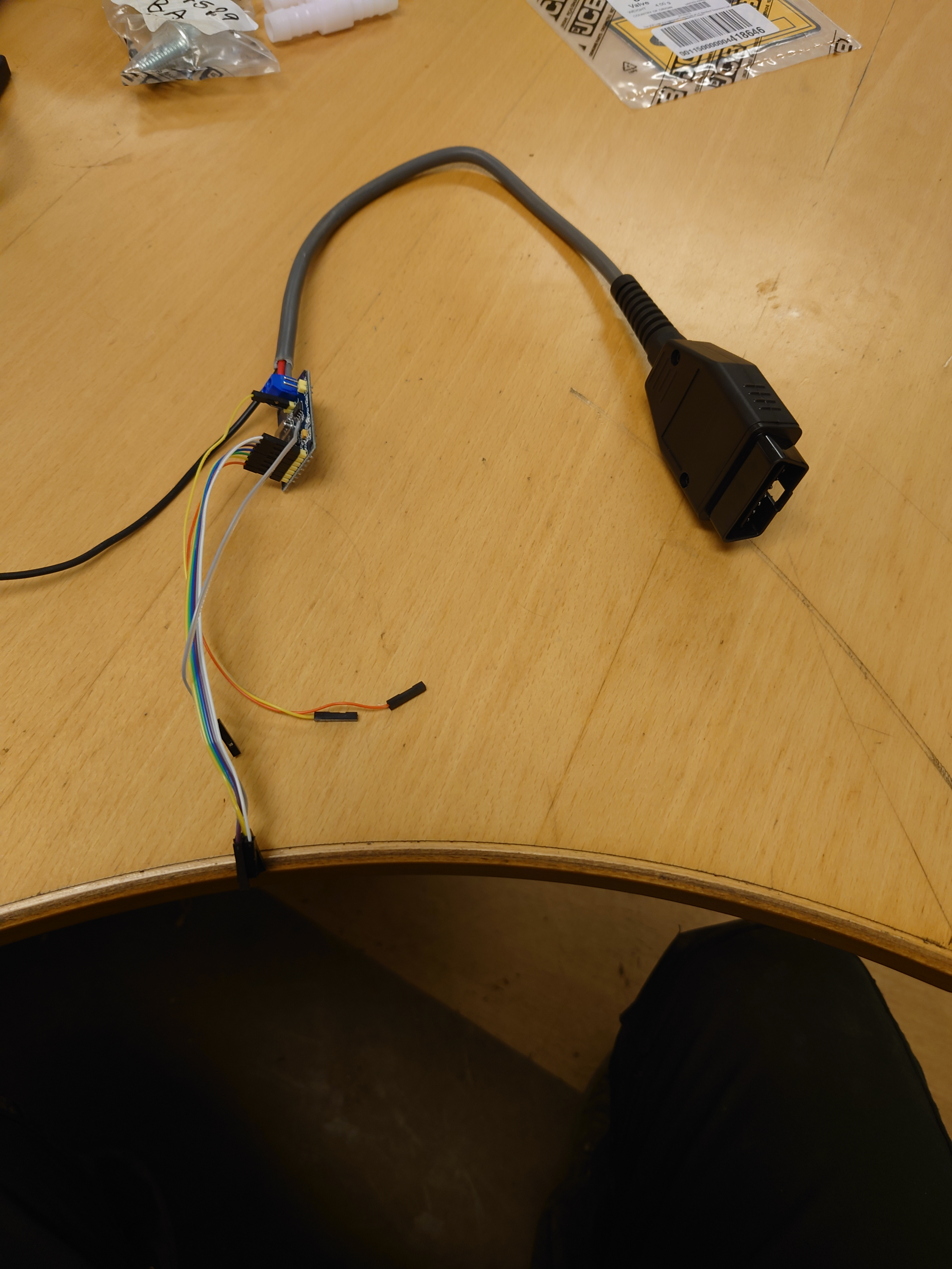

Hoppfully i get the box and teensy today. The rest off the build is waiting.
