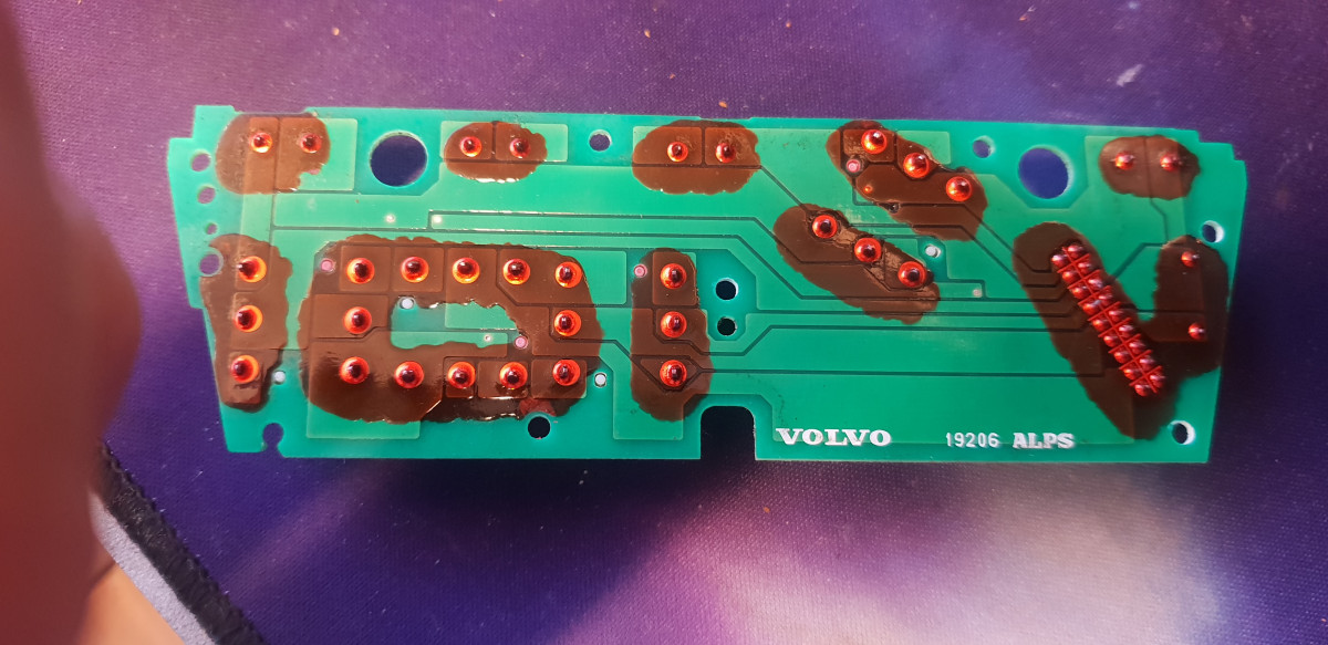

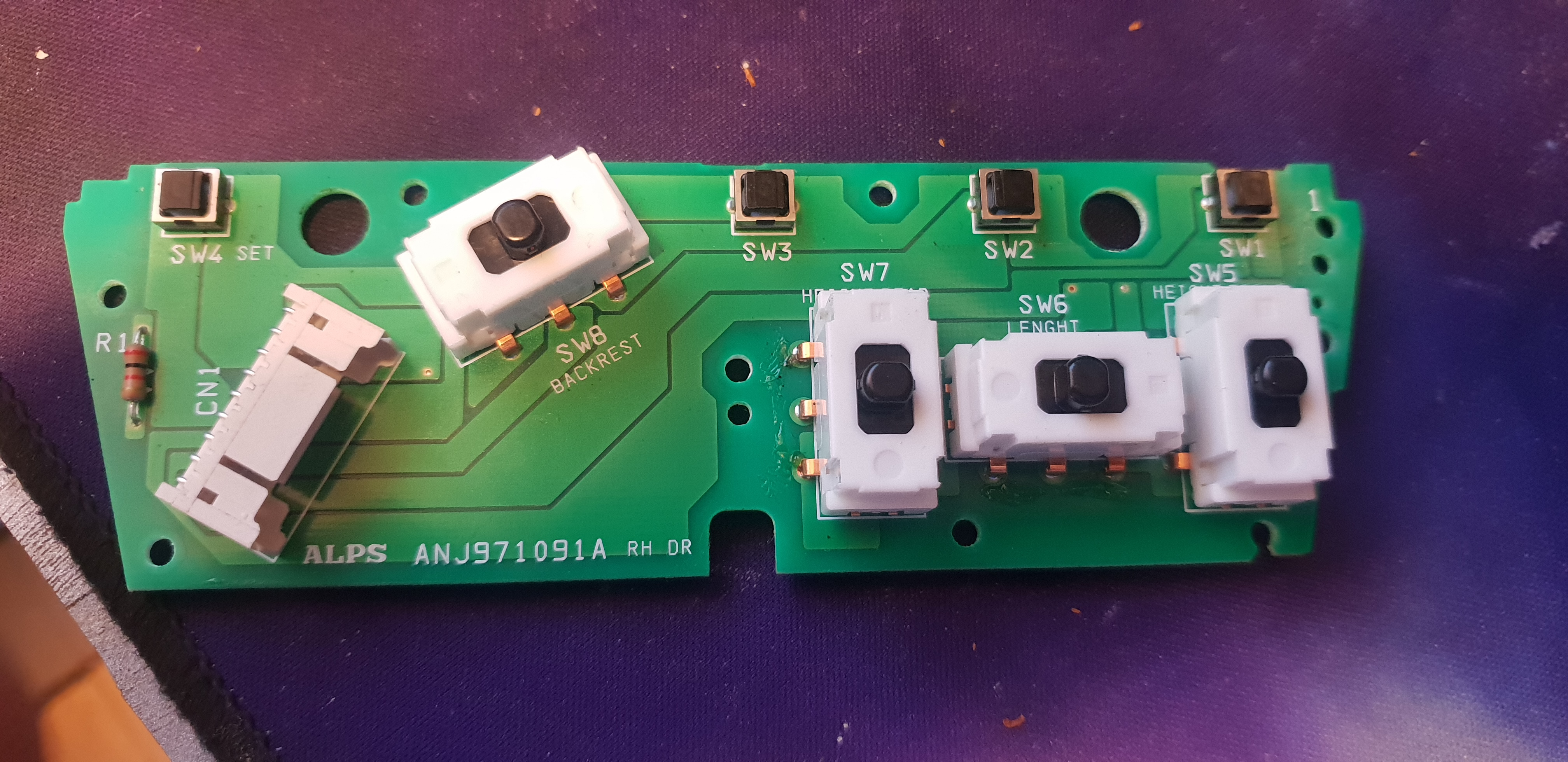

ive been looking at theses posts about powering the electric seat im trying to do the same with mine as mine was a manual seat i just cant get this power seat to move id like to wire it from the battery.any help would great as im am now at my wits end.heres a pic of the board for the switches.if you could show me where to put the wires on here or give me detailed description on how to do it that would be fantastic other wise ill have to get another manual seat .thanks.
- Posts: 35272
- Has thanked: 1497 times
- Been thanked: 3810 times
Hello Neil
The P2 model you have is very different. Those switches send control signals to a seat module which sends motor current
You will have to lift the seat out and find the motors and wire directly
