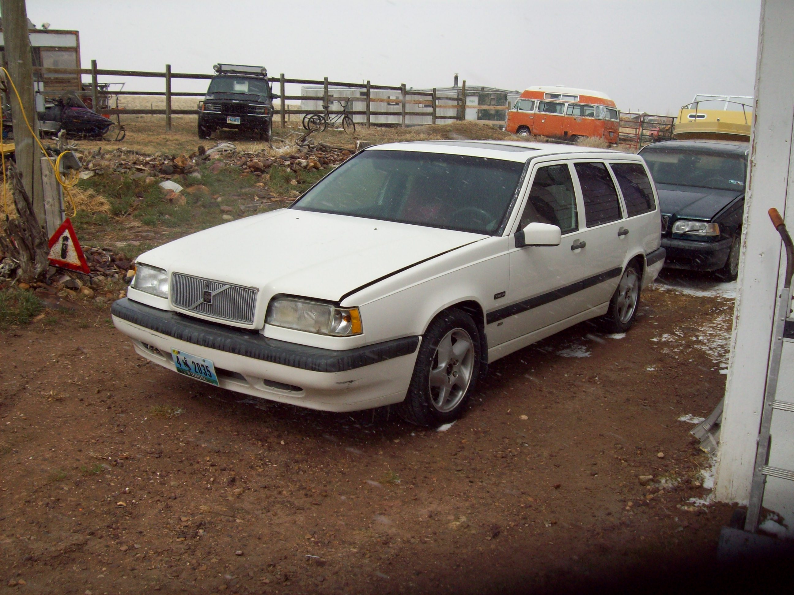

While the wiring is a mess on this project , I don't think this part has been hacked ,this car probably should have been parted , but it's a clean lo miles pre 2000 wagon , and I love em ! I just did timing belt , water pump ,pulleys etc, PCV next , I think she was worth rescuing . I think the missing dash would have scared some, but I found a 94 non Turbo parts car and salvaged the wiring harness and Dash assembly and More , It's been a good learning experience,sort of a 850 Baptism by fire ,makes me appreciate my Turbotweaked 745.
![Image]()

Cancel previous mayday...another problem solved and lesson learned ! these 2 sensors go on the bottom side of the passenger and driver ducting . I saw the location for the headliner trick tiny fans , those are kinda nutz ,teeny, tiny little fan motors ! I see why you thought the wiring was hacked , but alas these are not the ones you spoke of. Thanks again Matt's minionz [imghttp://www.volvotips.com/service-manual/volvo- ... ge_016.png][/img]
