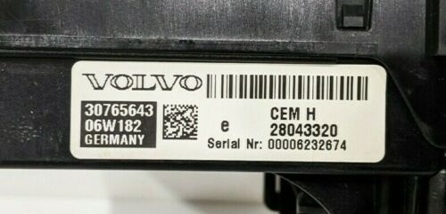

My 2005 XC90 T6 ( 2.9L twin turbo ) 30765643.
If enough people post information like this we might find a pattern.

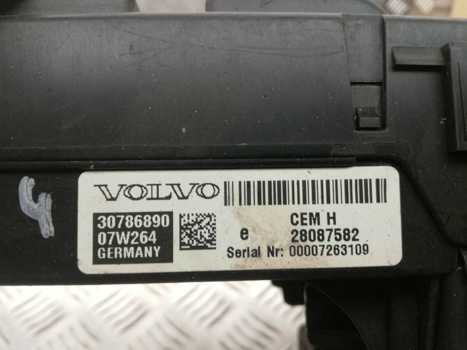

sparacis wrote: 14 Apr 2021, 12:23 Part Number: 000031254903
Another one for the CEM list.
esbekir
Posts: 3
Joined: 15 April 2021
Year and Model: 850R 1996
Location: turkey
Has thanked: 2 times
Post by esbekir »
hi.
xc90 d5 2008 auto p2 cem L
Serial No. 000007206358
Hardware number 0030786890 A
Diagnostic number 31376475 AA
Software number 0031376479 AA
Firmware number 0031376469 AC
Software number 0031376473 AB
Serial number sub ECU 705032000056
Serial number sub ECU 704072002018
RickHaleParker
Posts: 7129
Joined: 25 May 2015
Location: Kansas
Has thanked: 8 times
Been thanked: 958 times
Post by RickHaleParker »
esbekir wrote: 15 Apr 2021, 16:27 hi.
2008 XC90, D5244T3 or D5244T4, TF-80SC AWD, CEM-H 30786890.
30786890 is a CEM-H not a CEM-L
Quattrodag
Posts: 4
Joined: 27 March 2021
Year and Model: 2006, XC90
Location: Russia
Post by Quattrodag »
Мой 2006 XC90, B5254T2 (2,5AT) 30765643
RickHaleParker
Posts: 7129
Joined: 25 May 2015
Location: Kansas
Quattrodag wrote: 16 Apr 2021, 02:56 Мой 2006 XC90, B5254T2 (2,5AT) 30765643
Спасибо
2006 XC90, B5254T2, AW50/51 AWD, CEM-H 30765643.
