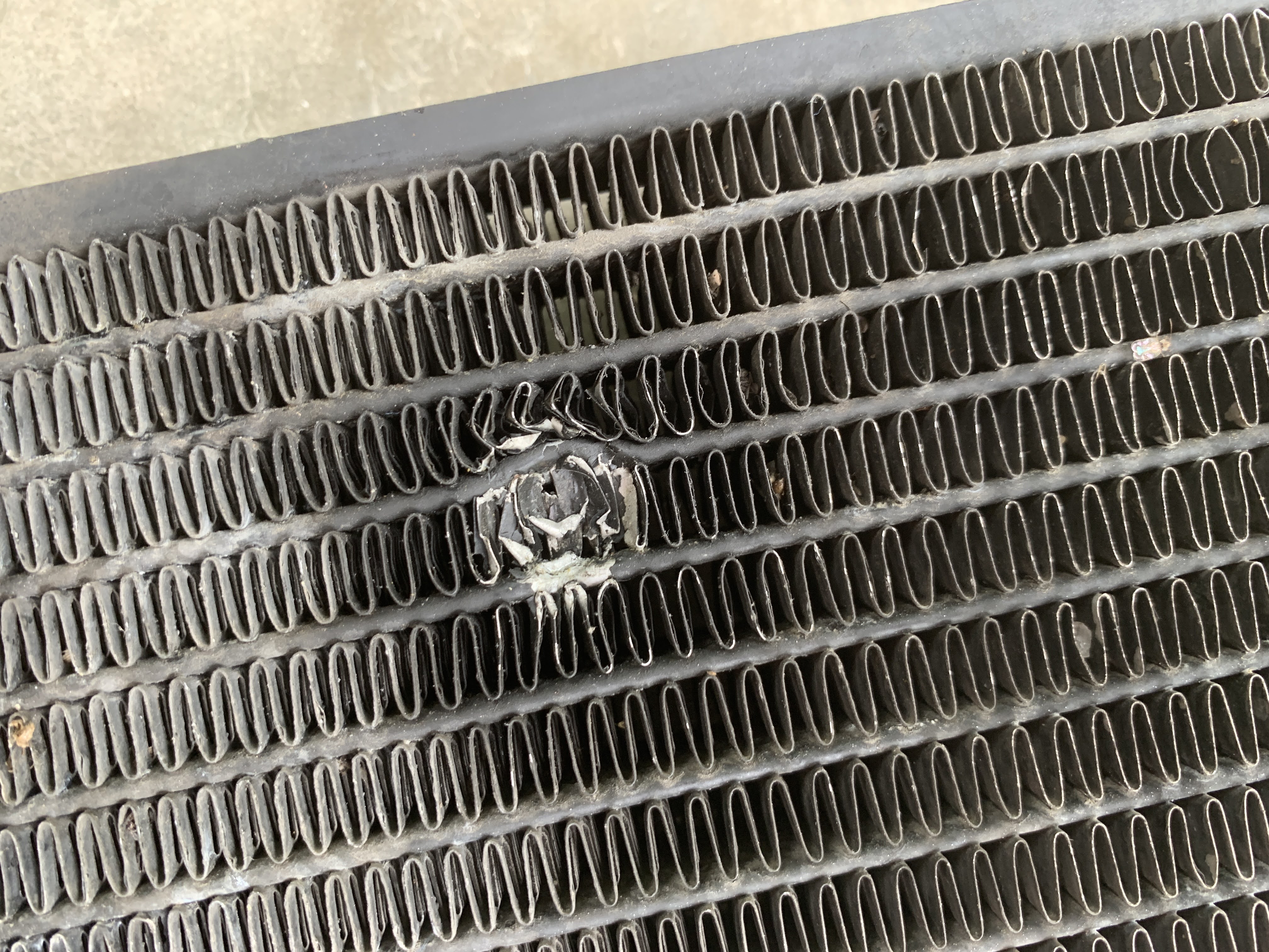

Replaced the AC condenser on the S70 today. I went to charge the AC last week and realized that there was a puncture from the collision. Fortunately it was very easy to stop right out without touching the radiator or intercooler. Just used a ratcheting 10mm to take off the lower screws, then a swivel socket on the top left, and a flex head ratcheting wrench on the top right. It's a little tight to access those, but not impossible.
Also bled the brakes, first time using my Motive power bleeder. I love this thing! Makes it so easy, and because you're not using air, there are no bubbles in the line to cause you to wonder if it's from the bleeding device or from air in the fluid.

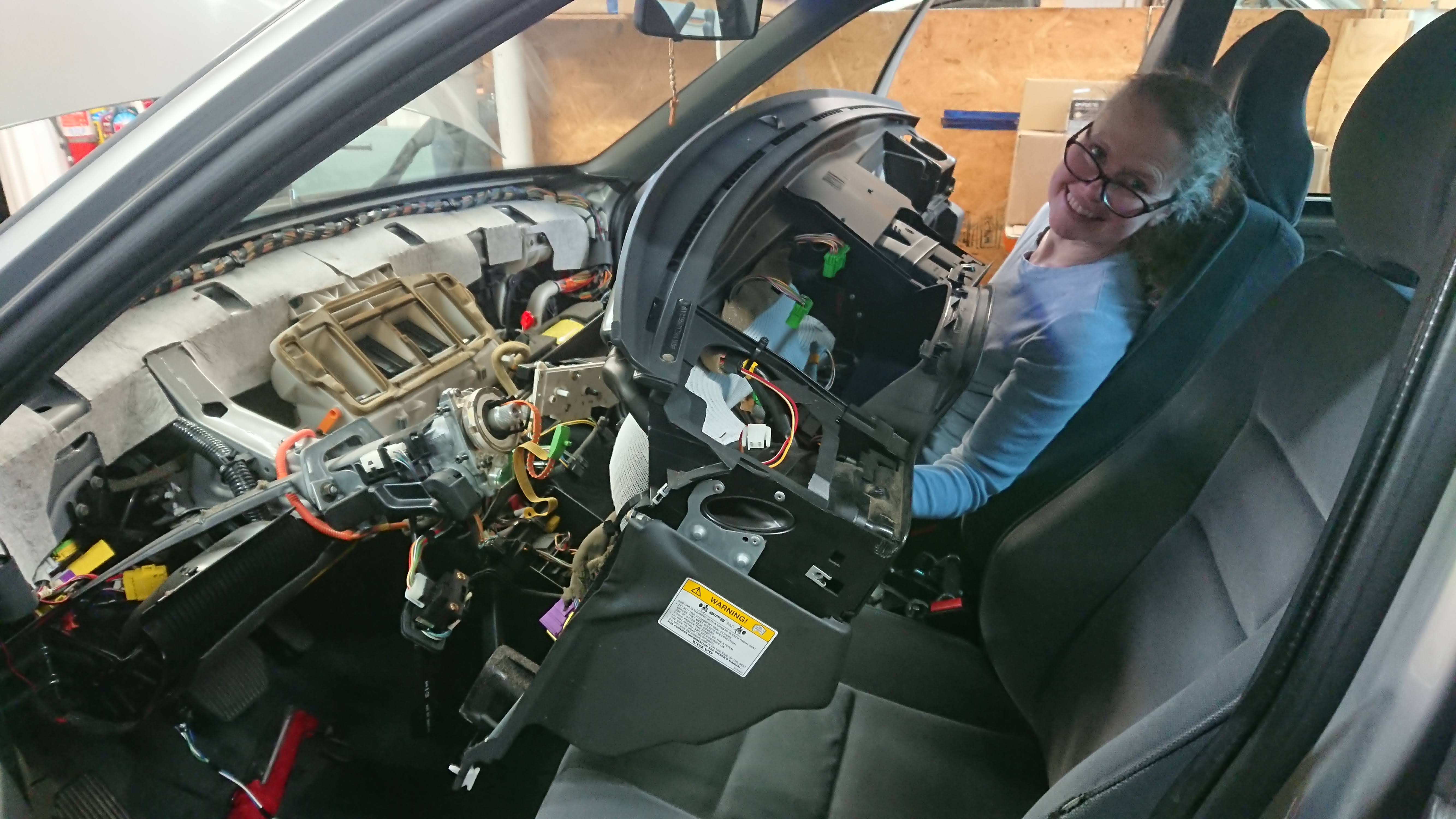

Evap time for "Harold" the 850. Honey, can you hold this for a sec?
58' Porsche Diesel Junior
13' Honda Odyssey
13' Honda Odyssey
- Posts: 35299
- Has thanked: 1505 times
- Been thanked: 3818 times
There are few things hotter than women holding a dashboard...are you good to go with vacuumpump and manifold or do we need to make plans?

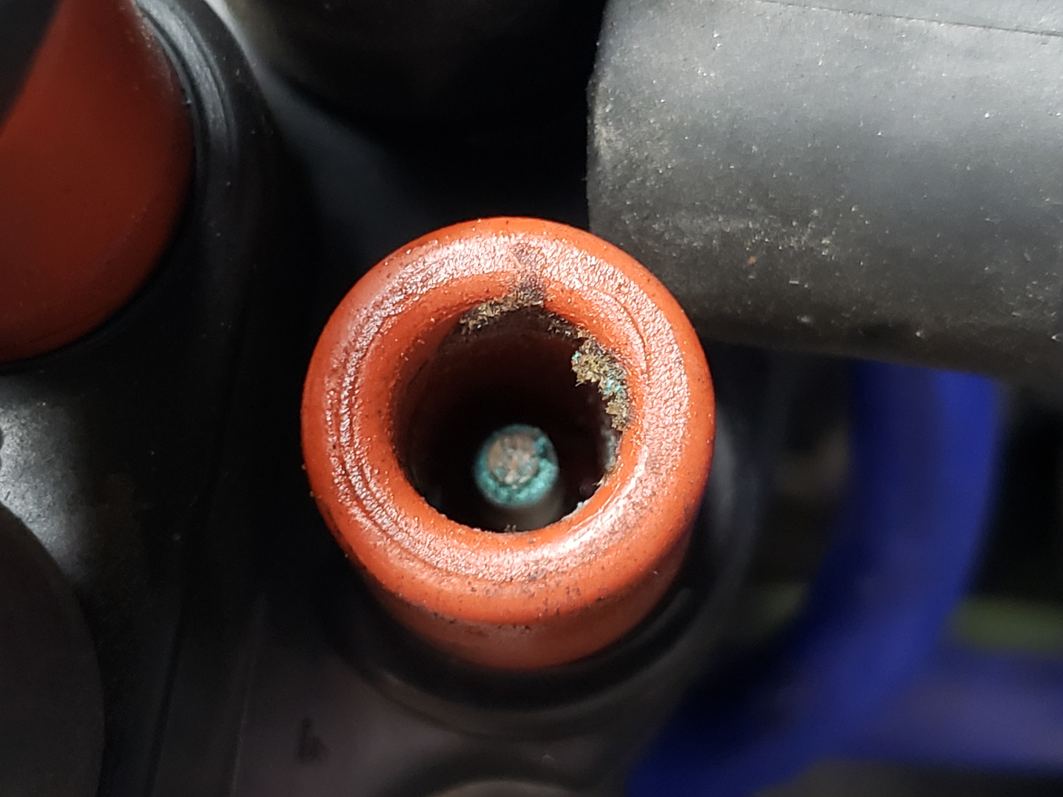

I think I found the misfire....
- Posts: 6338
- Joined: 30 December 2014
- Has thanked: 304 times
- Been thanked: 517 times
Eeew... that's pretty crusty!
- ZionXIX
- Posts: 1310
- Joined: 11 August 2014
- Location: Texas
- Has thanked: 65 times
- Been thanked: 194 times
2years and 8,000 miles. I have no idea how it got so corroded.
- foggydogg
- Posts: 2948
- Joined: 17 October 2009
- Has thanked: 83 times
- Been thanked: 402 times
Us Sailors call that stuff 'spooge'.
Double-check inside the cap; sometimes a steady miss can cause spark tracing.

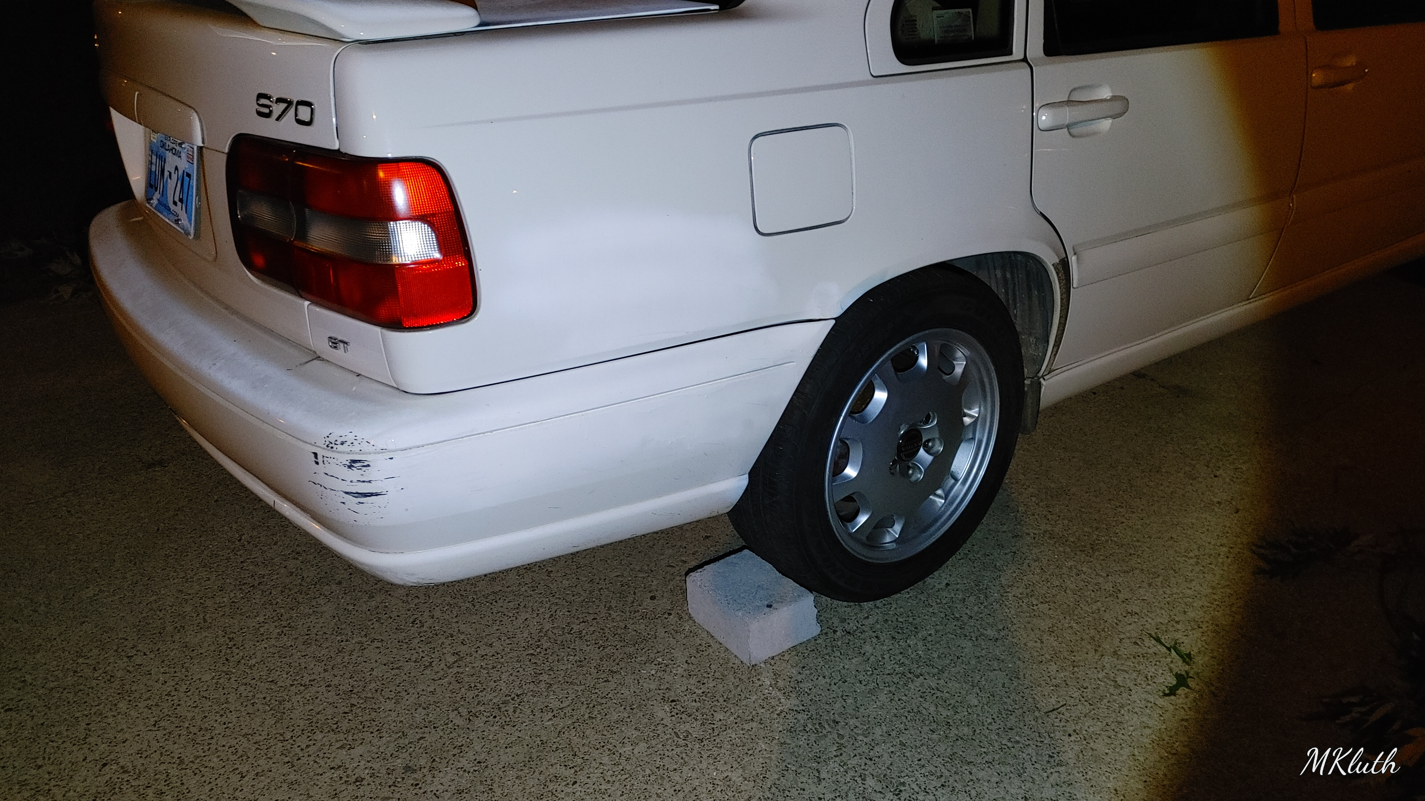

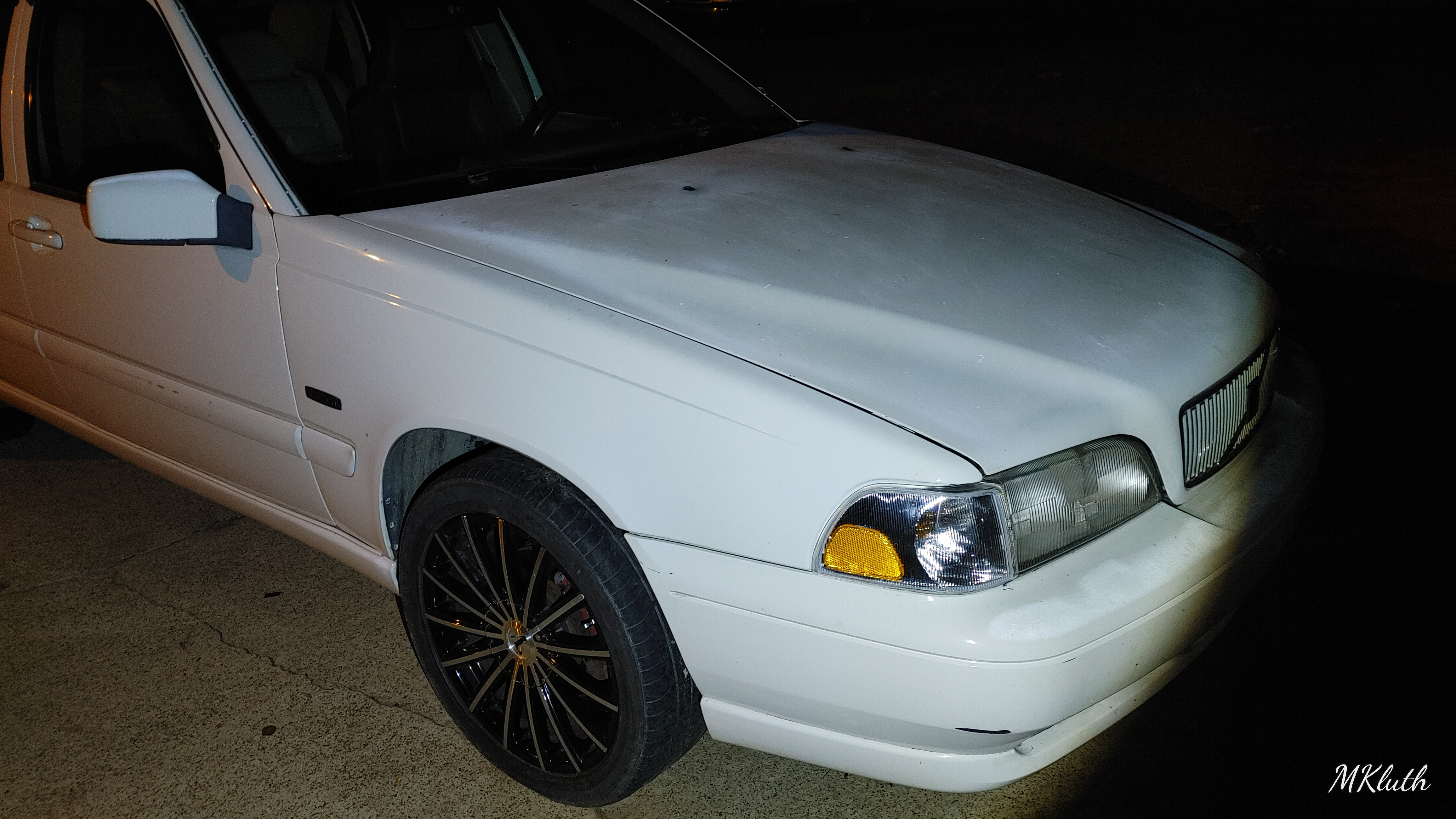

Today I replaced both rear Sachs shocks, rear ceramic brake pads. Also I swapped the insane aftermarket 17" with my set of s80 base wheels. Tomorrow it will be more complicated...with the front. I like that i have a rare higher trim base model.
