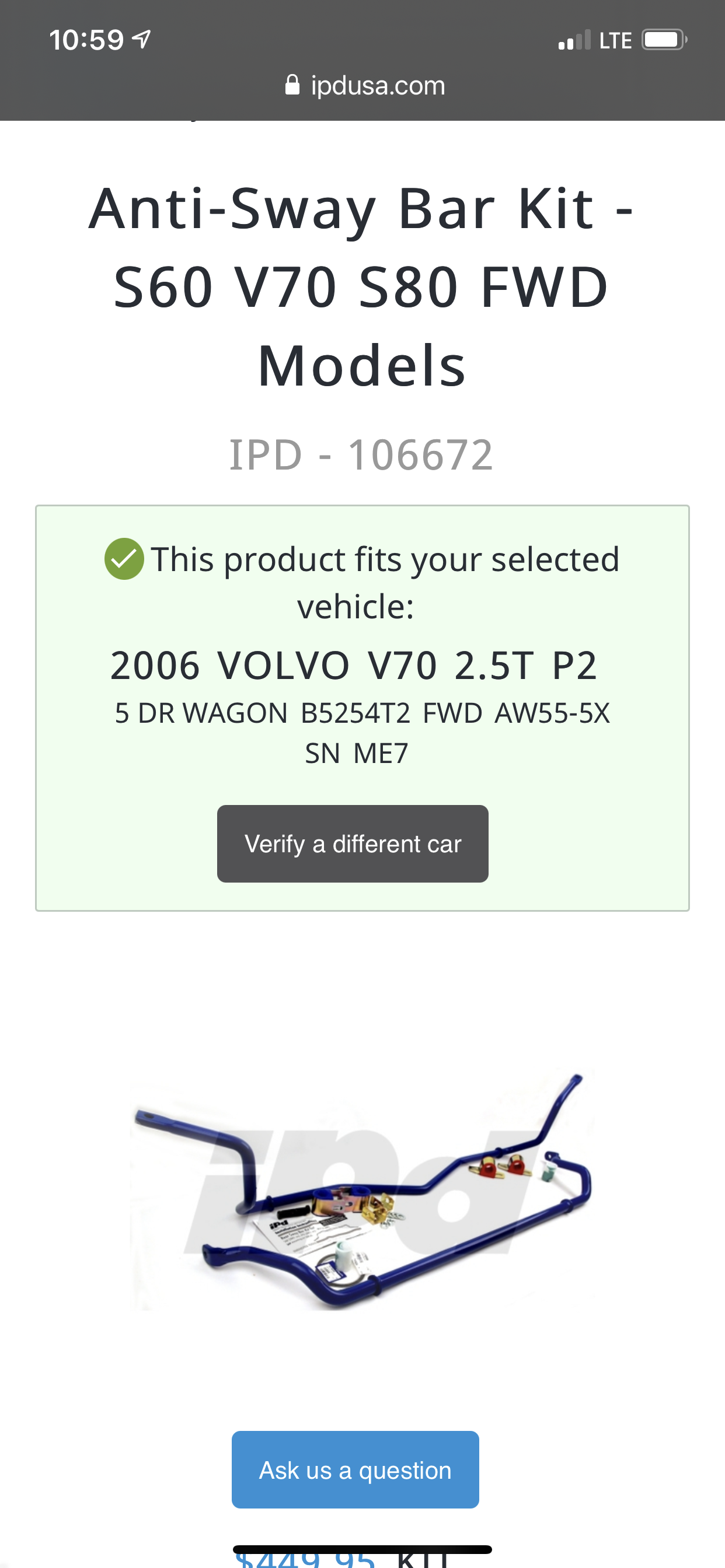

I’ve corrected my original post to show my car as FWD.BlackBart wrote: 29 Apr 2021, 20:01 Is there a difference between the ipd V70 bar and the XC bar? Could there be a part # mixup from ipd, or a mislabeled box?

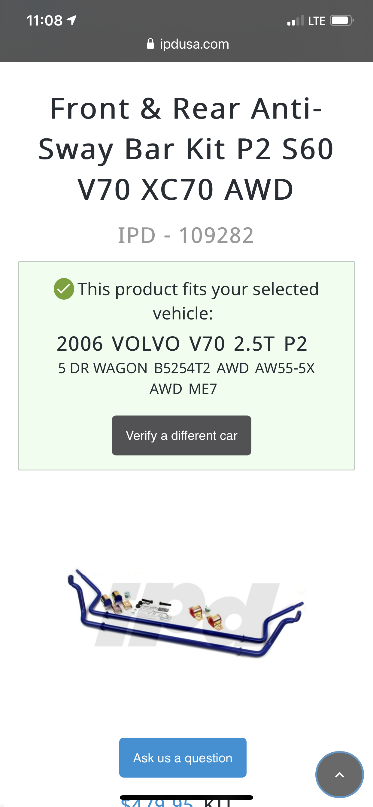

There is a difference in the FWD V70 & the AWD V70/XC70. They definitely sent the correct rear bar, as the AWD rear bar is pretty much straight, and the FWD rear bar is kinked, and that is the one I received. Above is what I ordered & received
And below is what they show for AWD. It’s the same ipdUSA model # for the XC70 too. The rear bar in this kit is straight. I definitely didn’t receive this kit.
So I don’t see that there could be a mix-up on ipdUSA’s part.
