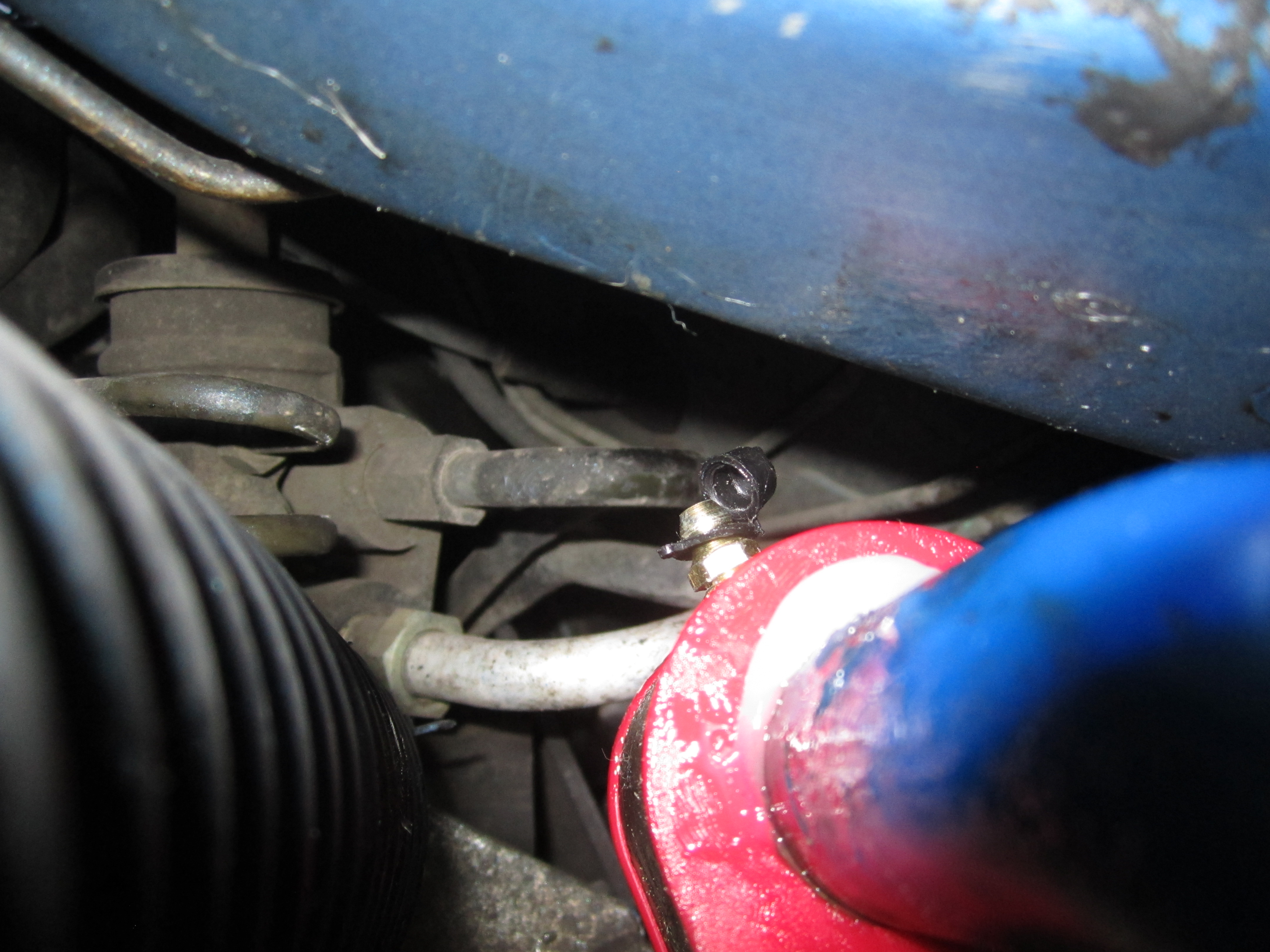

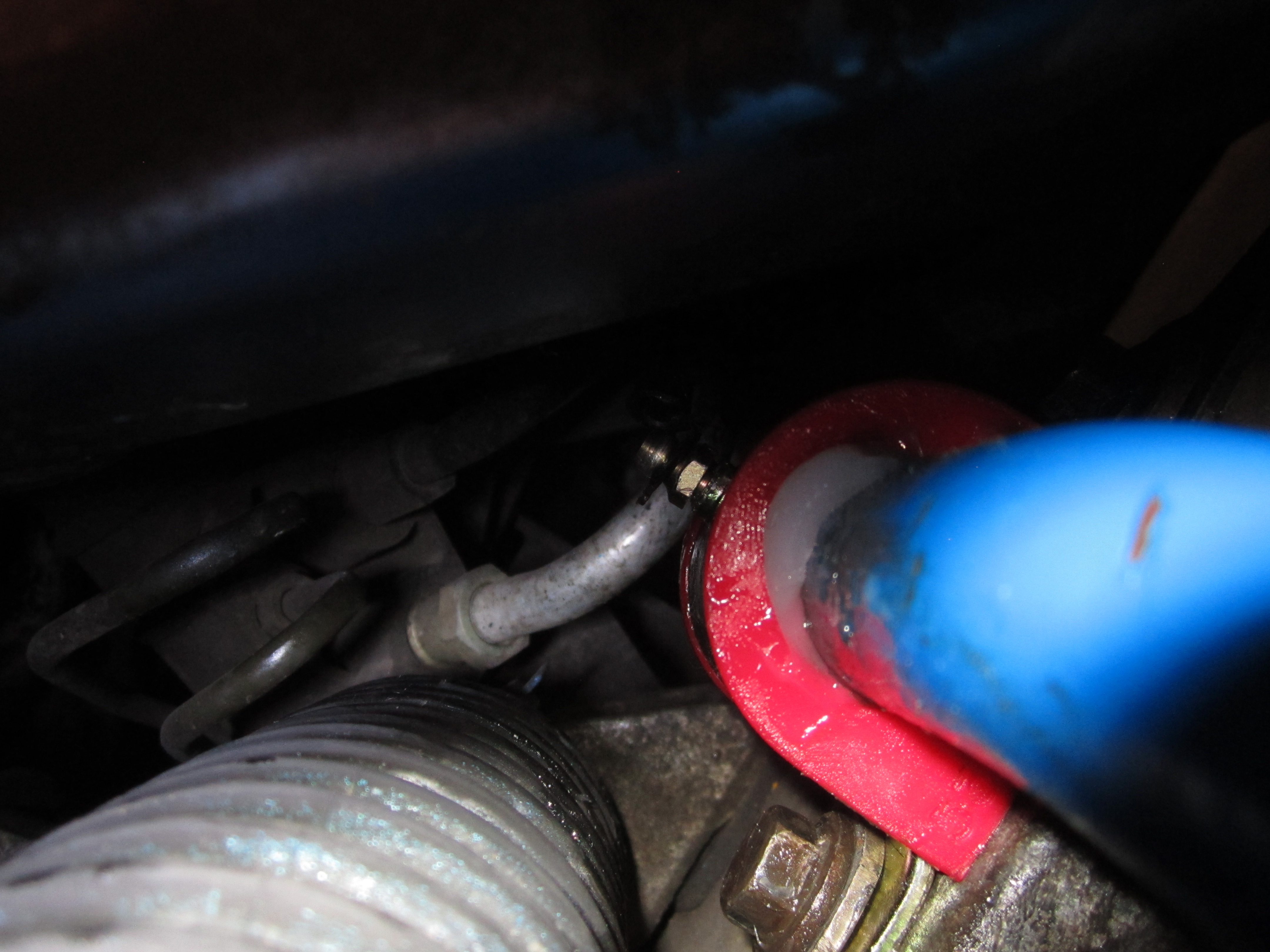

But to the point of being told the grease nipples would not be accessible, here is a couple of photos to show they are:
The picture above shows that the bush is not actually blocked by the front frame, but is inset from it.

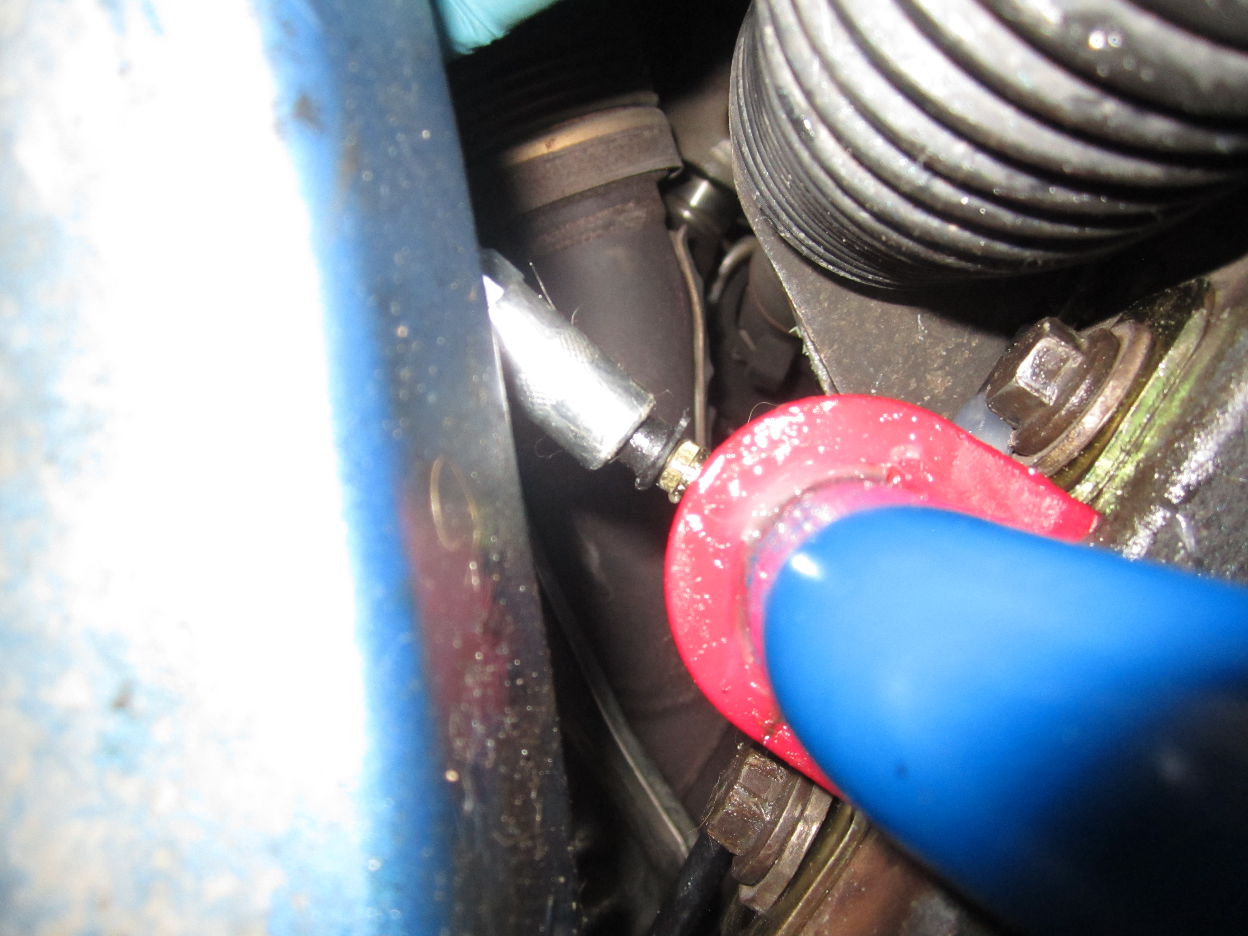

Picture above shows the grease gun fitted to the grease nipple!
A couple of point I would make though.
1) Having a flexible grease pipe on the grease gun makes this possible, but I am going to get a 18"-24" flexible pipe as it will make using the grease gun much easier.
2) I have contacted Energy Suspension to find out if the nipple can be swapped out for a 45 or 90 degree nipple which will make access even with a grease gun with rigid pipe possible.

I had mentioned that the zerk fittings may not be accessible being on top. Thanks for clarifying that! Here are the factory IPD sway bar bushings (which are most likely supplied by Energy Suspension) that I added a zerk fitting to. This is the grease I use, which is what I believe IPD supplies in the syringe
