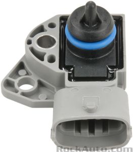

Well soldion.. MDK here. I've had more than a few of these..I started with a 1997 850Rwagon a millenia ago. If it was me I try this.. it's on rockauto with the info you gave.

1. FPR as posted above, but use on ly Bosch. Very easy DIY.
