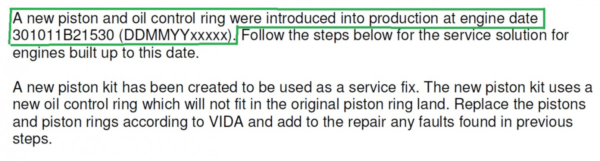

Volvo did make a change to the piston rings with the 3.2
(something about good intensions and the road to hell come to mind........or maybe the law of unintended consequences depending on what school you went to.)
This change happed with Model Year 2010 but they changed the piston rings again at the end of 2011 (production) a 2013 should have the revised rings
Full disclosure I own a 2008 3.2 LR2 (#98) with the original oil control rings and I own a 2010 S80 3.2 PZEV (#96) with the problematic oil control rings. I never add oil to the LR2 and I don't add much to the S80 (less than 1 quart per 5,000 miles). The S80 was bought used and the LR2 was purchased new (the LR2 has only used synthetic oil, I can't say the same about the S80 but it is using synthetic now)
Volvo changed the piston rings in production DDMMYY 301011
For those of us not used to this format the change was one day before Halloween in 2011.
A 2013 XC60 should have the modified oil control rings from the factory.

The TJ has more information
TJ24643-2013-05-15.pdf
(12.58 MiB) Downloaded 652 times
Good luck
Paul
PS I reiterate my recommendation for buying a high mileage 2013 3.2. Because just before all hallows eve in 2011 Volvo diverted from the path to hell and back to the "Road Less Traveled By"
