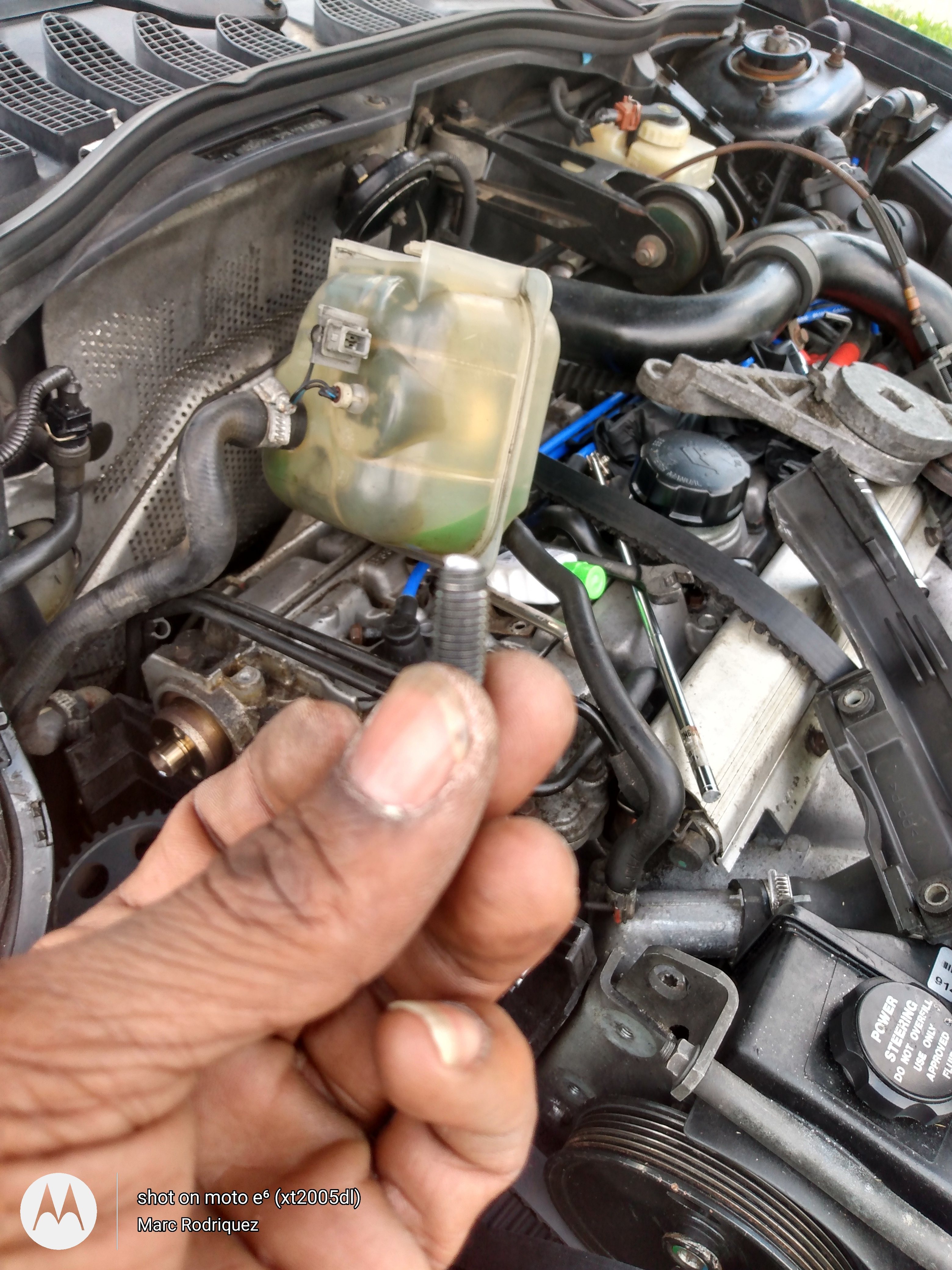

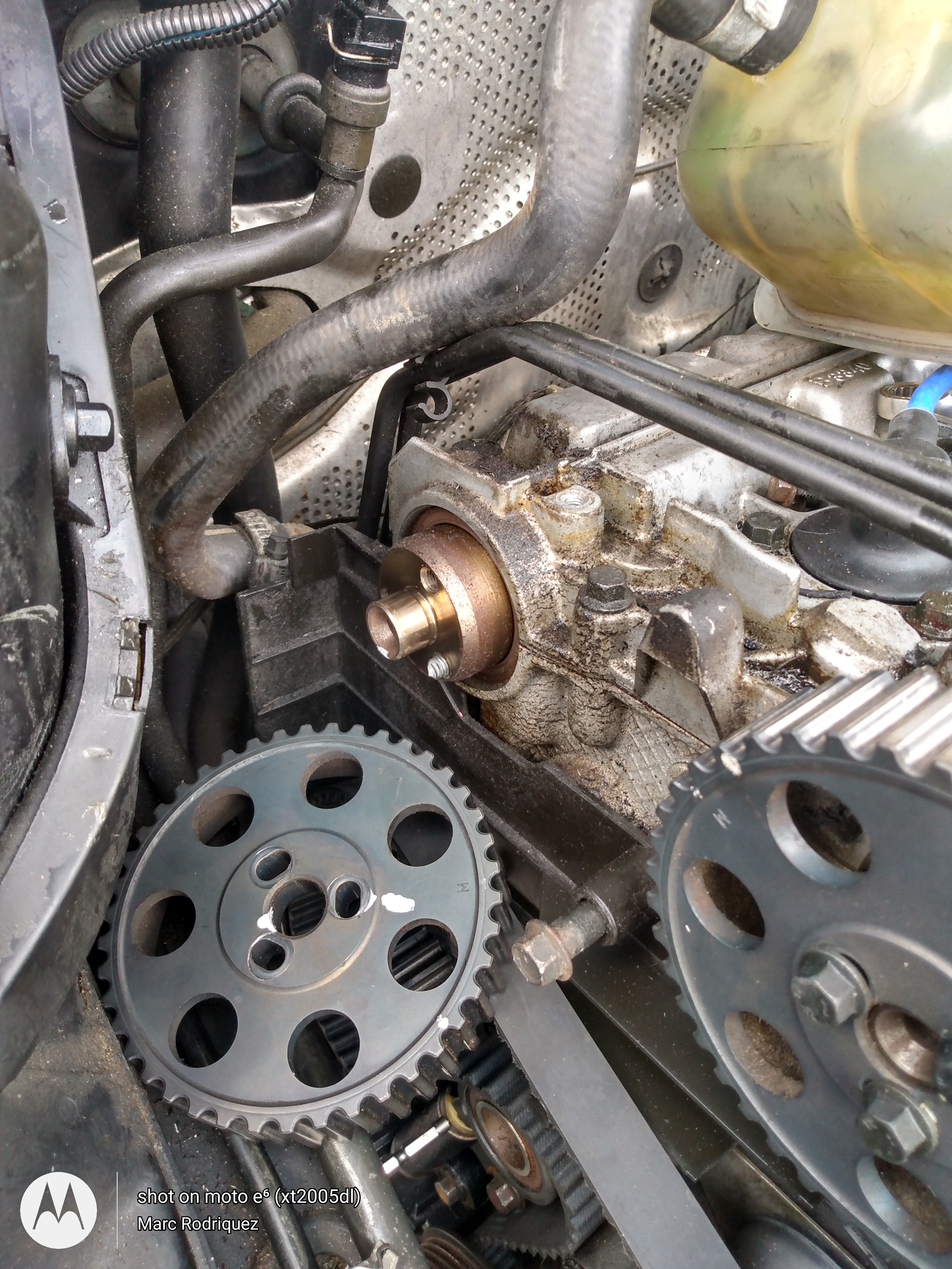

I had the Volvo gods smiling down on me today when I pulled the exhaust cam to remove the broken bolt and to my surprise I twisted the broken end out with my fingers. Now to hit the salvage yards for some bolts because it's Sunday and tomorrow I'm off.

Couldn't some 12.9 grade standard bolts fit for the job too? Maybe earlier one put those original bolts a bit too tight so they now broke. Happily though not with engine running.mdr1220 wrote: 04 Jul 2021, 10:58 I had the Volvo gods smiling down on me today when I pulled the exhaust cam to remove the broken bolt and to my surprise I twisted the broken end out with my fingers. Now to hit the salvage yards for some bolts because it's Sunday and tomorrow I'm off.

There are 5 850s in my local yards and I don't want to play with non factory bolts.xanthefin wrote: 04 Jul 2021, 11:03Couldn't some 12.9 grade standard bolts fit for the job too? Maybe earlier one put those original bolts a bit too tight so they now broke. Happily though not with engine running.mdr1220 wrote: 04 Jul 2021, 10:58 I had the Volvo gods smiling down on me today when I pulled the exhaust cam to remove the broken bolt and to my surprise I twisted the broken end out with my fingers. Now to hit the salvage yards for some bolts because it's Sunday and tomorrow I'm off.

I was going to surmise that was going to be the case. I didn't thing it was stuck when you broke it, you just happened to twist that small bolt with enough torque in the the *right* way to shear it. Good thing you didn't have to spend time futzing with that.mdr1220 wrote: 04 Jul 2021, 10:58 I had the Volvo gods smiling down on me today when I pulled the exhaust cam to remove the broken bolt and to my surprise I twisted the broken end out with my fingers. Now to hit the salvage yards for some bolts because it's Sunday and tomorrow I'm off.
