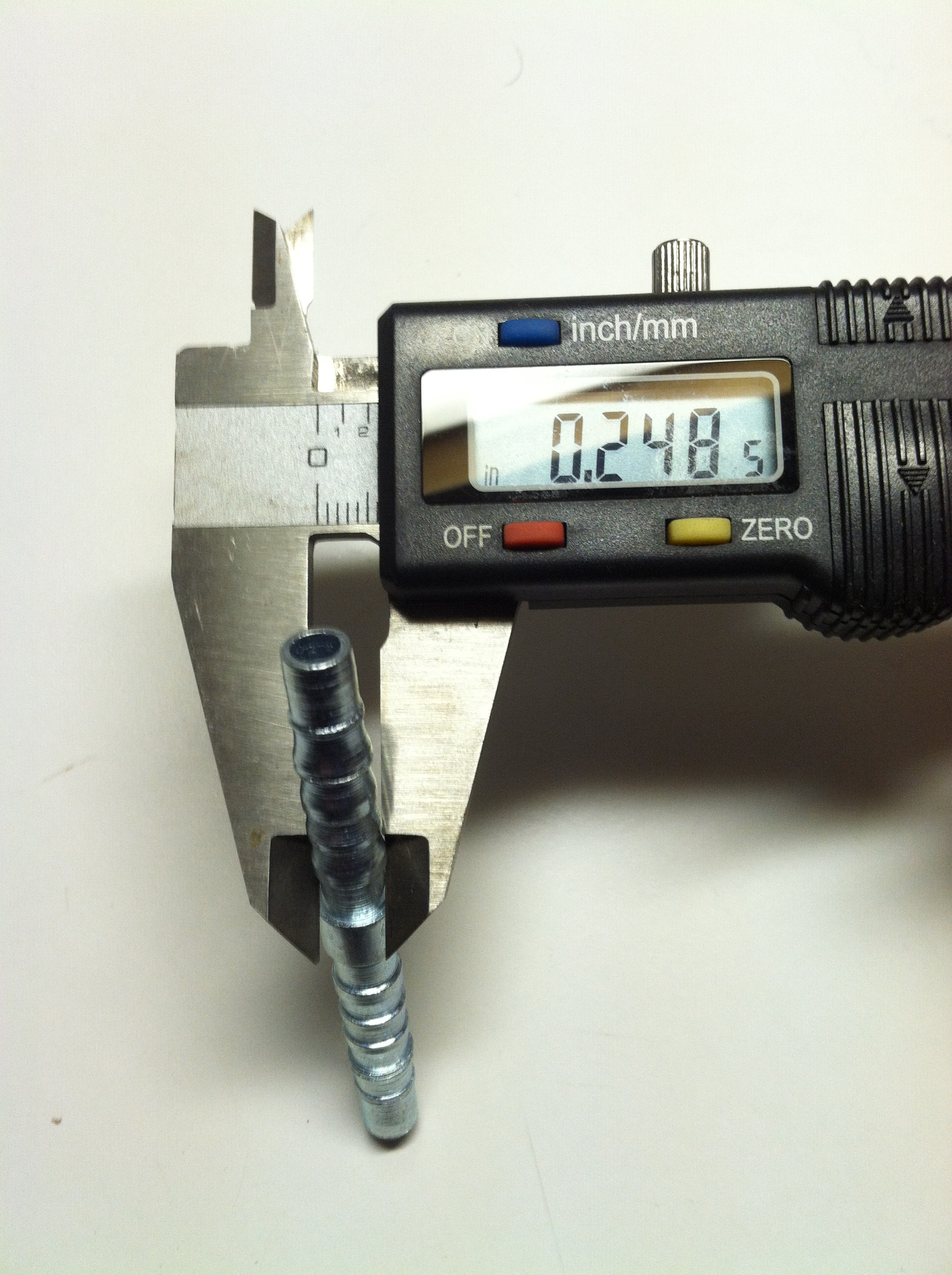

On my 850T5 the plastic line od is approx. 8.40mm; the exposed part of the barb seems to be .250" , but I can't remember if I could only find 5/16

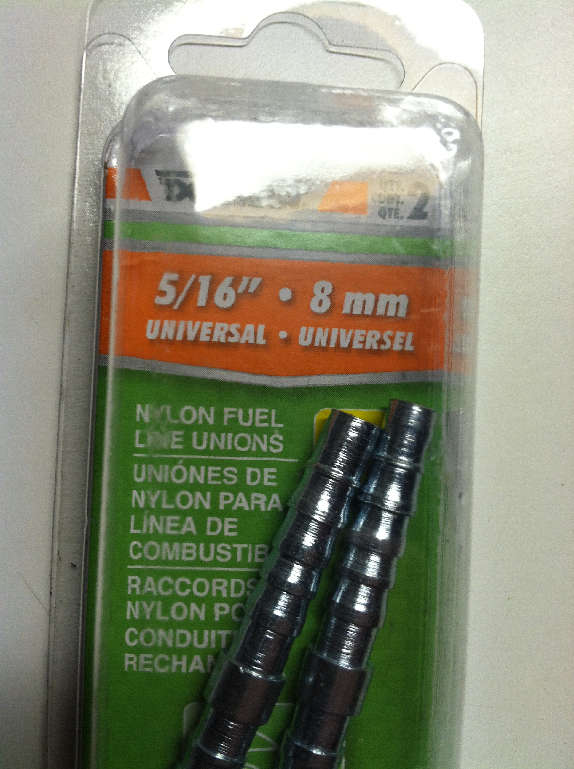

All Stop, Matey !
I couldn't find the box with the leftover piece - naturally - so I put on some pants and drove to Autozone.
This is what you want.
Remember to warm up the line, and you will need to trim ca. 1/4" off to leave a little space for the center of the barb.
I didn't bother putting a rubber chafe guard back over it, I would rather see it in case it springs another leak.

Thank you soooo much foggydogg🍺👍! I will buy 5/16 barbs and line!

Chuck W wrote: 04 Jul 2021, 06:57 Just buy both to be sure. They're $6 each, and you should be able to return the one you don't need.
Wasn't too concerned about price/returns, but more with functionality. Didn't know if the return line was an odd size, other than 8 or 10mm, but it seems its been identified as 8 mm / 5/16". Both supply and return lines seem identical in size to my untrained eye.
