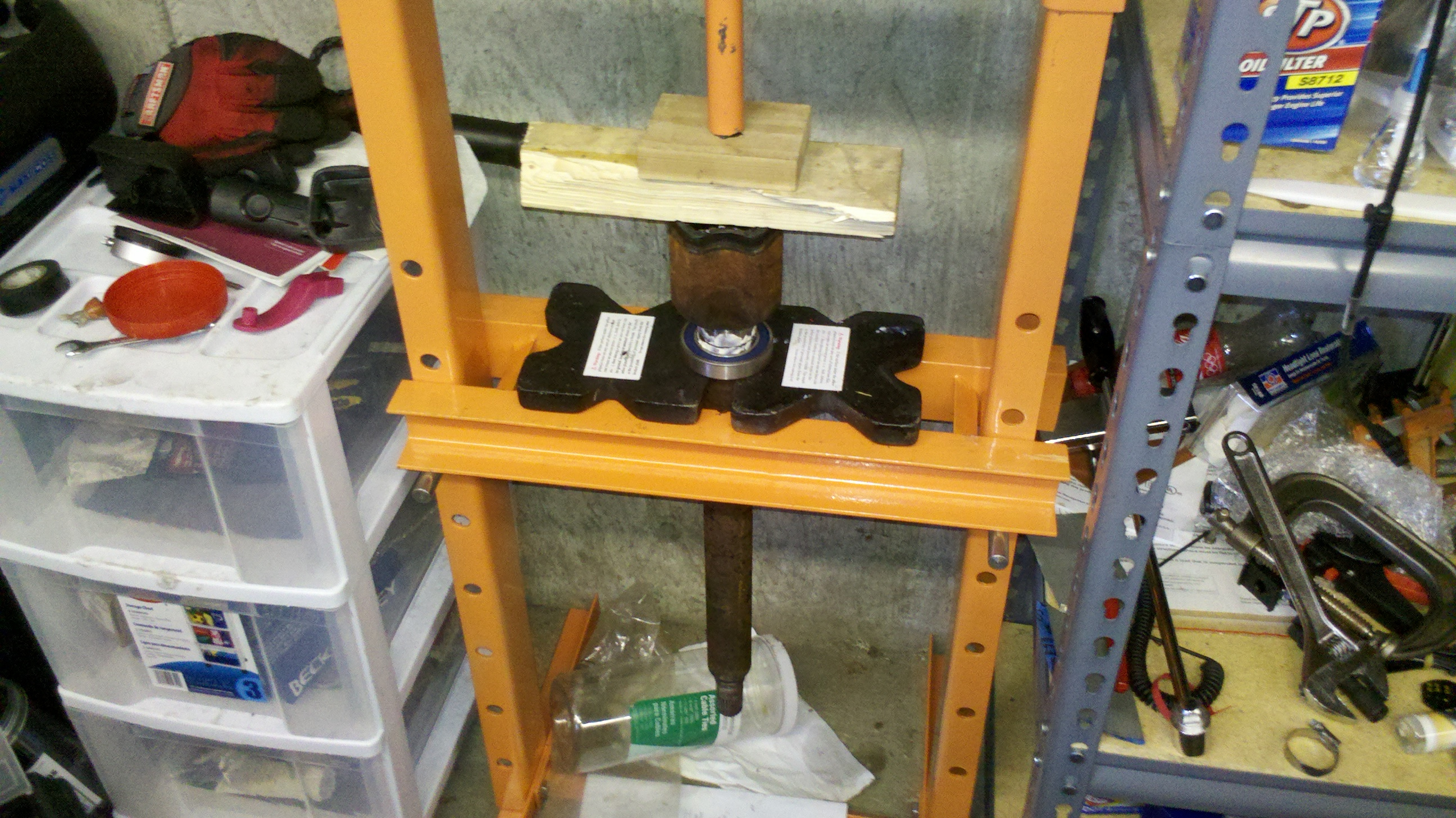

I replaced the bearing with the quality one, closest size from the standard nomenclature. It's depth was smaller, but it works well. Easily done with cheap 12 tons press from Harbor Freight. Don't remember the price for the bearing, but it was cheap compared to $$ mentioned above.

@vtl and @swimNdrive, I am facing this same repair soon on my '05 V70R with the front right CV axle carrier bearing.
There is a Febest version of this 45x75x19 bearing that seems more available nowadays, so I would likely purchase that. I have a 20 ton Harbor Freight press available to use, so I'm curious how the new bearing was pressed in? I like the suggestion of heating the new bearing in the oven first, too.
Apologies for reviving this old thread (it's frowned upon in some forums), but I think I'm still on topic for this thread.

Thanks for the picture! That makes sense.
