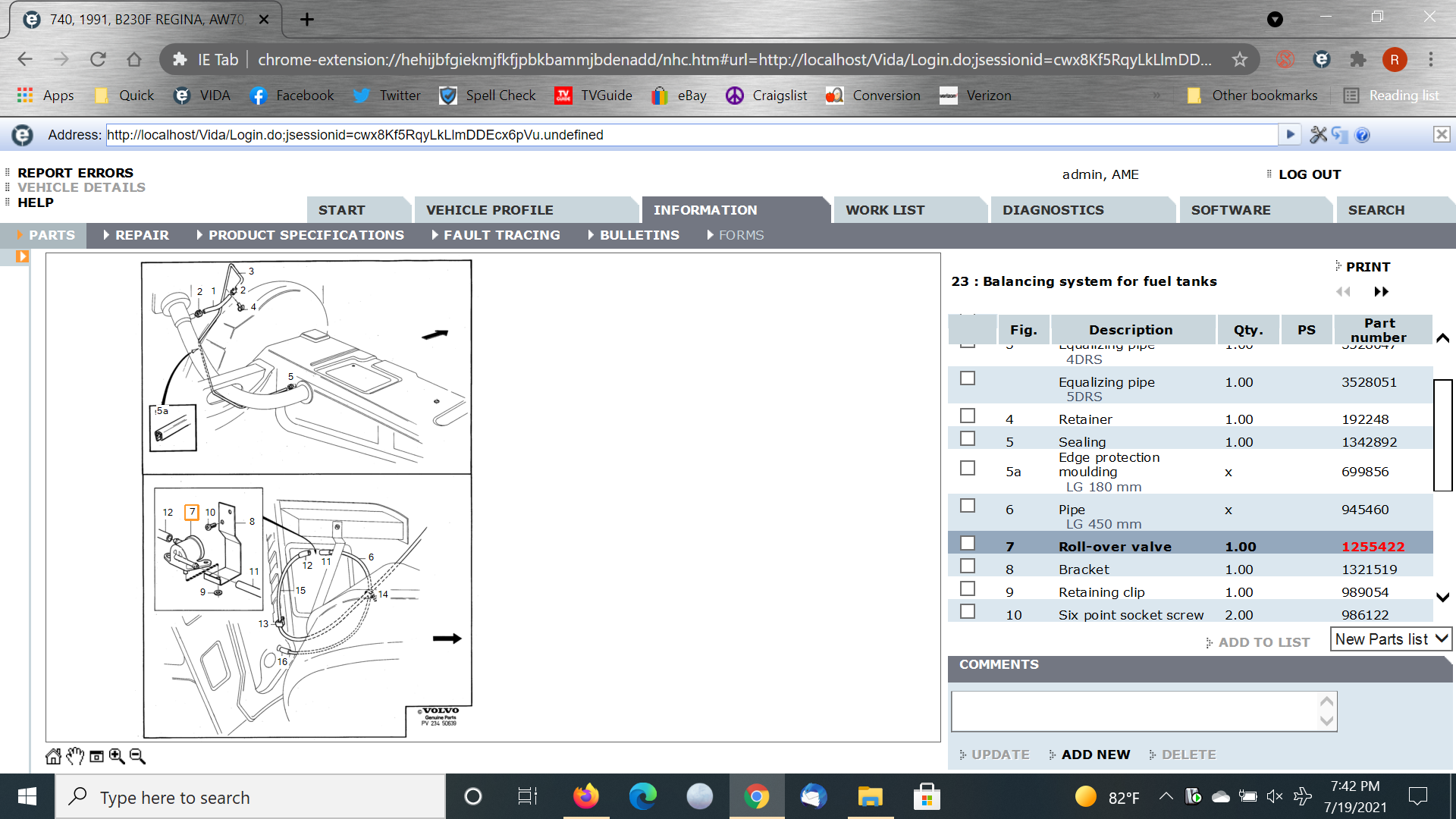

jpgurley wrote: 19 Jul 2021, 17:43 Did the safety minded swedes have some kind of roll over cut off?
For the 1984 - 1992 740 it is Volvo part number 1255422.

Thanks for answering my rollover valve question.
It appears as if this is a device to prevent fuel from leaking out of the vent/EVAP system when the car is not upright.
Unlike Ford (and others) who electrically turn off the fuel pump I can see that this system could not be producing my dying on right turns problem.

jpgurley wrote: 20 Jul 2021, 07:03 Now have you got any illustrations of the baffles in the tank?
No illustrations of the baffles or tank construction ... but: If you look at the picture above your see a reference to a "Equalizing pipe" . The screen shot is from the parts catalog under "Balancing system for fuel tanks" ....

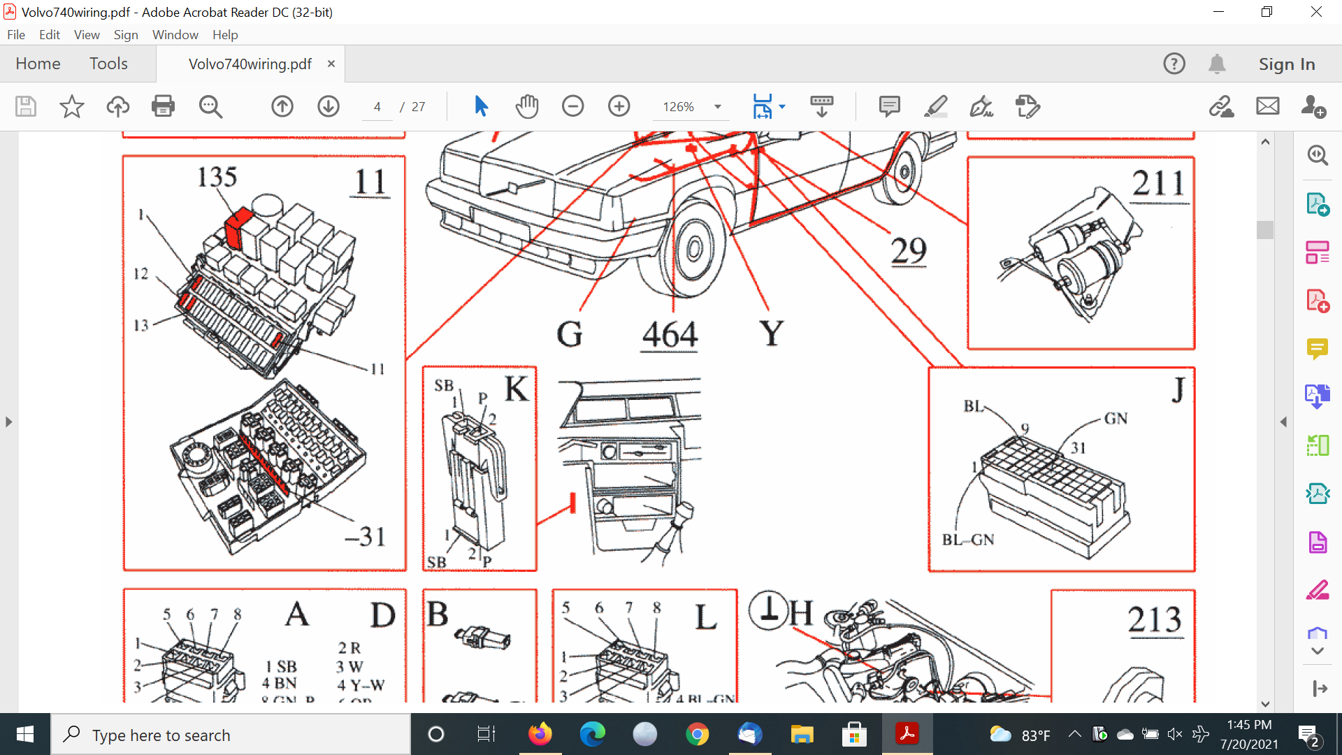

jpgurley wrote: 20 Jul 2021, 08:40 I am curious about where the fuel pump gets it's ground.
Do you have a schematic of that location?
When it stalls, does the engine shut down abruptly like somebody turned the key off or does it wind down over a period of a few seconds?
Have you tried raising the right side then left side of the car to see if it stalls? If it does you would have the condition right there in your work space where you could trouble shoot.
The 1989 shows fuel pump grounded in Electrical Distribution Panel. Electrical distribution panel is the lower half of the fuse panel. The fuse panel is attached to the top of it. One could say it is a common ground buss inside the fuse panel. -31 below
