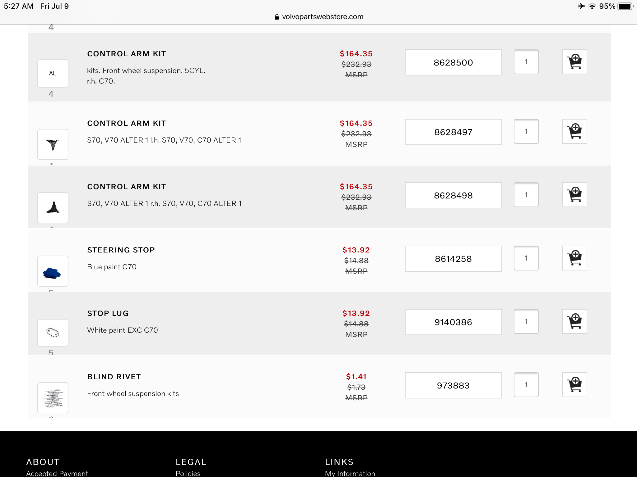

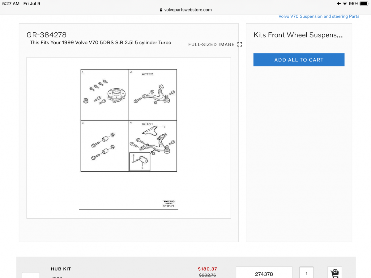

P80 4 bolt control arm kit front 8628498 8628497
- Posts: 36175
- Has thanked: 1614 times
- Been thanked: 4078 times
A bit tough to find sometimes
- foggydogg
- Posts: 2948
- Joined: 17 Oct 2009, 00:28
- Has thanked: 83 times
- Been thanked: 405 times
Volvo Annapolis shows them @ ca. $156 each.
https://parts.volvocarsannapolis.com/p/ ... 28497.html
FCP only shows TRW.
https://www.fcpeuro.com/products/volvo- ... -8628497oe
Were you looking for a pair, or just sayin' ?
