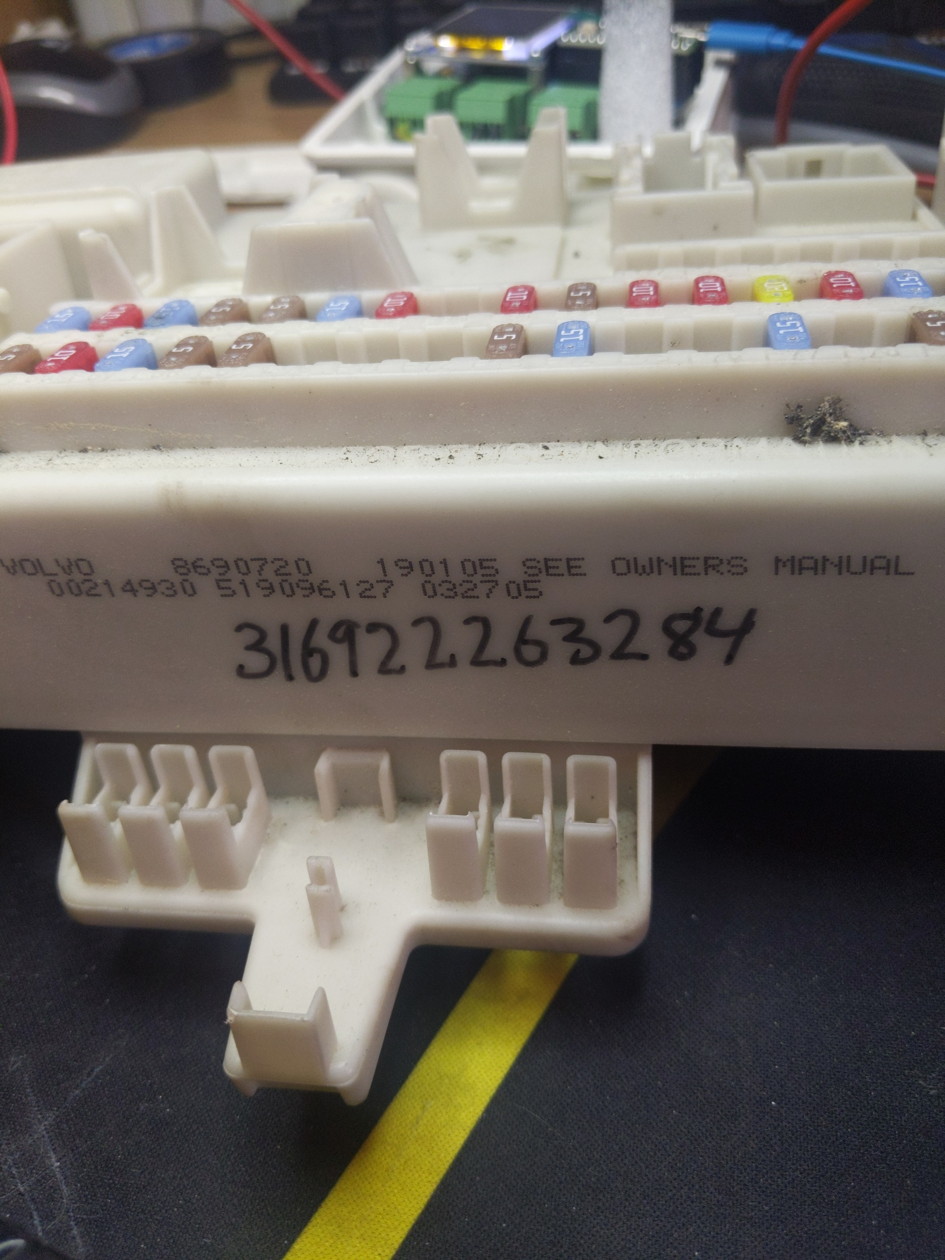

AA2020 wrote: 03 Aug 2021, 03:07 08690720 (2005): Correct PIN : 15 82 06 59 81 62
Candidate PIN 53 27 33 -- -- -- :
AA2020 could you test your bench setup with a already cracked CEM?
AA2020
Posts: 8
Joined: 3 April 2021
Year and Model: 2007/ V50
Location: Riga
Post by AA2020 »
RickHaleParker wrote: 04 Aug 2021, 10:48
vtl wrote: 04 Aug 2021, 09:34 I wonder if pin order is different for this part number.
He knows the PIN on the 08690720. Cracker is not getting any of them correct. But this is the only one he has tried on the bench. We don't know that the bench setup is correct.
Yes, 31254903 cracked on bench (and on car too) without any problem, every time.
08690720 Not cracked on bench, not cracked on car.
I/O Terminal connecting OK with Pin - 158206598162
Vida connected Ok on bench.
RickHaleParker
Posts: 7129
Joined: 25 May 2015
Location: Kansas
Has thanked: 8 times
Been thanked: 958 times
Post by RickHaleParker »
AA2020 wrote: 04 Aug 2021, 12:37 I/O Terminal connecting OK with Pin - 158206598162
And not a single one make the best candidates by latency or std .... Odd!
What you think VTL ... real fast chips? Are his latency times typical of a P1 CEM or on the fast side?
What hardware interfaces work with which I/O Terminal software ? I have two J2534 interfaces. KKL, ELM327. USB to TTL ... almost forgot Odin. :wink:

RickHaleParker wrote: 04 Aug 2021, 13:14 What you think VTL ... real fast chips? Are his latency times typical of a P1 CEM or on the fast side?
P1 is ancient Motorola running at turtle's speed, two of them. Could be something simple, like one MCU sits on CAN-HS, other one CAN-LS, and CAN-LS one is handling the pin routine check, while CAN-HS peer only forwards a request and reply. The cracker may be working there if the pin interrogation is done on CAN-LS. I think someone here had mentioned that, that his cracker started to work with his P1 CEM once he had hw/sw fixed to work on CAN-LS. Or maybe in email thread, I forgot.
