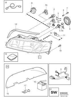

I'm with you on this one. I can't get it either. I mean glass is basically sand and it seems to me there's plenty of it. Plastic headlights. Do the car/truck manufacturers really save that much money? I'm just wondering if you can use glass lenses from a 2004 xc70 and convert them over...2001-2009 S60's apparently is the same light fixture .. maybe it's possible to swap out plastic for glass..
