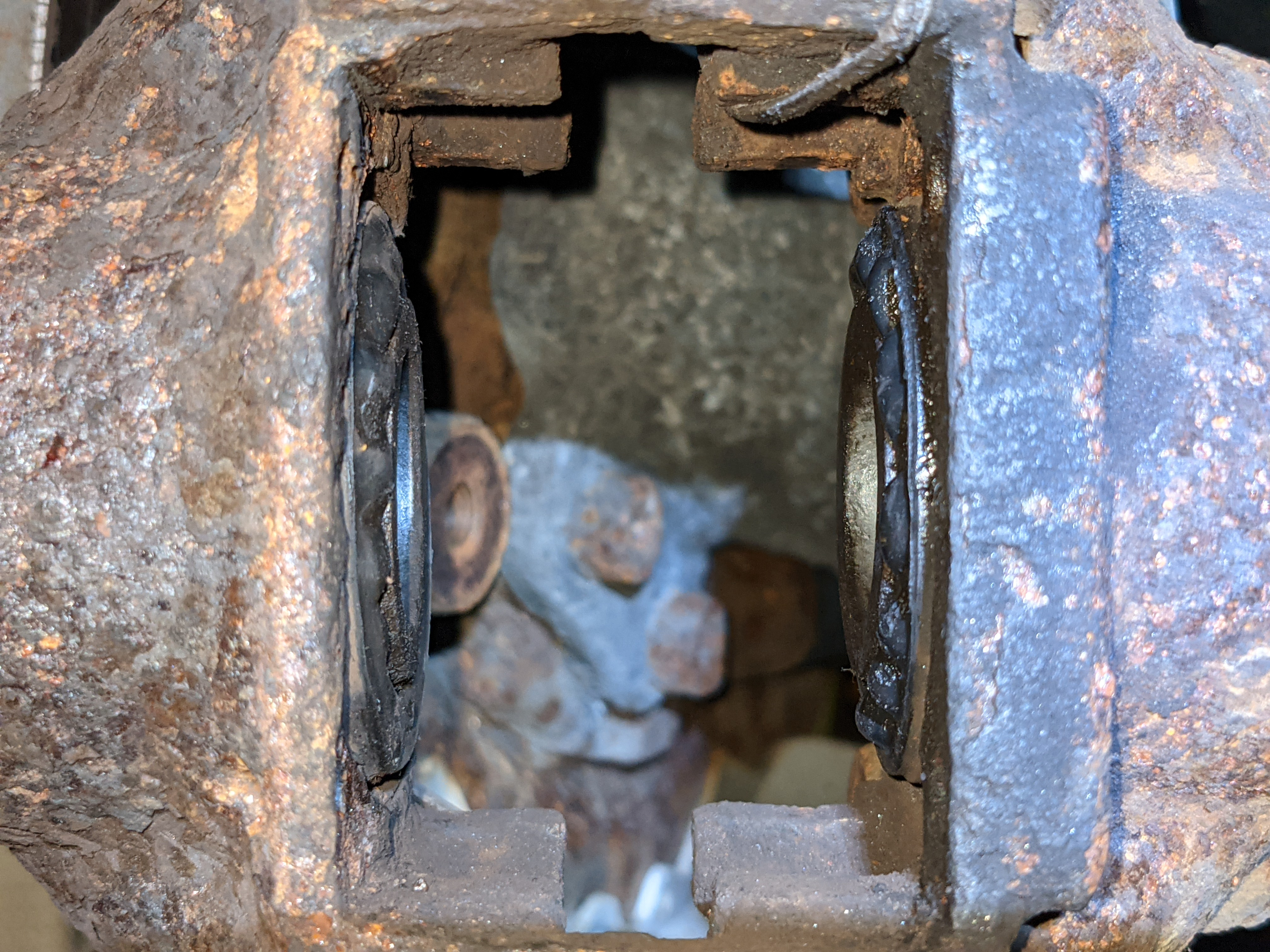

Here's a picture of the rear rotor with the pad deposit on its inner face. Both rear rotors (Zimmermann) and pads (Volvo) are eight months old with 4000 miles on them. The rotors came with about 13/1000" run-out and I have replacements ready from FCP.
The deposits happened July 4th and July 19th when the car sat a few days in the rain. I heard the rust break loose when I drove both times. The rough spots are barely raised at all yet the cause a terrible shudder and loud banging even under light braking. The spots at 9 and 10 o'clock have clear rectangular pad outlines from the rainy days. The spots at 1 and 3 o'clock are oddly wider, perhaps caused by the bad run-out. The other rear rotor has the same bad run-out and has two similar vague rough patches on its inner face.
I blame the parking brake shoes dragging against the rotor hat, causing excess heat, bubbling the caliper piston boots, making the pads sit closer to the rotors than they should (causing more heat and ruining everything faster). See the attached picture. Before removing the caliper, the wheel was somewhat hard to turn because the pads were pressed to it. However, this same problem happened to the previous owner 14 months and 4000 miles ago when the piston boots were in much better shape. Seven months ago, the inner boot had two small bubbles and the outer was fine. Could two small bubbles have pushed the pad too close to the rotor for the previous owner?
Why do you think the pads are leaving deposits on the rotors, knowing these facts?

Get some salvage yard calipers installed until you can rebuild yours?
- Posts: 36147
I think the pistons are corroded in the cylinders.

The pistons expand and retract fully and easily. In January when I inspected them, the boots weren't bubbled and I saw no cracks in the boots which could let water in. So I'm hoping the pistons are good.
I would like to get a caliper from the junkyard in order to use its pistons if necessary. They are what always seems to go bad but they're not available separately.
