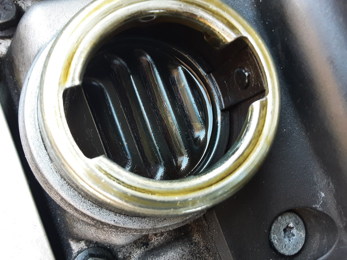

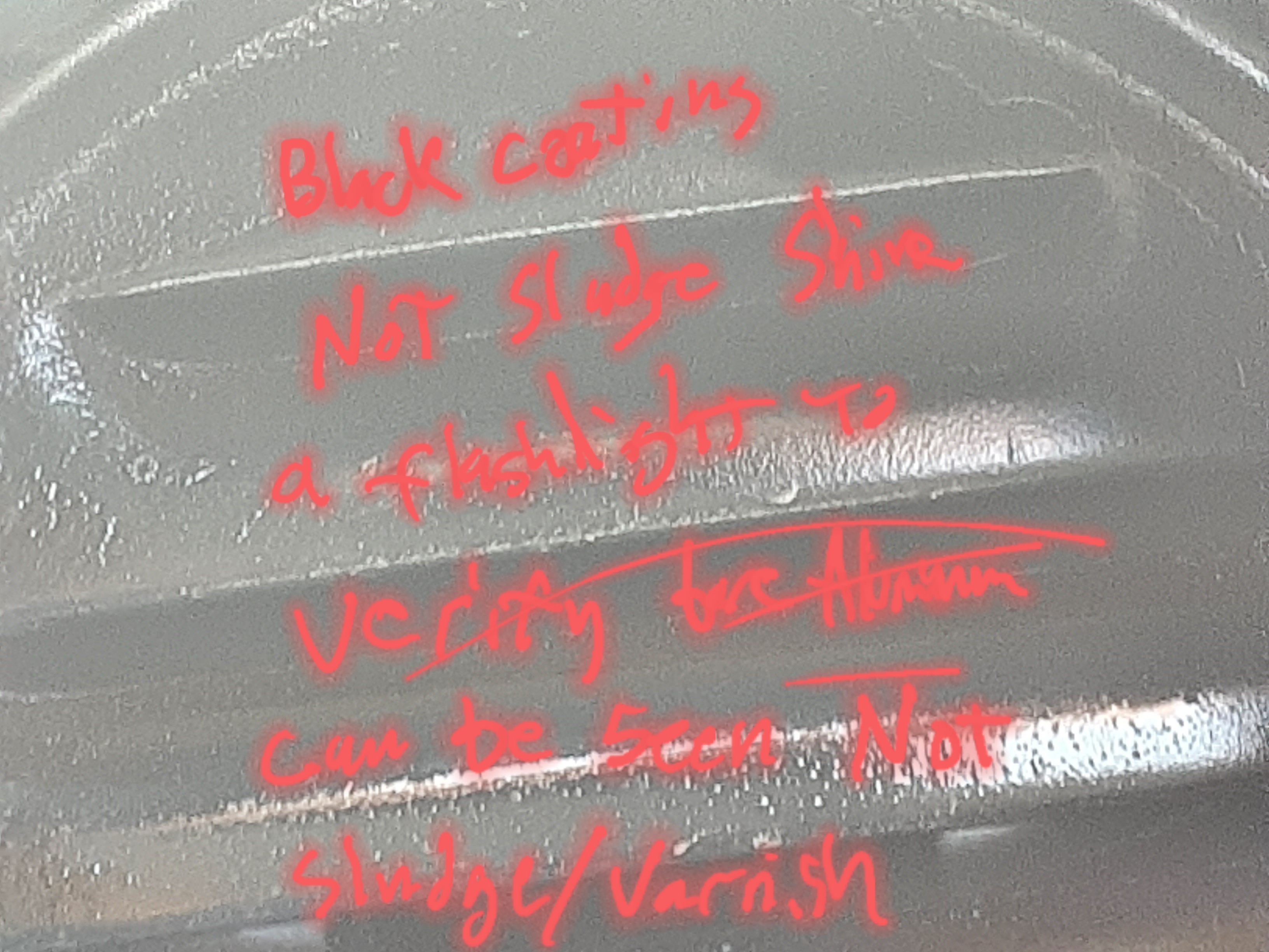

The dealer maintained of course! It has less mileage and is newer. Assuming they produce recipes. Be sure they opted for the synthetic oil and changed it appropriately. If they were a cheapskate and didn't opt for the synthetic oil, it must have been changed more regularly and check under the oil cap for sludge. Dealer maintained guarantees Genuine Volvo replacement parts were used. That saves you a timing belt service immediately as aftermarket timing belt, accessories, and water pumps cannot be trusted. iThe non dealer serviced car may be riding the factory belt! Also the dealer serviced car will have had the brake fluid changed every 2 years OR 20K, that means longer life for the ABS as well as rhe rest of the system. Also it will have had several power steering oil changes with the correct fluid giving longer life there too. I advise replacement of the banjo bolt immediately as both cars fall within the time period of faulty check ball that can destroy the engine. I assume the dealer maintained car is one owner? Few buy a used Volvo and dealer maintained them. You should be able to see a well maintained vehicle.
The R cars are junk used unless you plan on paying a fortune. Most some useful idiot has "improved Volvo's design with pages of aftermarket parts, tune and is being dumped because they gave up. You would be better buying a Polstar that is a few years old one owner traded back th Volvo. Then resist the urge to modify it. I think the 2015 is the last 6 cylinder PS/V70 Polstar. 0 to 60 in 3 seconds. I assume that is out.
Don't forget to check the pcv system! Post pictures of both and obtain more information on both. June

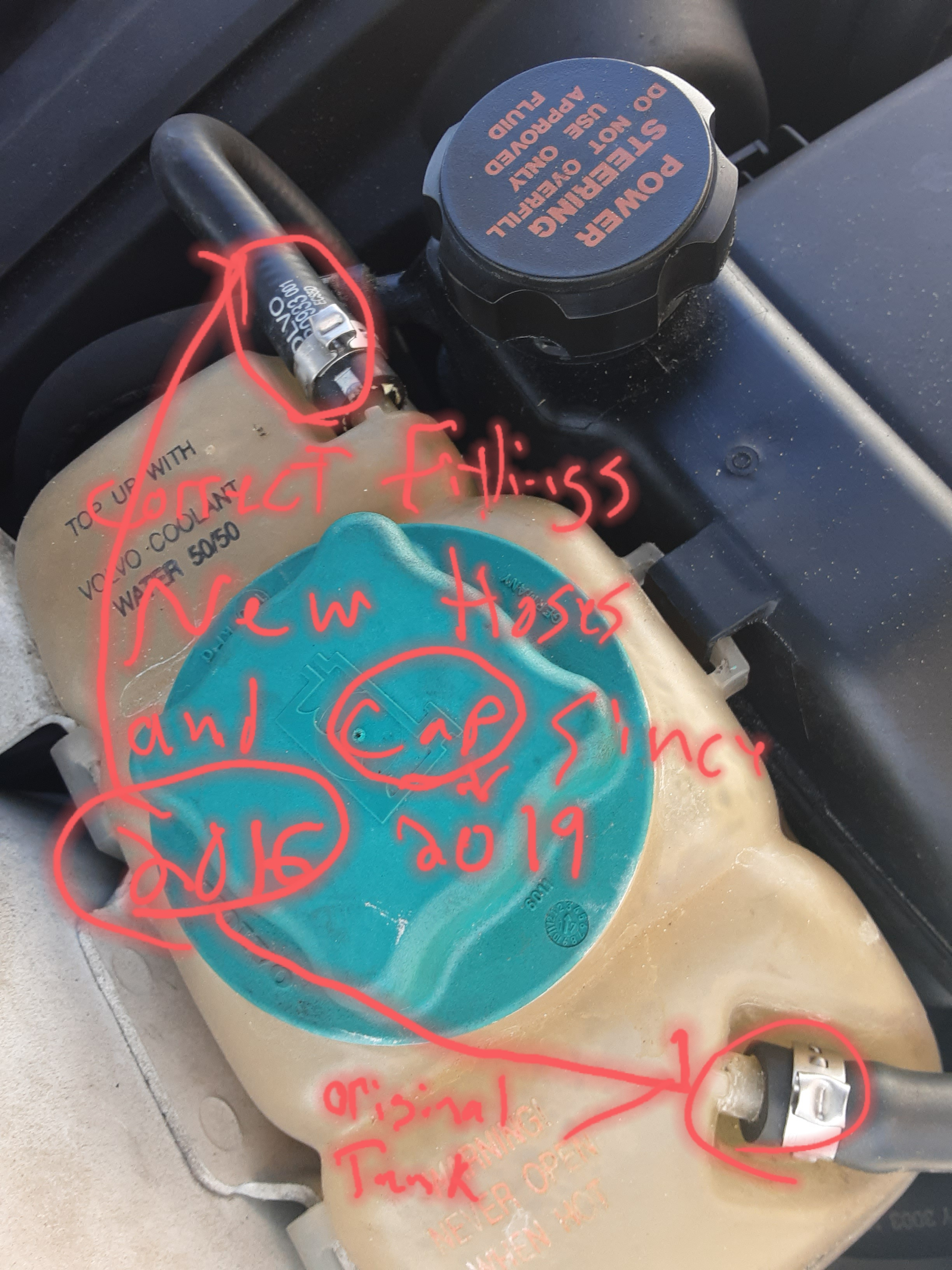

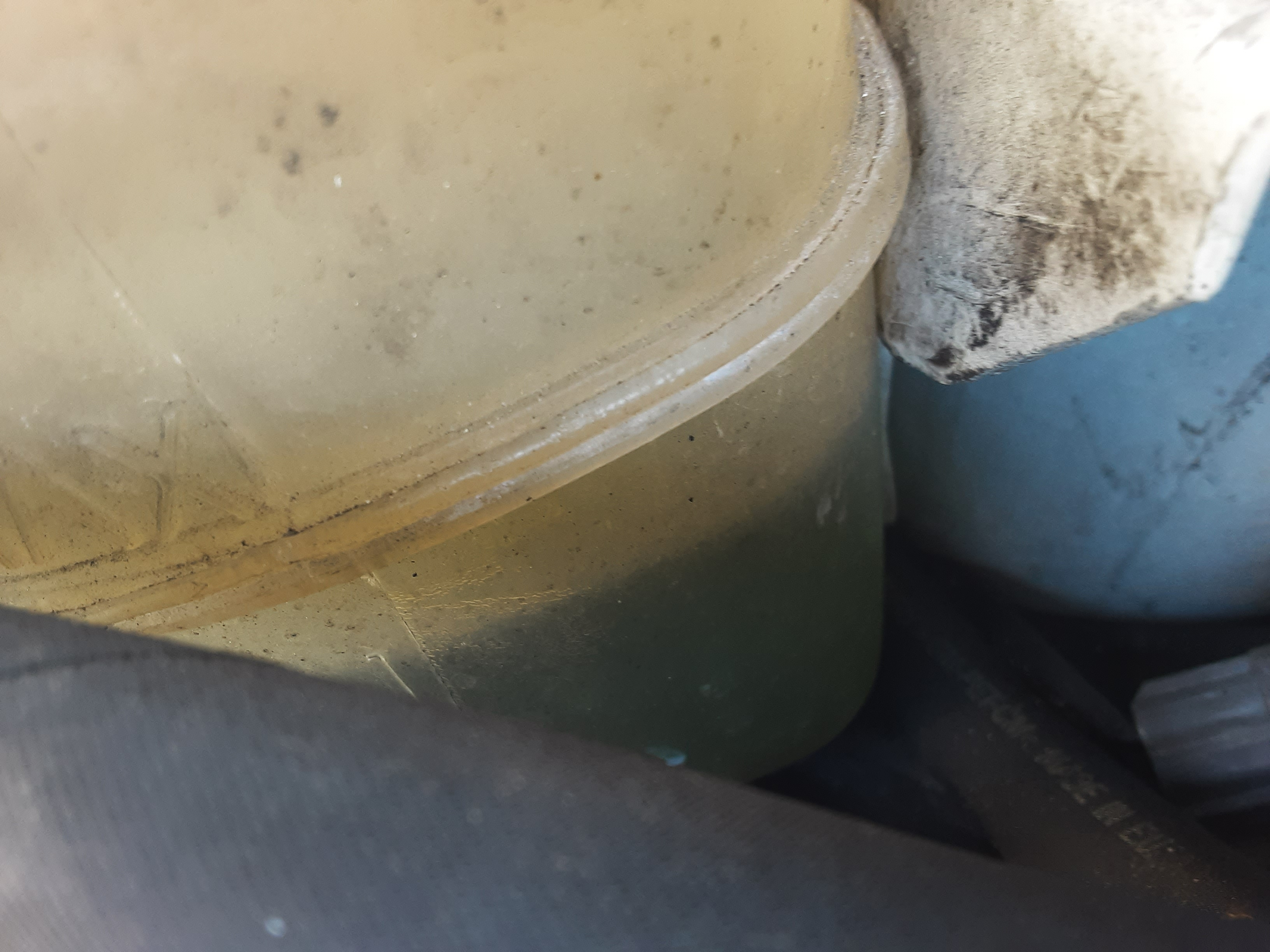

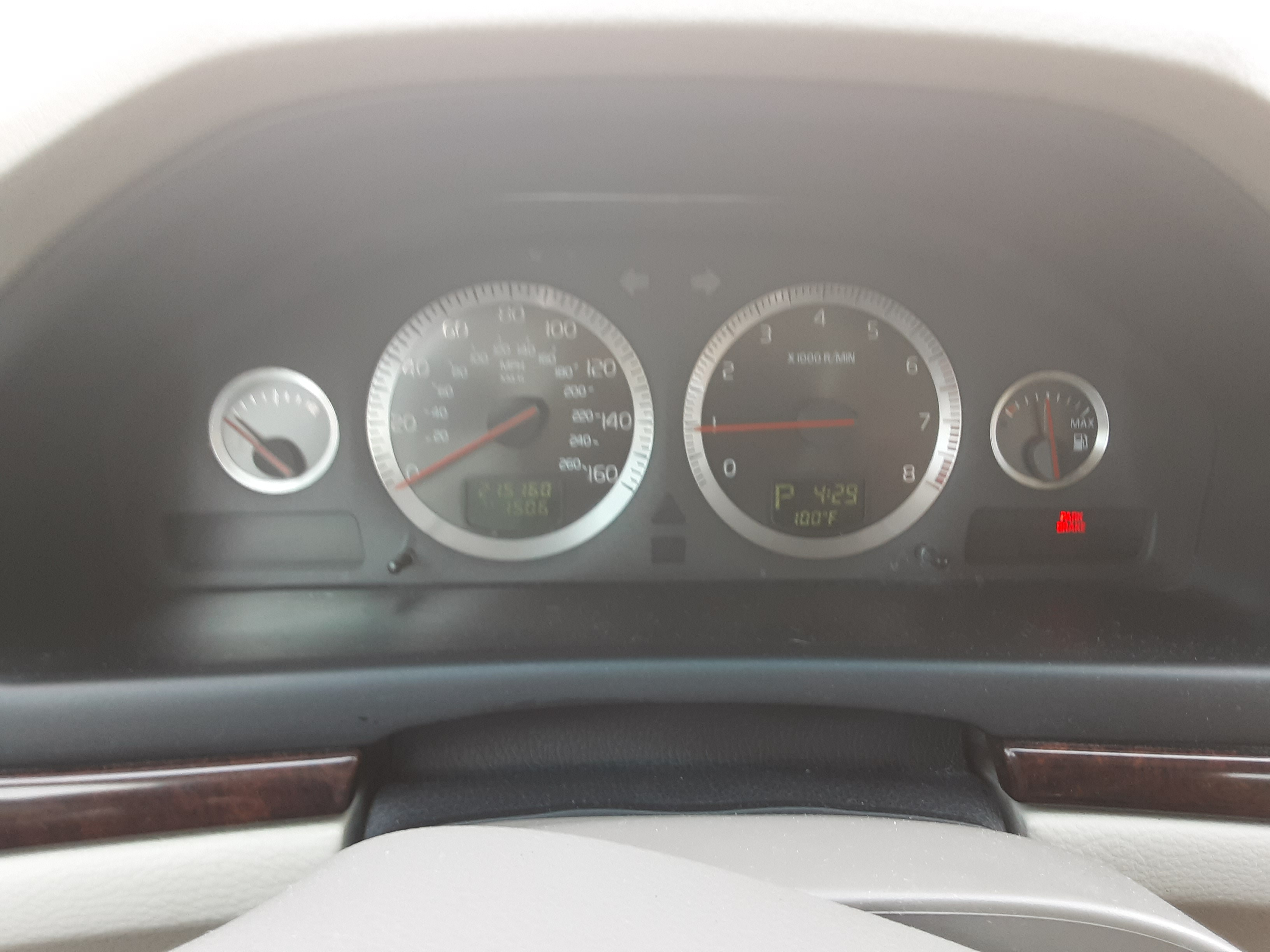

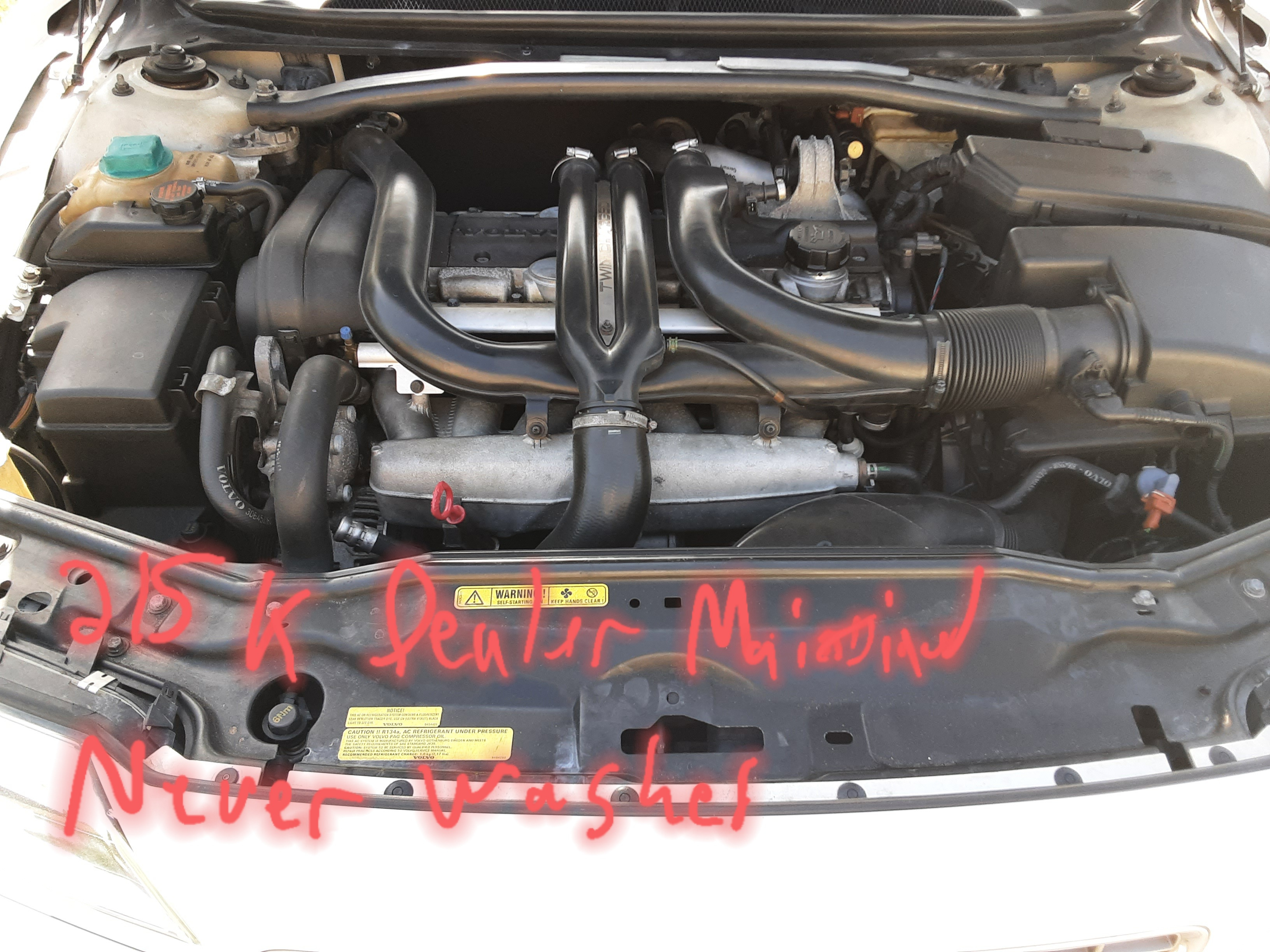

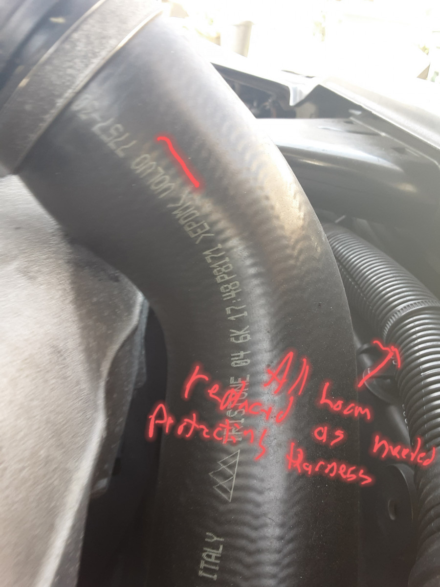

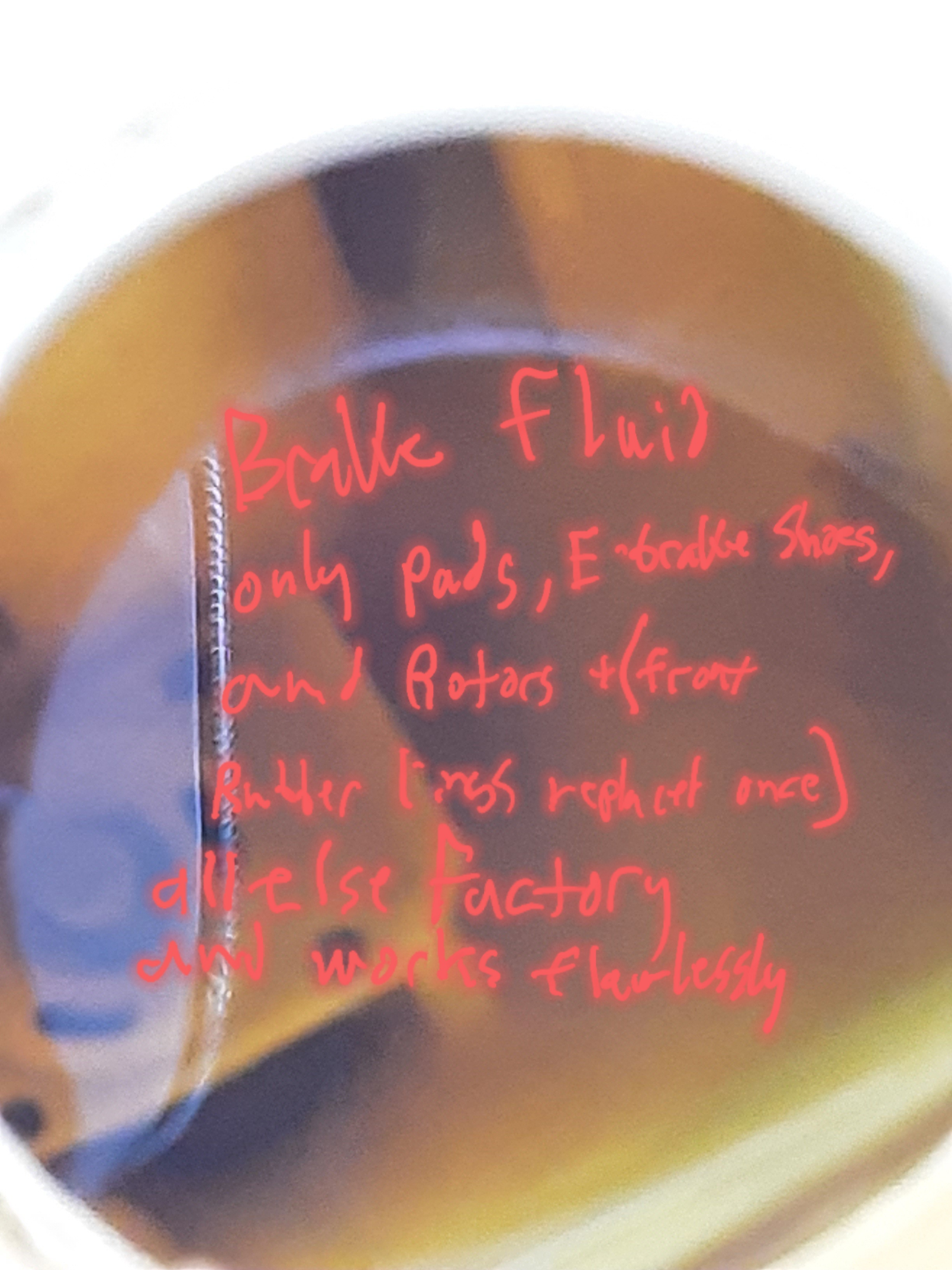

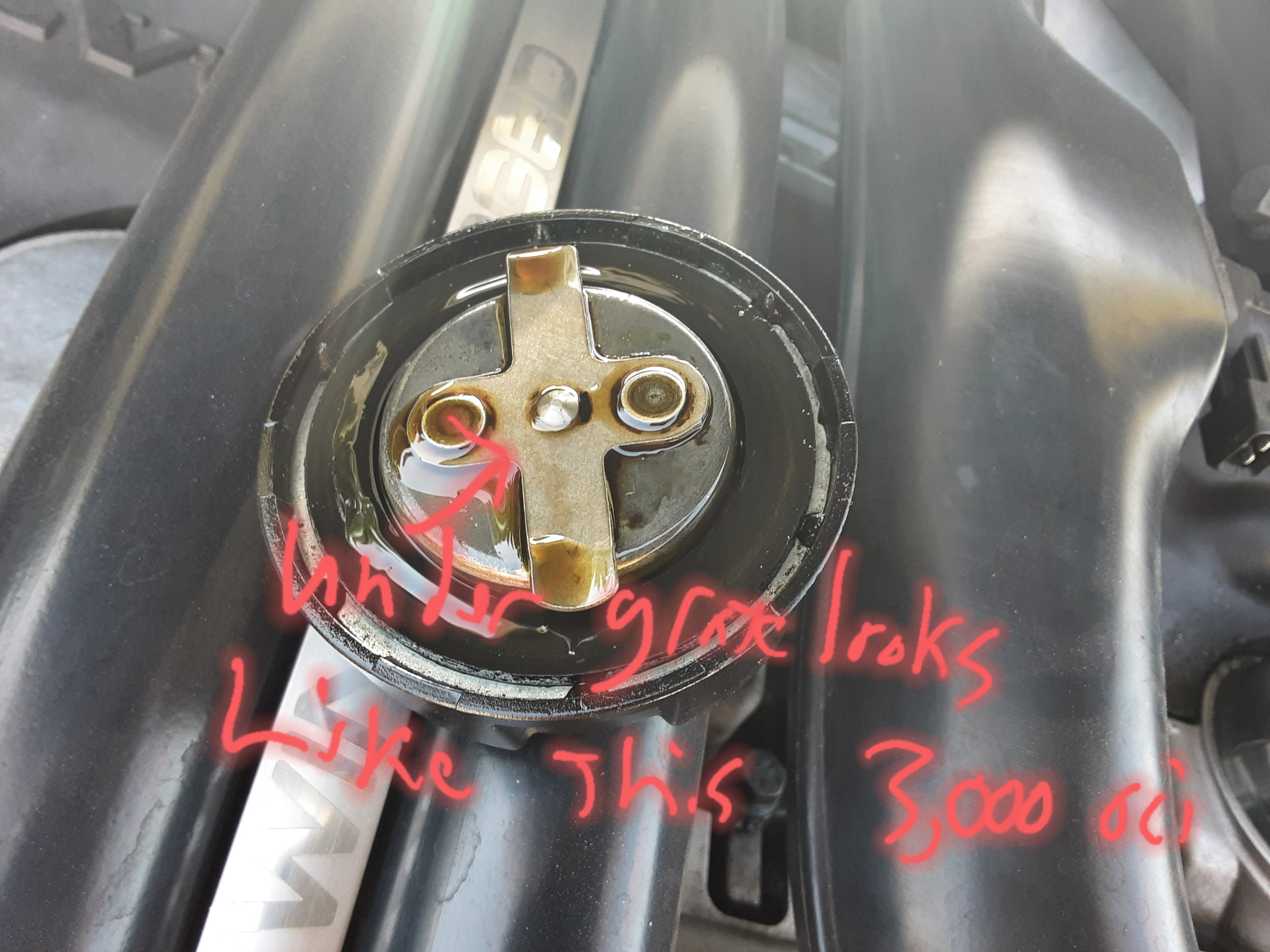

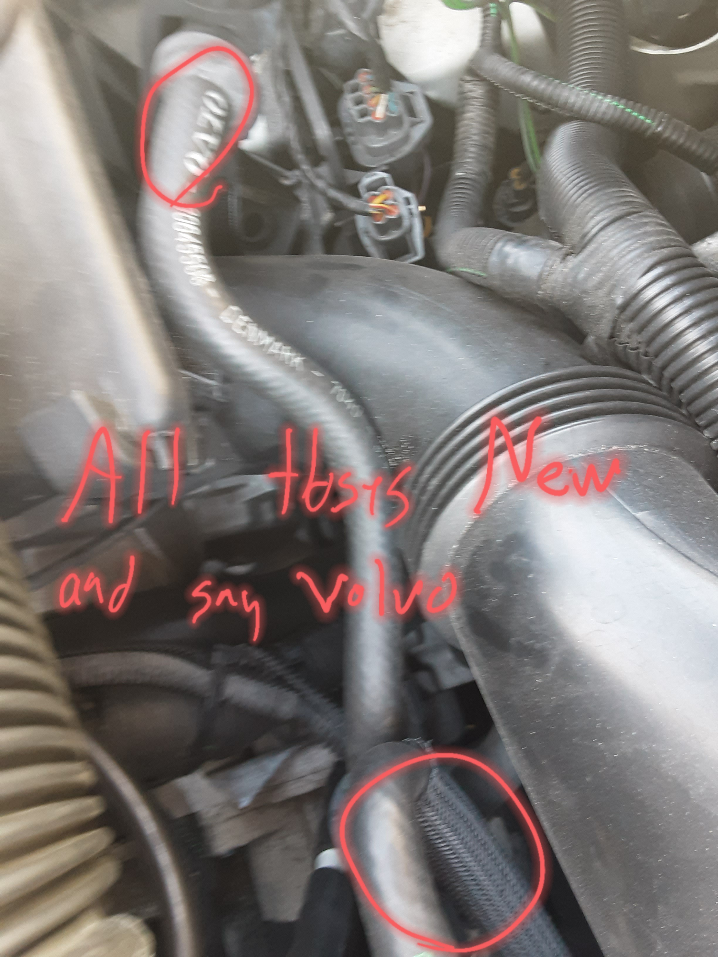

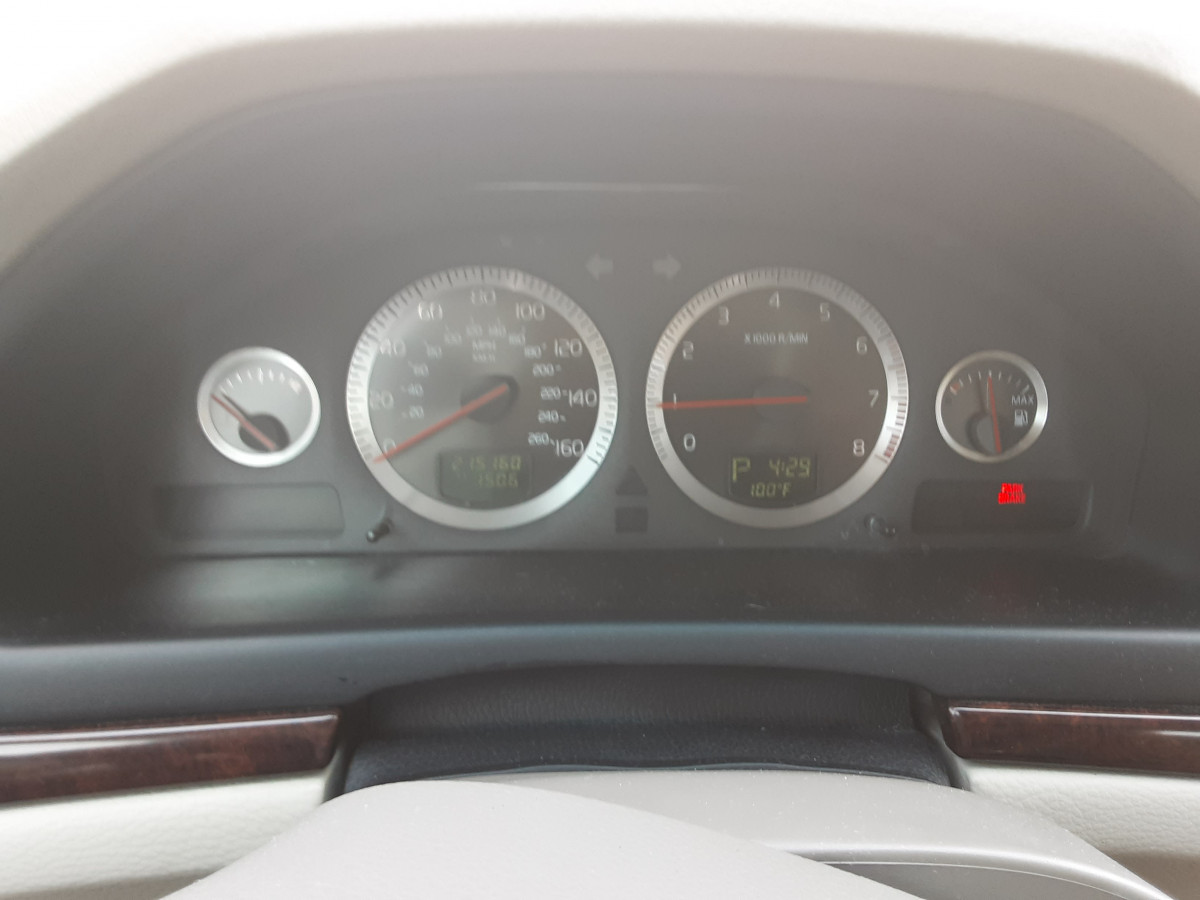

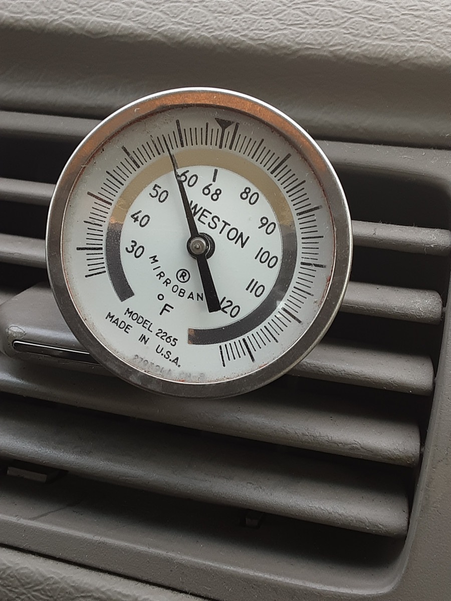

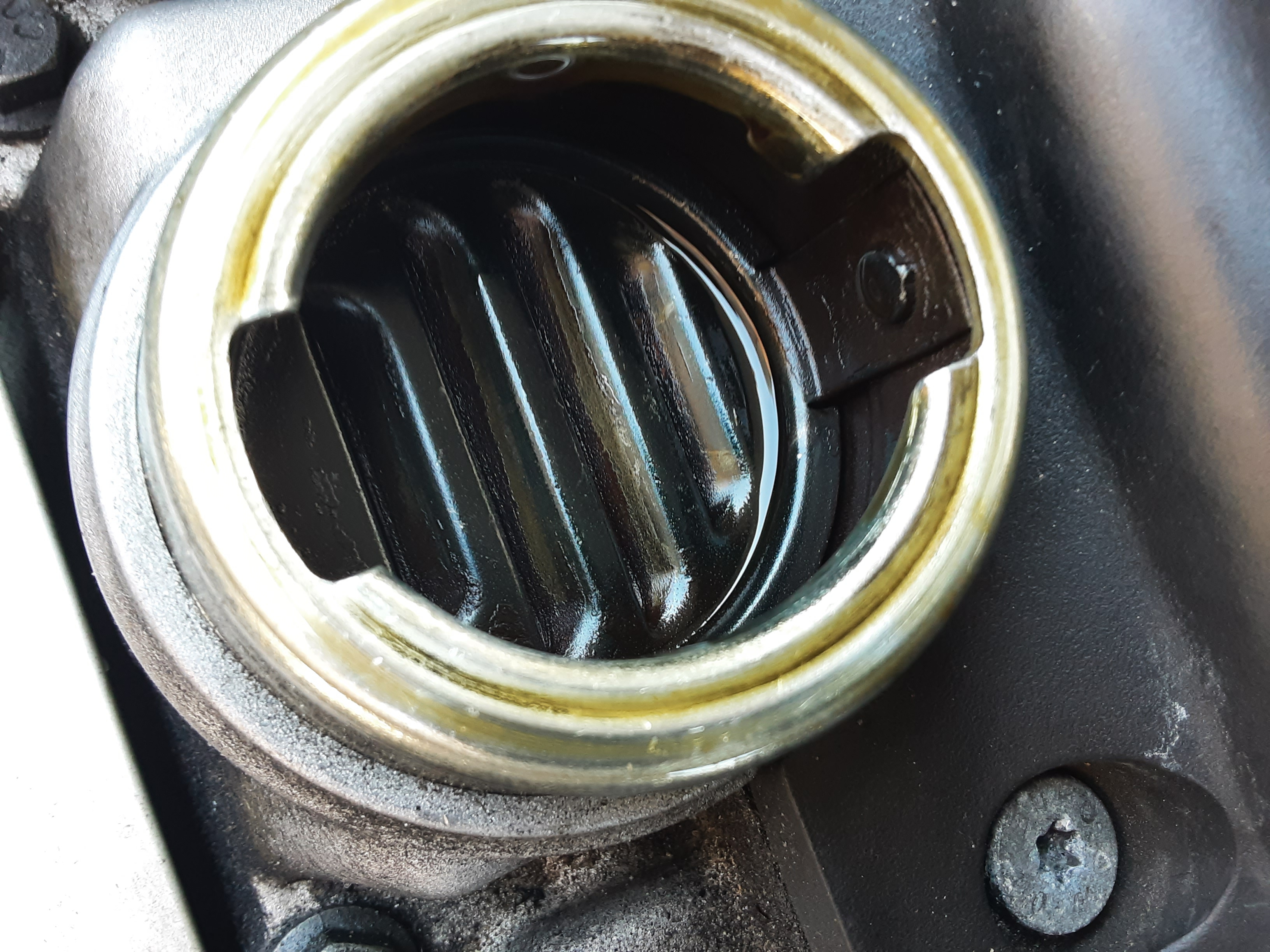

Okay, this is my 2004 S80 T6 always dealer maintained. Engine never washed. In service 12/23/2003 and now 215K. Notice 100°day 6 minutes of idle high fan speed and outside air air vent temp in the 50s. Do check ac tmp. Driving gets to upper 30s. June
