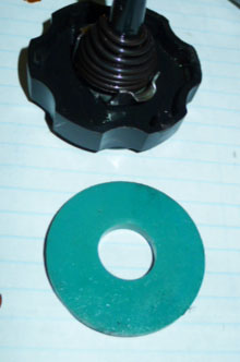

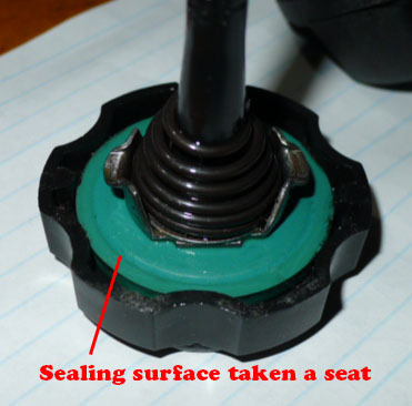

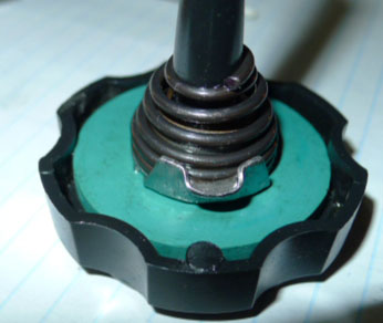

Based on advice from here I was able to fix a leaking PS cap by just flipping around the sealing washer so the other side is used as a sealing surface.
Just used some pliers to take the old one out, takes a lot of stretching & fiddling to get it back in, I used small flat screwdrivers to help get it in each side.
Power Steering Fluid Cap
Washer out
Washer out
Done!
Done!

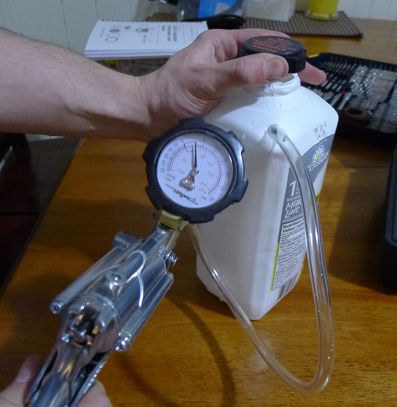

That didn't completely fix my problem, so my 2nd attempt (before replacing it) was to test/adjust pressure relief, as perhaps too high a pressure was forcing liquid past the top.
I built a "test jig" from a milk carton which fit the cap OK & pump. Fill the milk jug mostly with water so you have a smaller area to pressurize. Only hold the cap by the sides, don't press on the top because you'll interact with the relief valve:
Test Jig
Test Jig
I didn't see what pressure it opened at, as I thought my simple milk jug might burst :) I went up to about 8 psi before giving up. I have no idea what the correct pressure is, but the only references I could find to similar valves was about 5 psi.

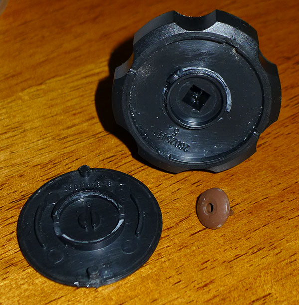

I pried the cap apart, there is just a little rubber (the brown part) gasket thingy that forms a one-way / pressure relief valve. It is held down by the top part of the cap which is glued on (you'll break the cap when you pry the top off, so need glue to put it back together):
Cap taken apart
Cap taken apart
I washed that part, and sanded down slightly the top part that presses into the brown gasket to reduce how tightly it is held in. After this the valve opened around ~4 PSI. Installed and so far no sign of leaking! Hope this helps someone.
Would be interesting if someone with a new cap could test to see the "proper" setting for the relief valve.
