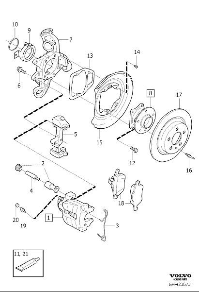

the rear wheel bearing and hub is held by 4 bolts, then theres the knuckle, I don't remember how thats attached.
Once the bearing is out theres nothing much holding the axle, it can probably stay.
One of the bolts holding the wheel bearing hub is captive, it can stay put,
remove the other 3, I think it was a 17 mm offset box end wrench.
on this drawing, I think you need part #7 ?
volvo knuckle.jpg (42.15 KiB) Viewed 1171 times

Herb Goltz wrote: 21 Sep 2021, 21:28I see that there is a repair bit to replace the broken hub assembly-- has anyone used these with success? This is a German site, does anyone know a North American source?
I think it may be quicker to fabricate something similar. But in any case, that approach looks workable.
Herb Goltz wrote: 21 Sep 2021, 21:28I am considering having a look at the local pick-and-pull for a backing plate and some hardware bits. Does the axle have to come out to swap out the backing plate?
No. I don't think even the wheel hub needs to come off. Here I don't see any interference between the plate and the hub (marks of hub).

I have removed a lot of captive brake plates by snipping the “ thin bit” to allow them to be bent off. I don’t even reattach the cut, the bolts hold them fine
You could use a bit of flashing and pop rivet a repair piece , too.
