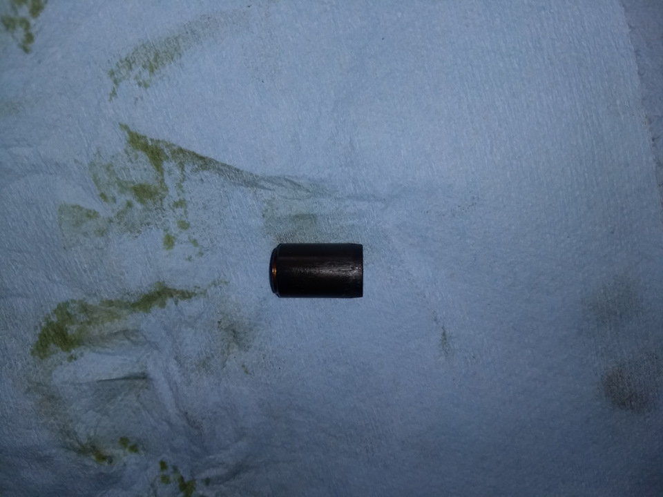

Post by vtl »
By-pass valve freezes sometimes in a partially opened position. That happens when the oil pump picks up a dirt from sump, the oil pressure is too high and the valves opens briefly to release it. The dirt does not have enough time to travel all through the valve and gets trapped between the valve's cap and the bore.
Here's the scratch(es) I found on the valve cap in my oil pump w/ 220k miles:
