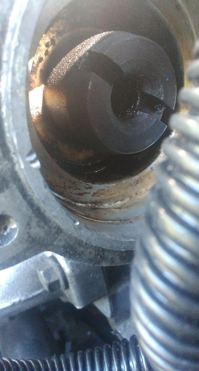

So I finally got around to replacing my exhaust cam seals... I popped off my frontward black dust cap (fortunately bought a new one, had to mangle it), and discovered this:

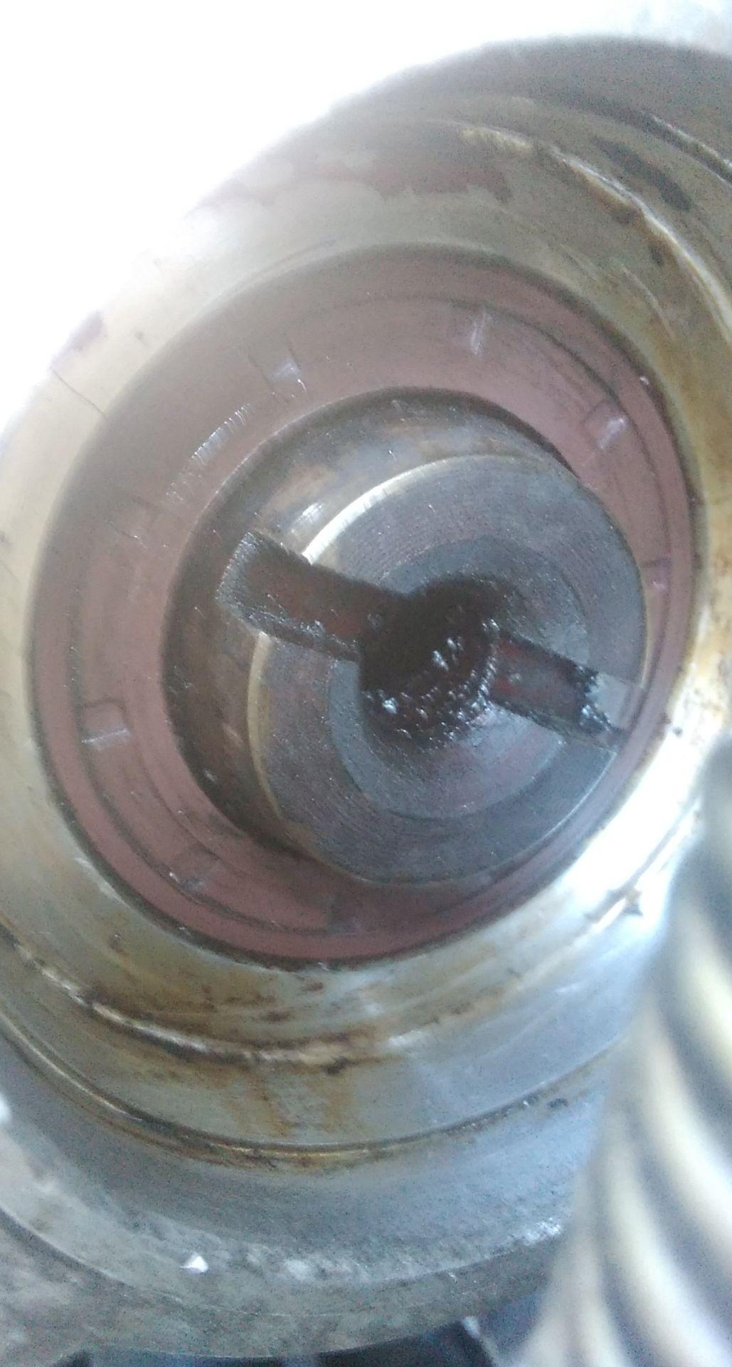

I'll give everyone a second to digest that before moving on to the next photo that demonstrates how the cam looked after correcting the issue...
First off, this is obviously a huge contributor to my oil leak. After driving for about a week since then, if my oil level is moving, it's extremely minimal.
To dive into the logic of the previous owner; I presume he removed the cam seal in order to forego PCV replacement, while negating the possibility of blowing a main seal. I want to say, bless him for this! Yet at the same time, if he simply told me he did this it would have saved me a stupid amount of money I've poured into oil, not to mention stress of driving a dry engine. My bad for not doing cam seals sooner? Hrumph.
So this solves my oil leak for now, woo! But the anomaly to this, the reason I'm posting it in this thread of mine, is that my crankcase fumes seem to have dissipated! And again, they would start funneling out within 30 seconds of cranking the engine. The other day, I idled to operating temperature and there was not a single wisp. *knock knock*
