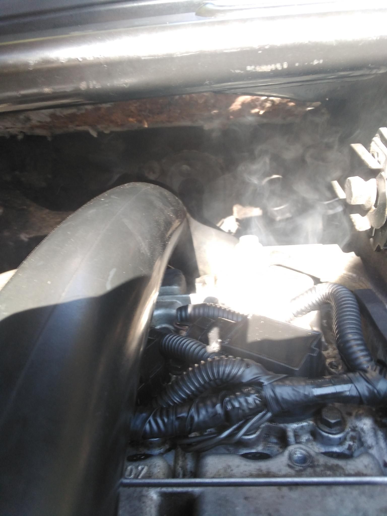

Coincidentally I was just snapping a photo of where it comes up from the hood. You can at least see it's from about where my exhaust seal is located, but almost further toward where the oil return pipe is located.

Remove the heat shield?

vtl wrote: 09 Sep 2021, 13:10 Remove the heat shield?
Thanks, I'll start there to help pinpoint a visual leak. Still praying it's the leaky cam seal, but I won't get my hopes up.
Doesn't smell particularly burnt, my system was just desludged and there's a constant stream of fresh 5w30 being poured into the engine. It's not dense smoke, it's more of a mist like you say.

Post by vtl »
You probably see a crankcase mist leaking out. Not sure how leaky seal can create mist, this is usually a job for rotating crankshaft and bypass gasses. Check out air intake around turbo and PTC nipple.

Post by TisMe »
vtl wrote: 09 Sep 2021, 13:34 You probably see a crankcase mist leaking out. Not sure how leaky seal can create mist, this is usually a job for rotating crankshaft and bypass gasses. Check out air intake around turbo and PTC nipple.
Hmm, thanks again for that golden advice. It definitely appears to be coming from around the PTC nipple, this reminds me that I was looking into the PTC the other week before getting sidetracked by other maintenance. Just very difficult to really see what's going on in there without tearing things apart.
I'd like to dig into the diagnosis right now, but I'm running short on my available time this weekend. Part of why I said I wasn't digging into this today... :lol:
so it might make sense to give that a proper inspection when I have my engine mount removed while replacing my exhaust cam seal. That should really open up the area and give me a real idea of what's going on, and perhaps allowing me to service it at the same time. Woo!

With oil leaks first give the engine a very though cleaning (cold engine) and let dry. start car and look close in suspected area, if nothing seen take car for very short drive.
The rear cam seal is a very common source of leaks, you can usually see the seep trail down the block. Whether thats causing your leak onto the hot exhaust is another question.
I recently installed a junkyard motor that smoked just like your pic, it was because the seller sprayed WD-40 over the entire engine to make it look good in the photo's he sent me. It smoked really bad for about 20-30minutes and was almost convinced of a major problem, only a small amount of oil ont the exhaust can smoke really bad.

agree, oil could be dripping onto the exh manifold or turbo, although oil smoke is bluish and steam is whiter.
Oil drain pipe from the turbo can dump a lot of oil under the car, mine did, it coated the whole underside back to the haldex and got on the exh system , smoked a lot.
I was losing a quart every week or less.
